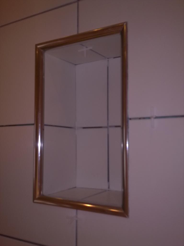

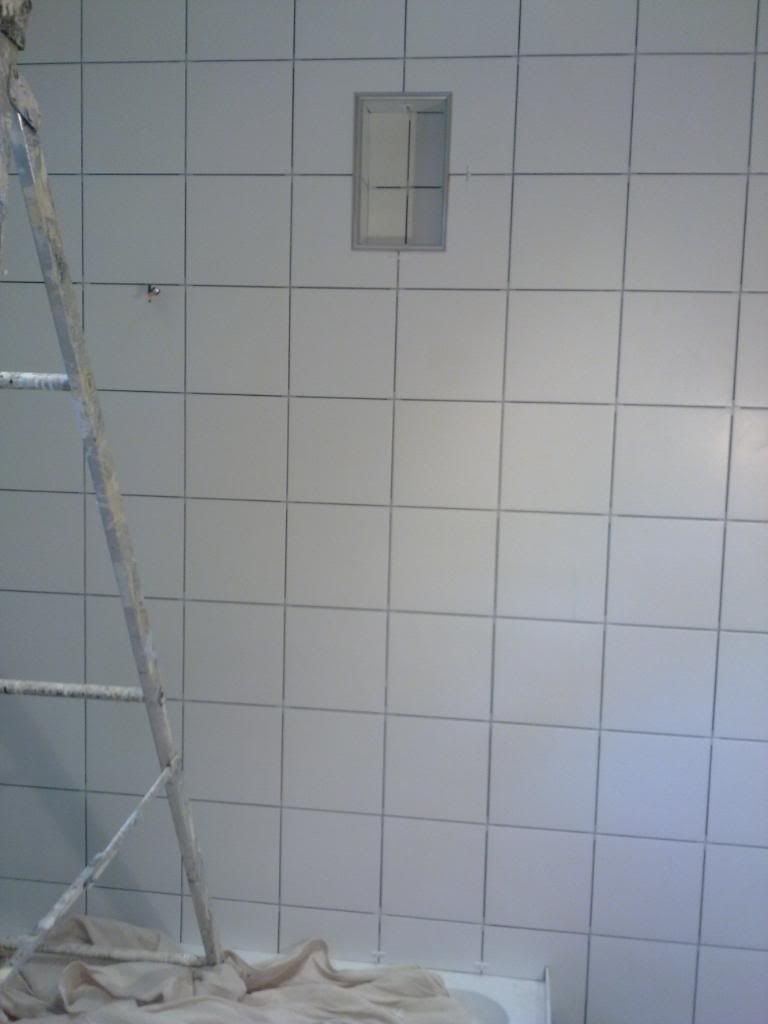

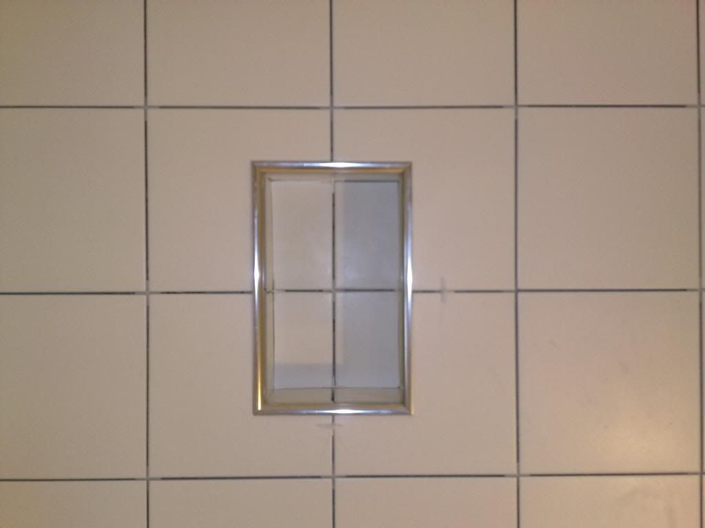

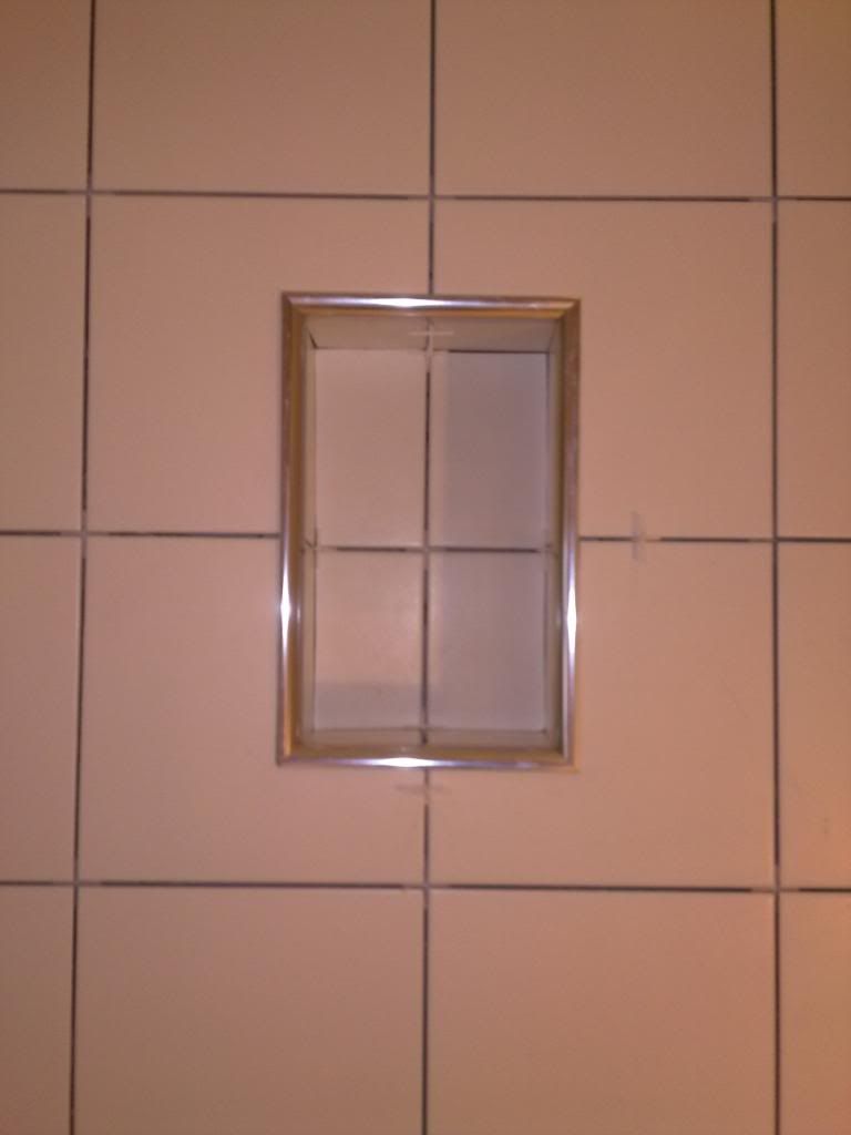

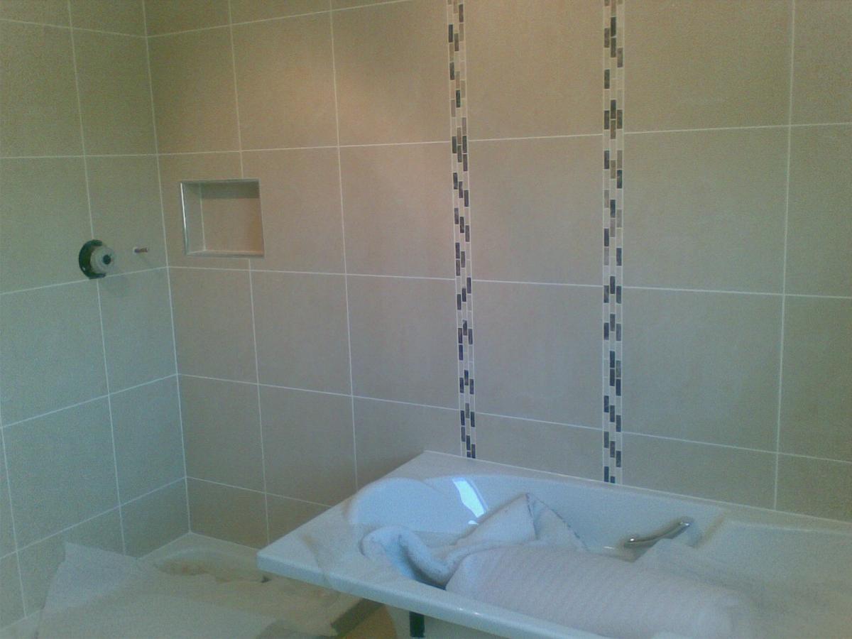

this niche I created just in normal stud wall ( wall is 50x50mm so I added 20mm wedi on top of the plaster so my niche will be 70mm deep), it's plasterboard behind glued screwed wedi board, just cut out where you want niche add more noggins if needed, stick thin wedi to back of the plasterboard inside niche, just don't forget to tape corners and joint inside niche, which i didn't done yet, I'll post this niche when ill go back to finish this jobThese all look great. How would I go about constructing something like that? I'm still fairly new to the tiling game.

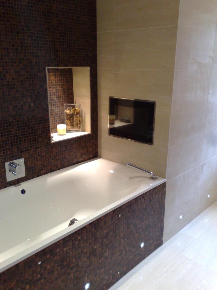

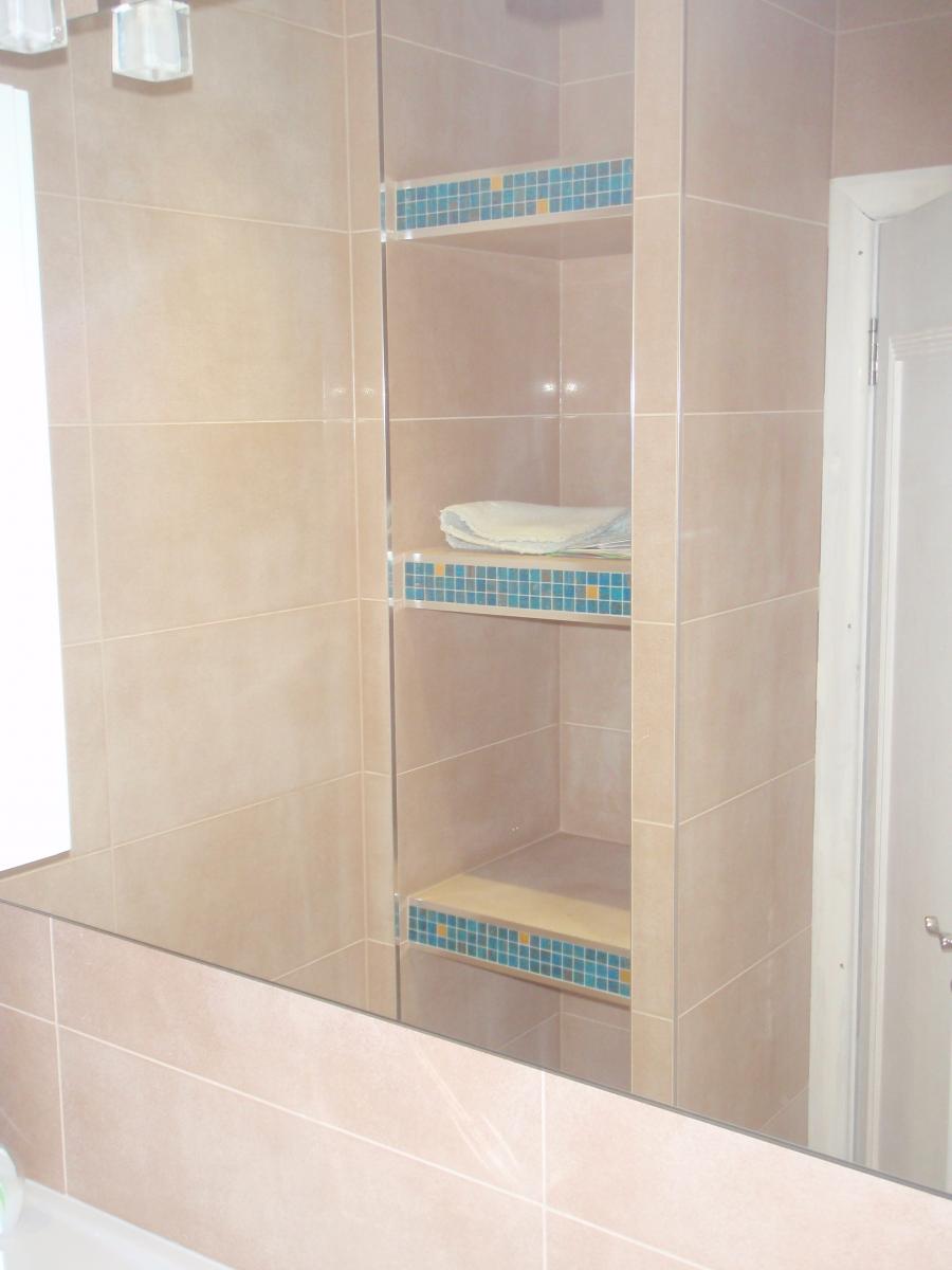

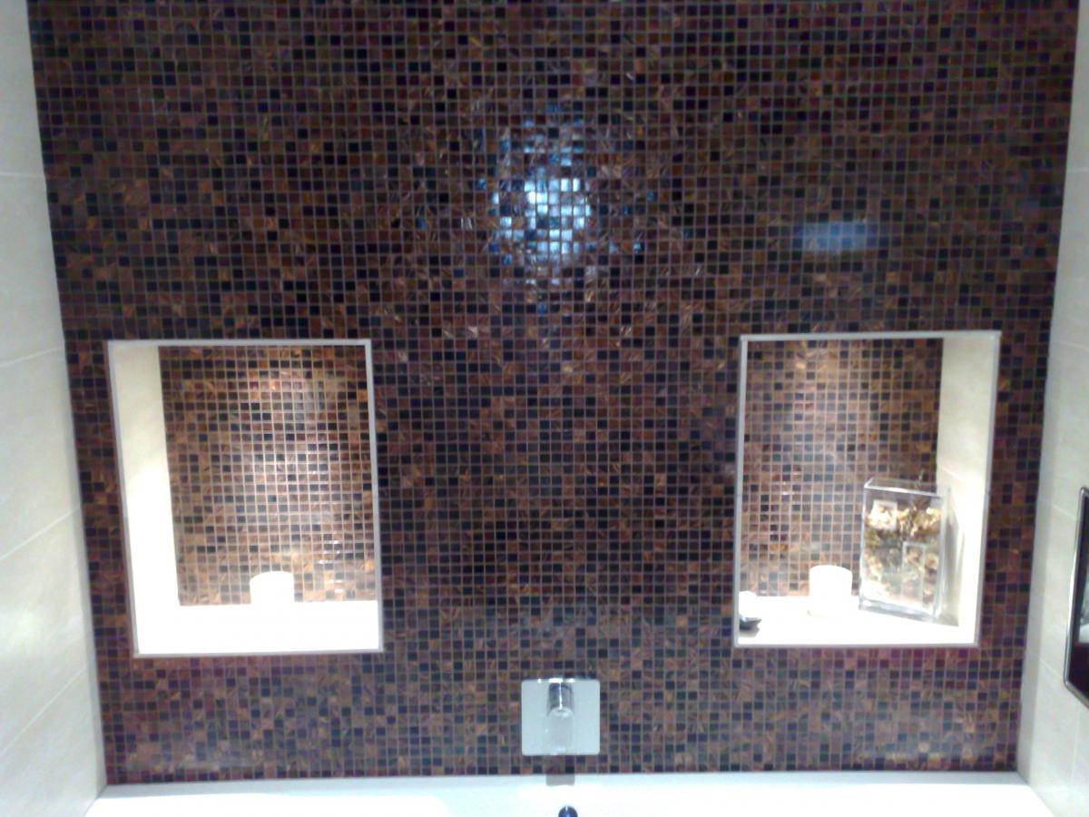

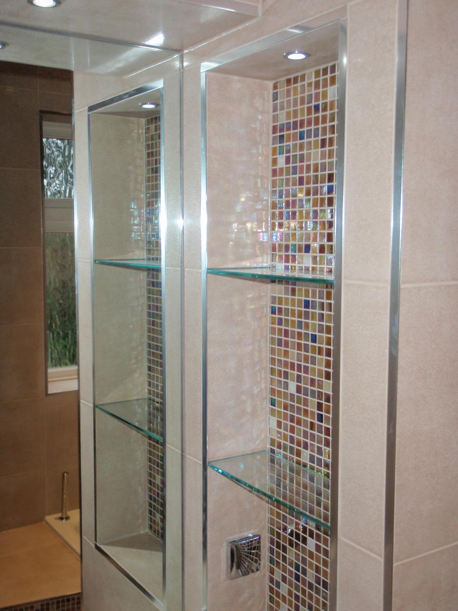

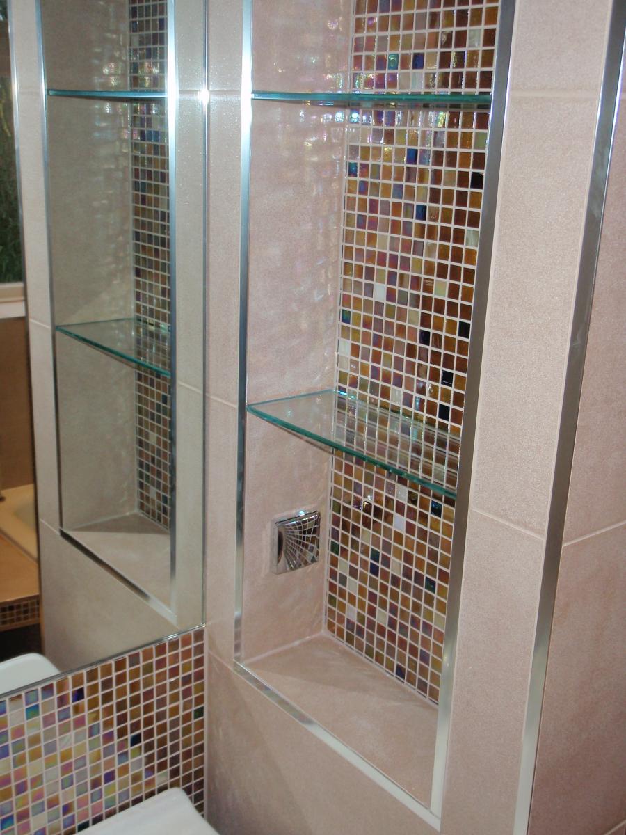

If your showing off with your Niche - I'll show you one of mine !
Glass shelf at 2/3rds hieght - Glass mosaics and porcelain on the wall - customers choice. ! Big bottles on the bottom - small at the top
My one piece of advise to all of you - Always slope the deck of the 'Niche' forward slightly to drain and watch the internal corners - make sure 'no-pooling'
:8:

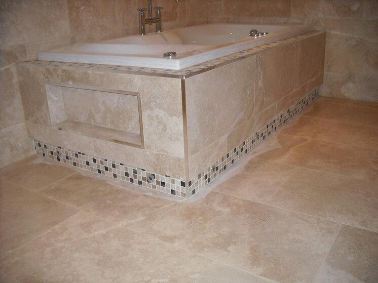

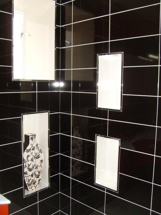

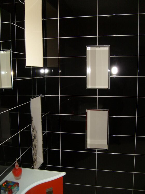

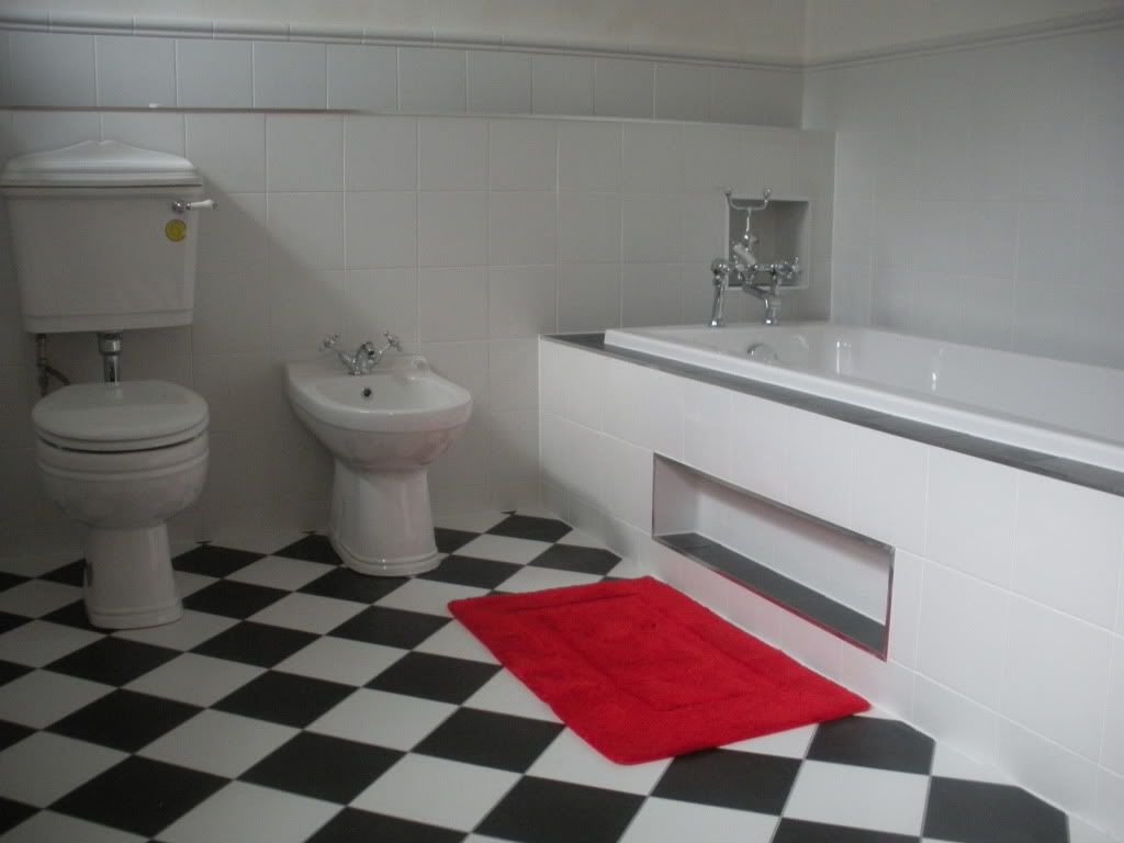

Hi TommyZooom
Is that Travertine you used on the bath panel / top etc ?

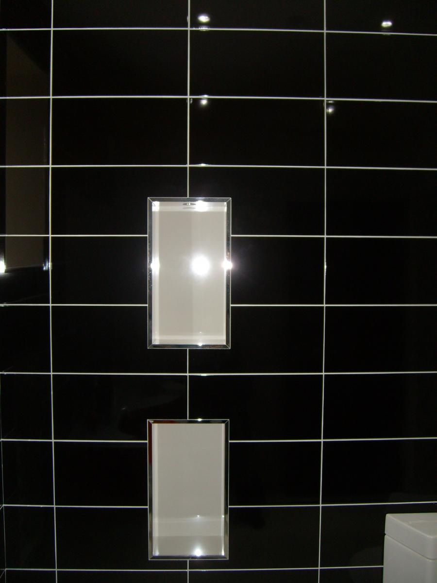

What made you decide to use Aluminium Trim rather than mitre and round-over the corner joints and top edges - Was this decision the customer's own. ?

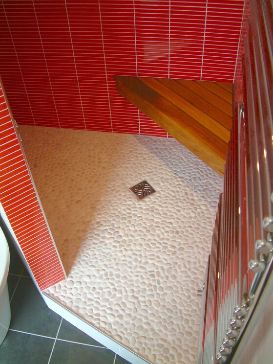

Love the walk in shower - What make was the base and walls - We use a simlar one. Nice
