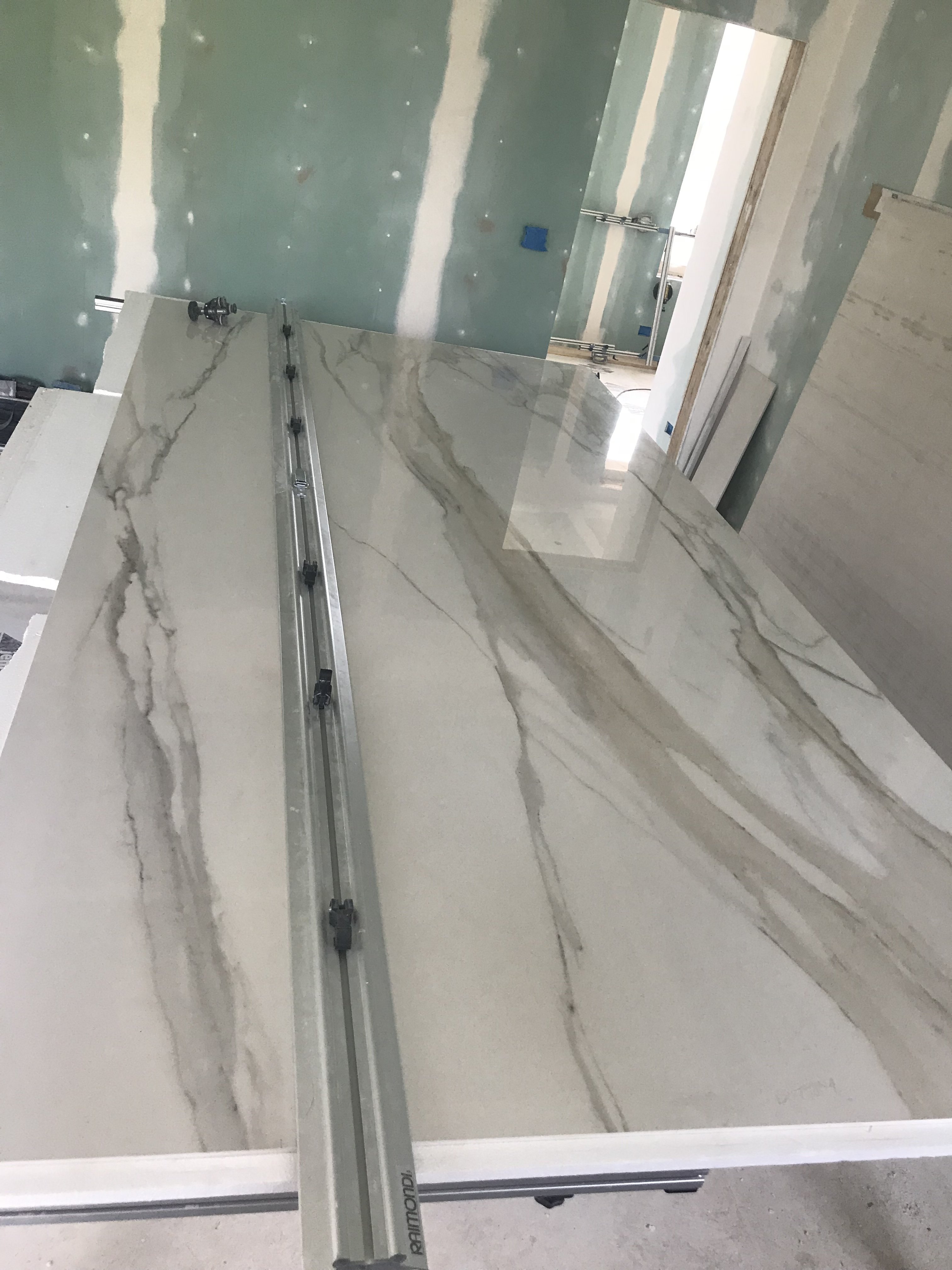

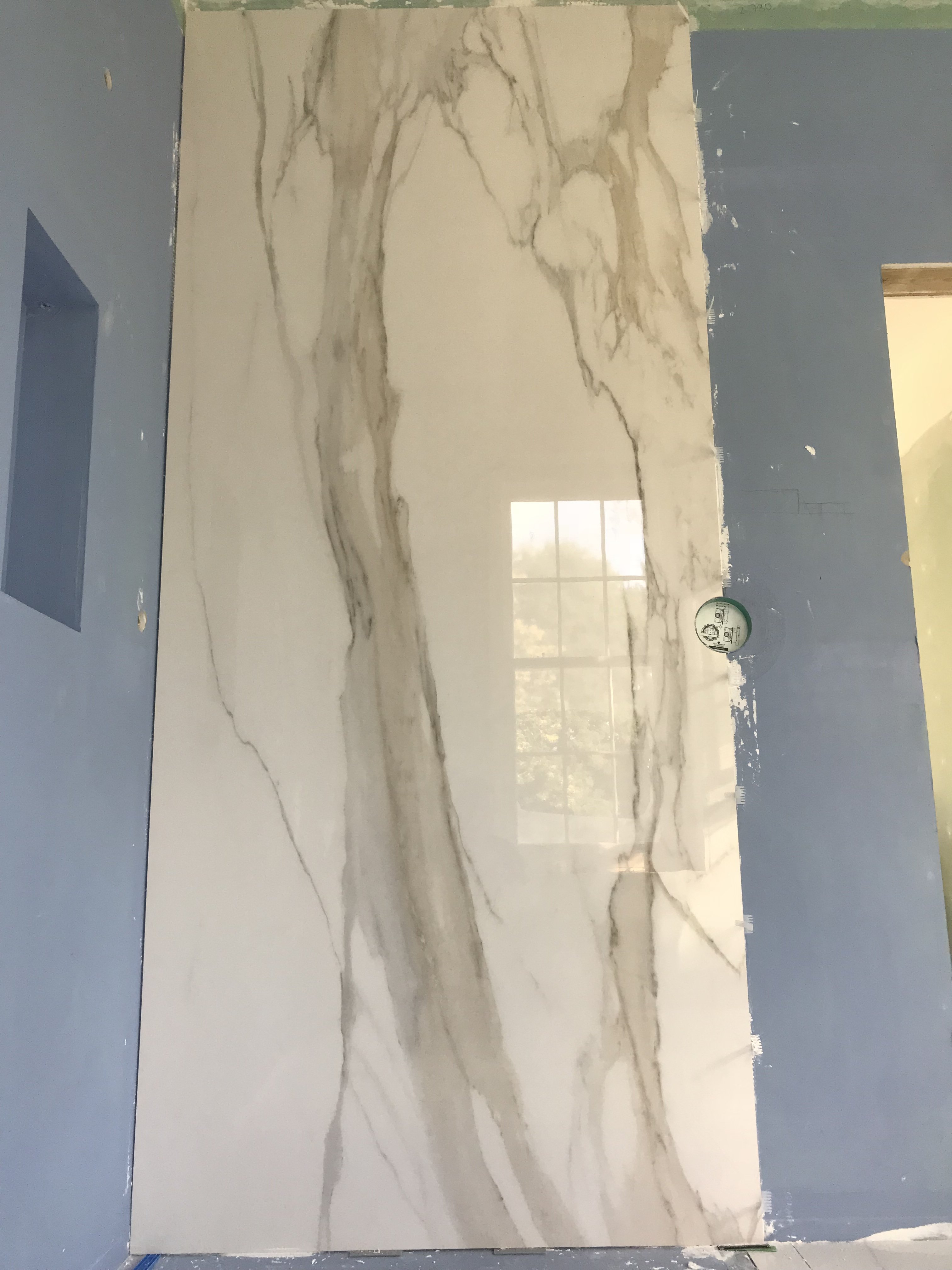

Haha you’re not using the same tile as me are you Mark?
I’m using the Florim Calacatta Gold, 2 sets.
Unfortunately I had to cut a large part of the design off! There’s no internal wrap.
Because I have to have a joint in the centre
Of the diverter.
All the vein on far left of the slab bad to be removed. Easy wrap, crap effect.

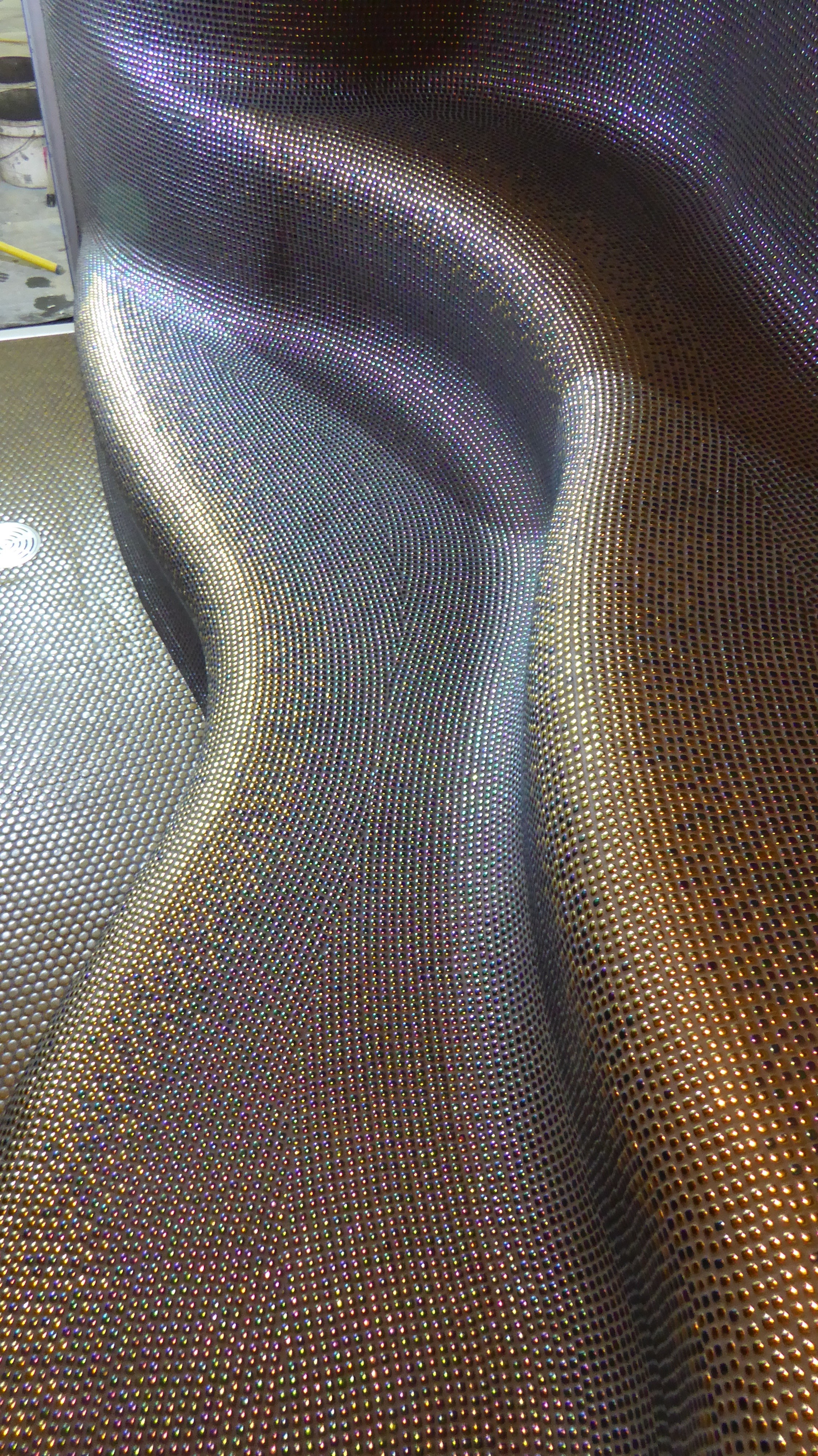

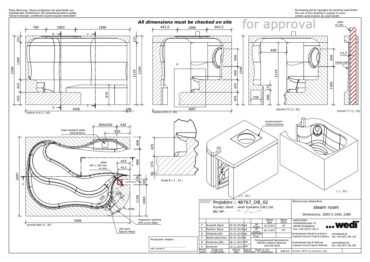

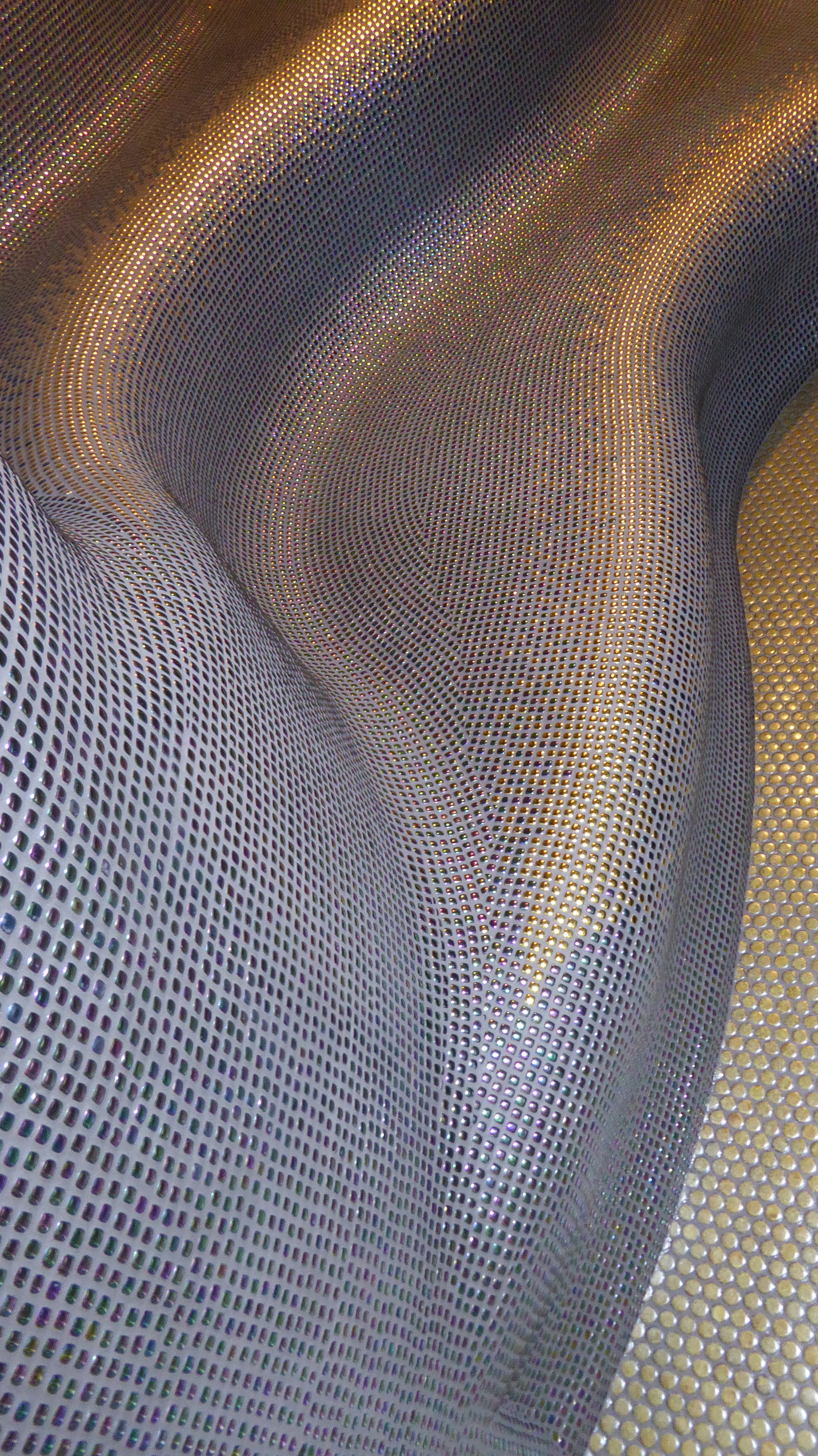

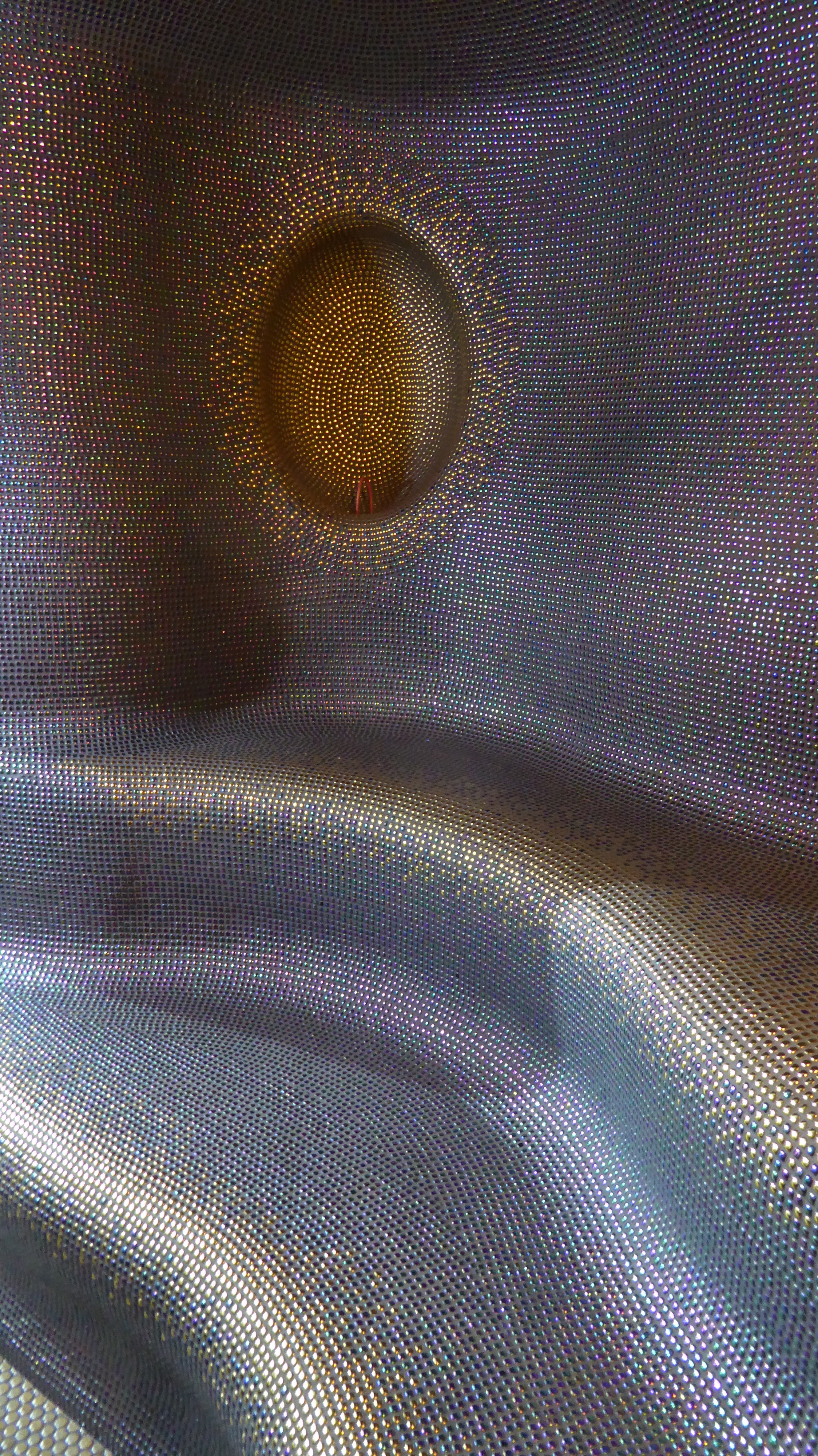

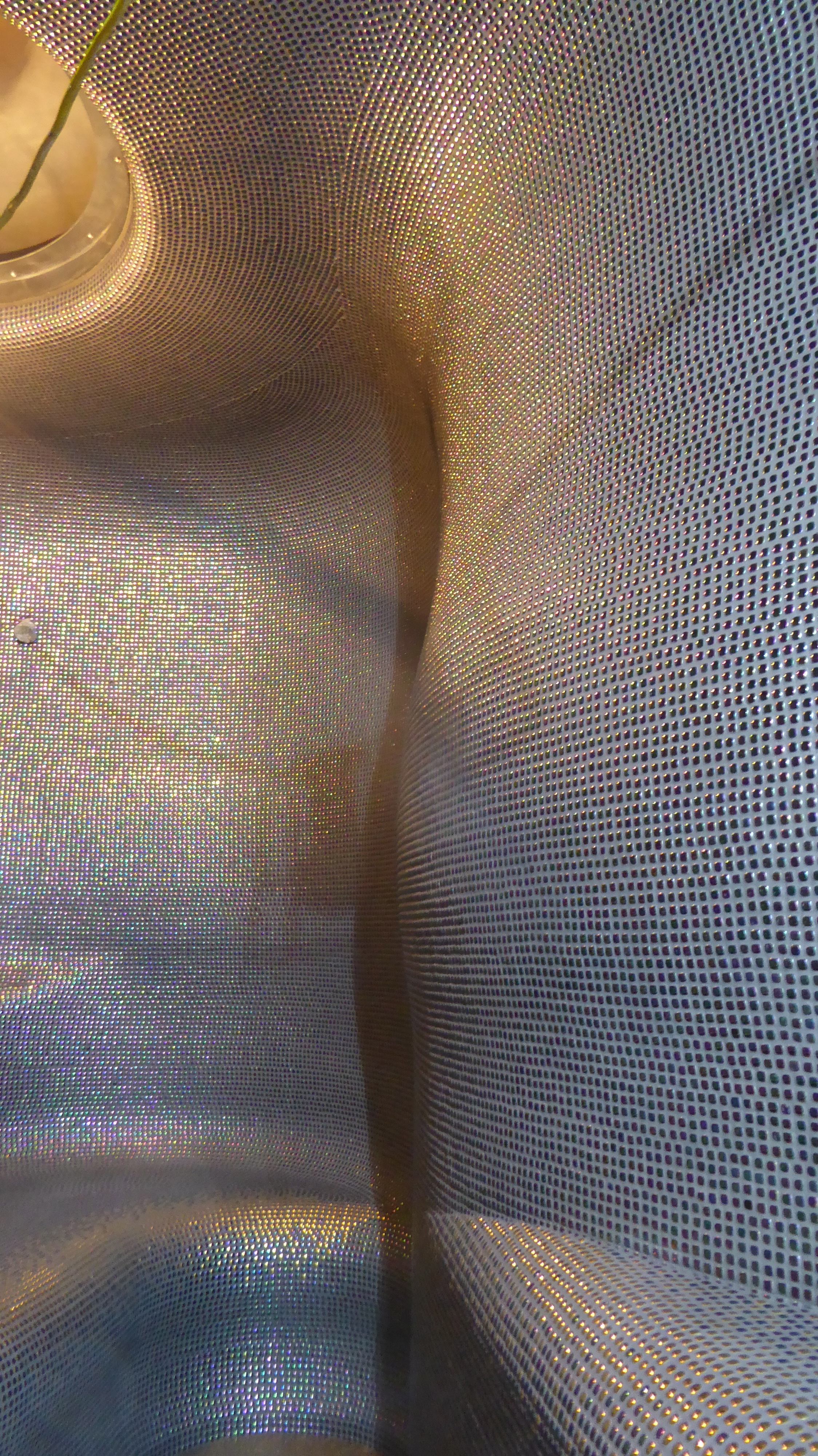

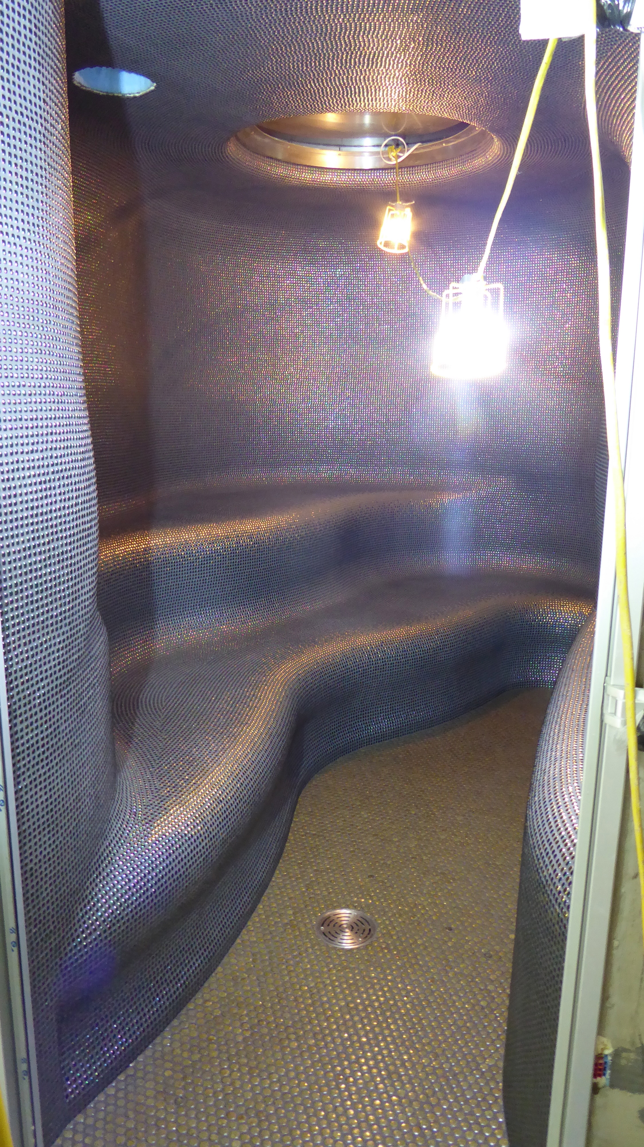

This is a very unique steam room Ive been working on for the past month. Its in a new Wellness Centre and Spa at Broughton Hall in North Yorkshire.
Its made of preformed Wedi, thats then had a resin coat painted on with a bit of sharp sand to give it a 'key'. I used Kerakolls No Limits Bio Gel with their Fugalite Bio epoxy in anthracite. So glad I asked for Kerakolls epoxy as I got through 40 pots. The rounded edged mosaics were a pig to clean and Fugalite made a difficult job easier. The mosaics are 11mm metalic glazed plastic faced ceramics by Botteganove.

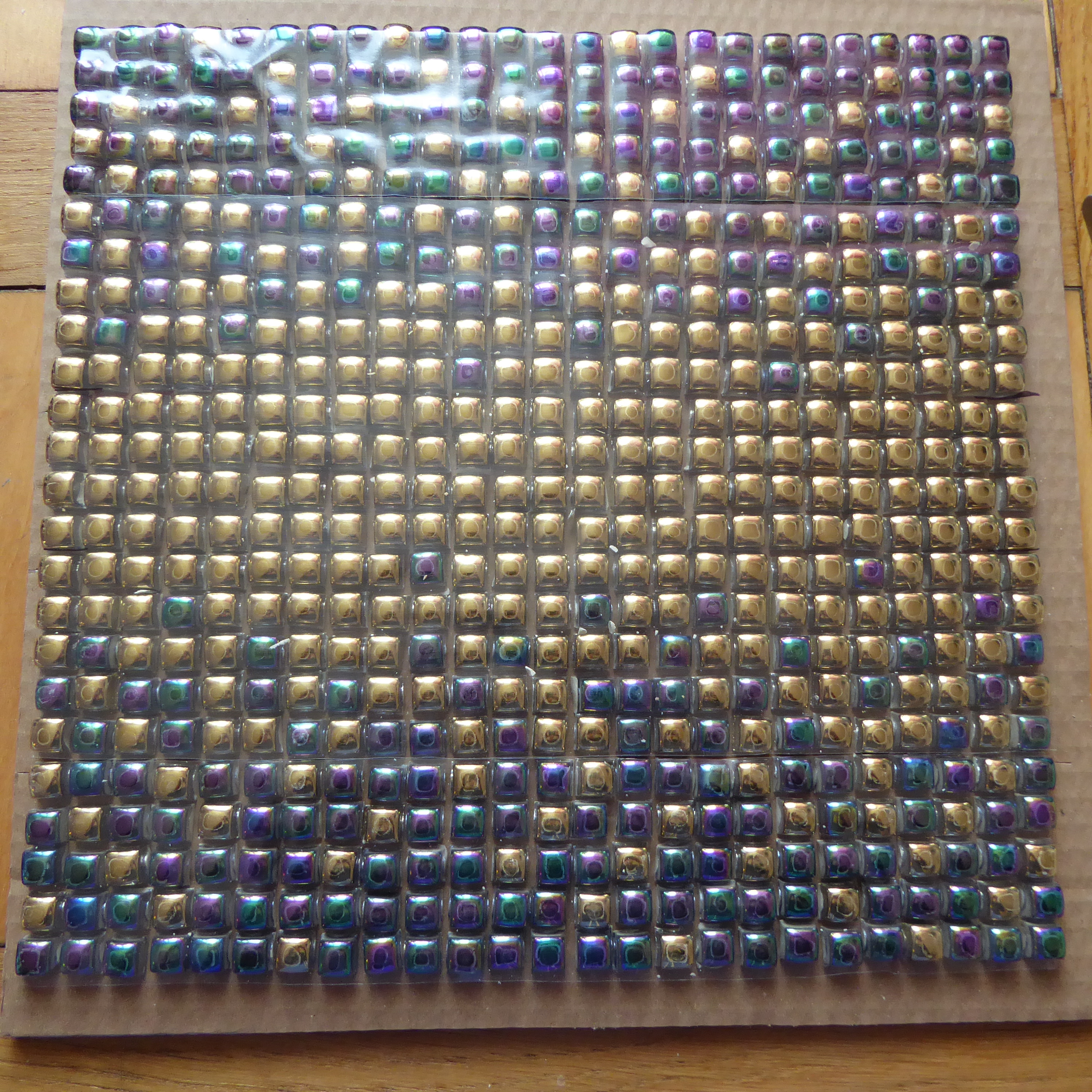

The gold graduated blended sheets I made at home before hand.
The room was designed by Milk Leisure Ltd. Lights and steam outlet etc still to be fitted.
