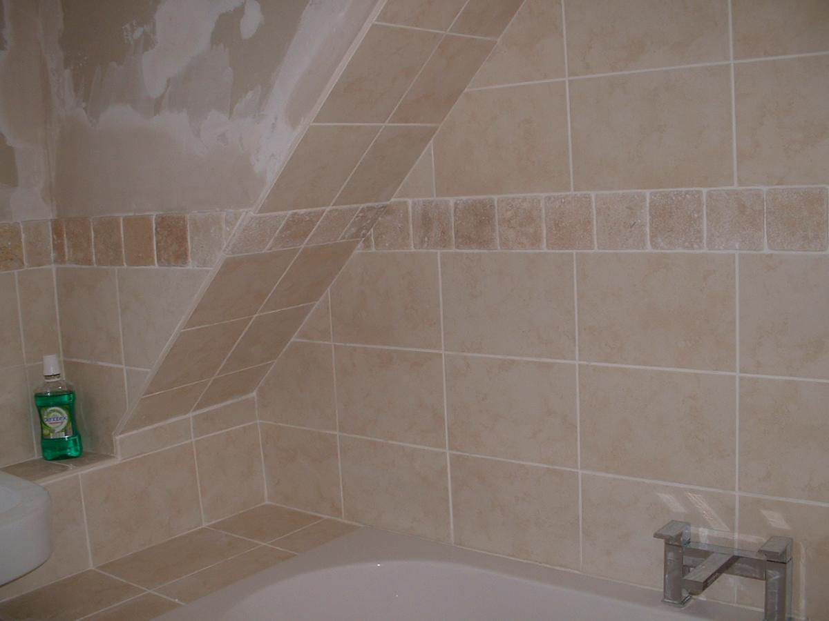

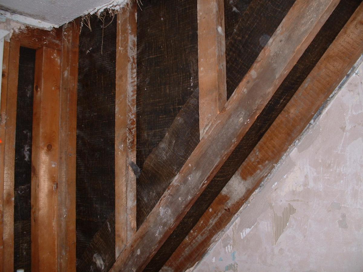

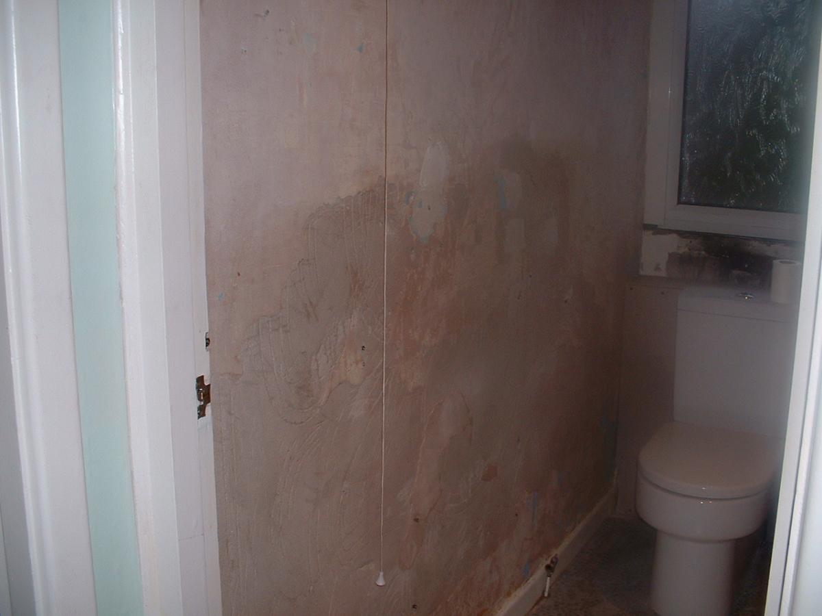

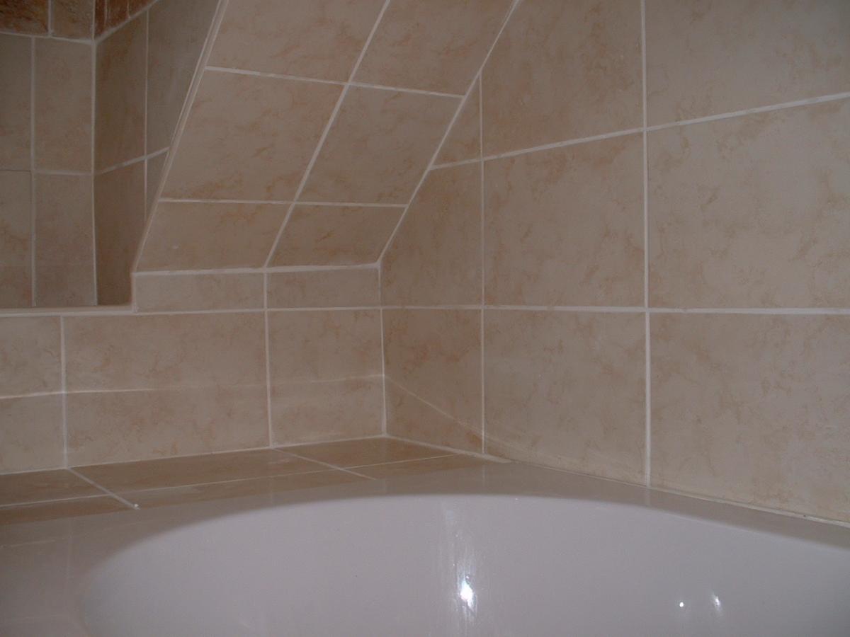

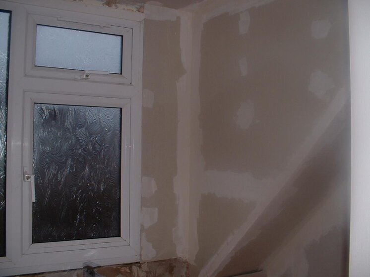

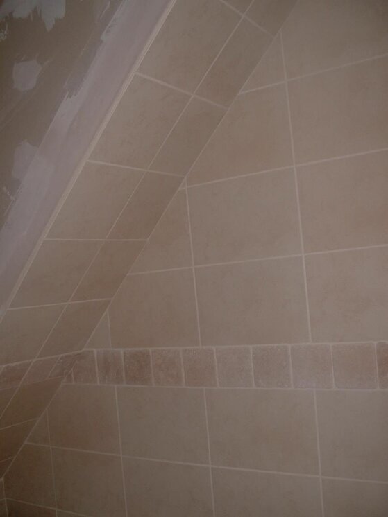

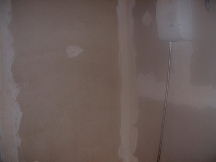

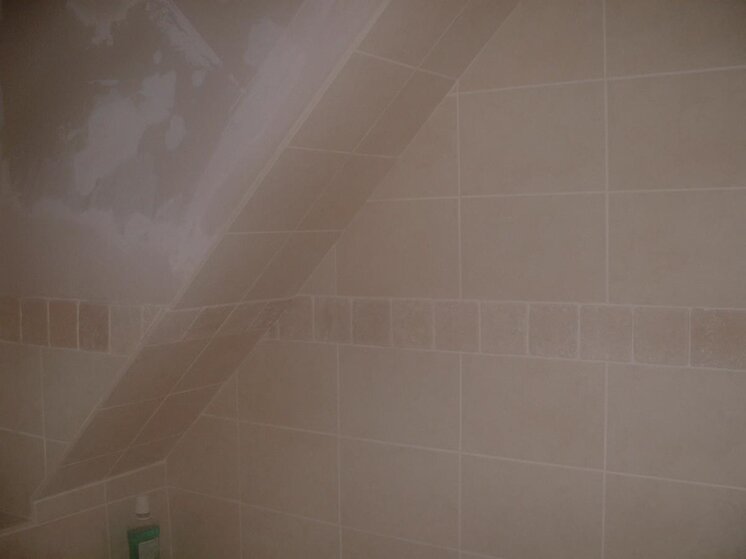

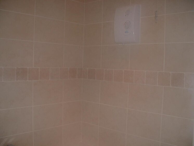

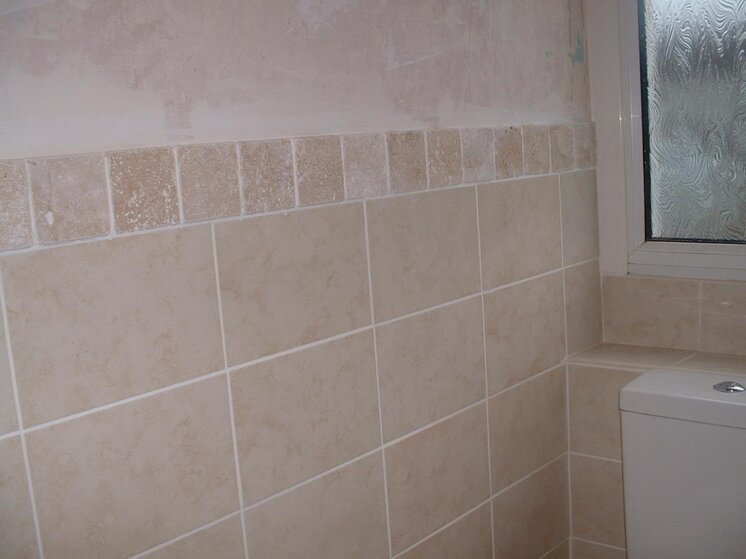

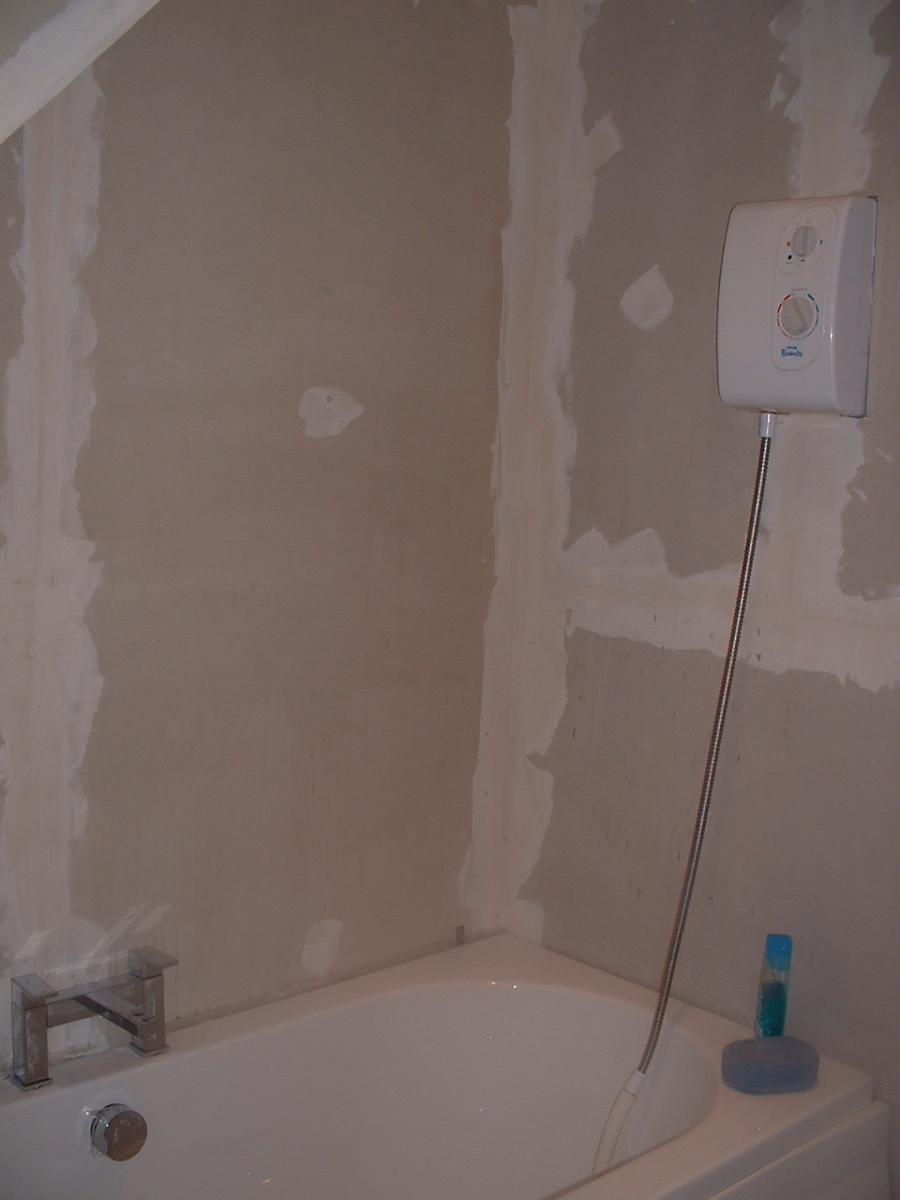

My first bathroom which I had to plasterboard the walls and ceiling.then tile.
Any comments on the setting out and the fixing would be appreciated. All comments taken on board so any criticism is welcome as well.

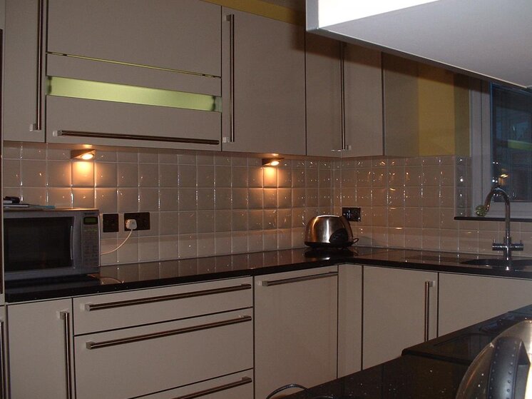

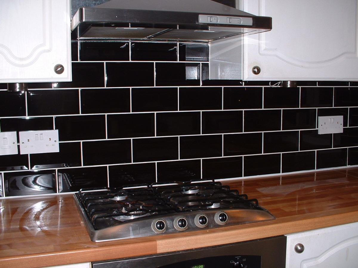

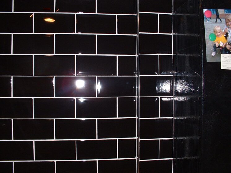

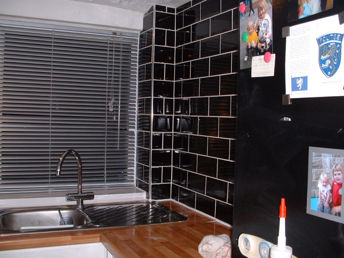

My first two kitchens

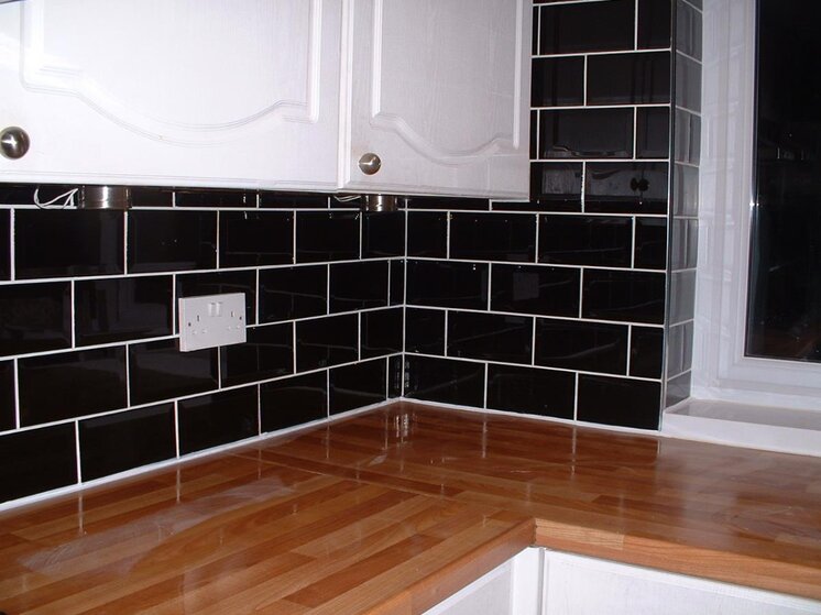

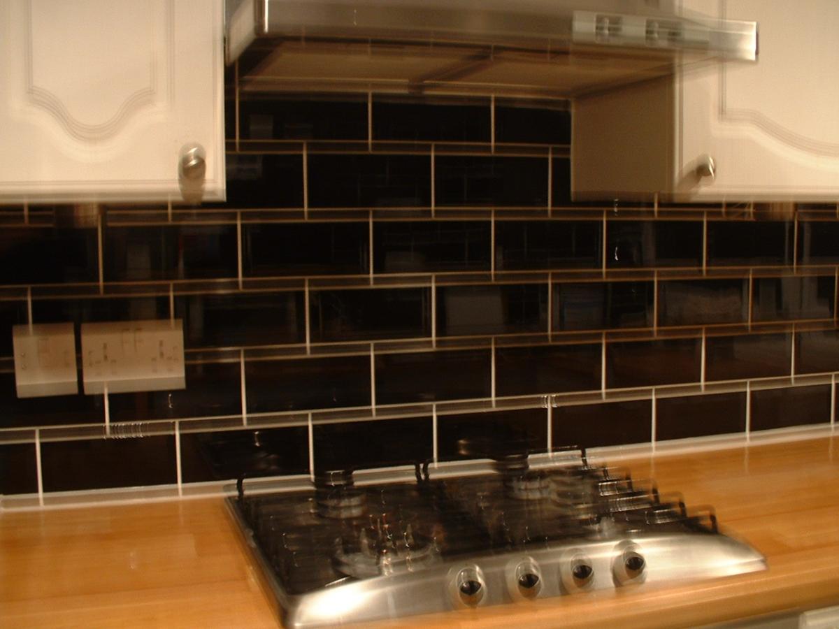

Lose the first photo, its blurred. Whats with the enormous joint around the worktops ? Also you need to Silicon your internal angles.
Hi
Yes I had to go round the unit instead of going behind it due to the water supply pipe not allowing the unit to come forward.
Thanks for looking
Thanks again and again for the advice. Sorry it took a while to reply but I have only just worked out how to find my post

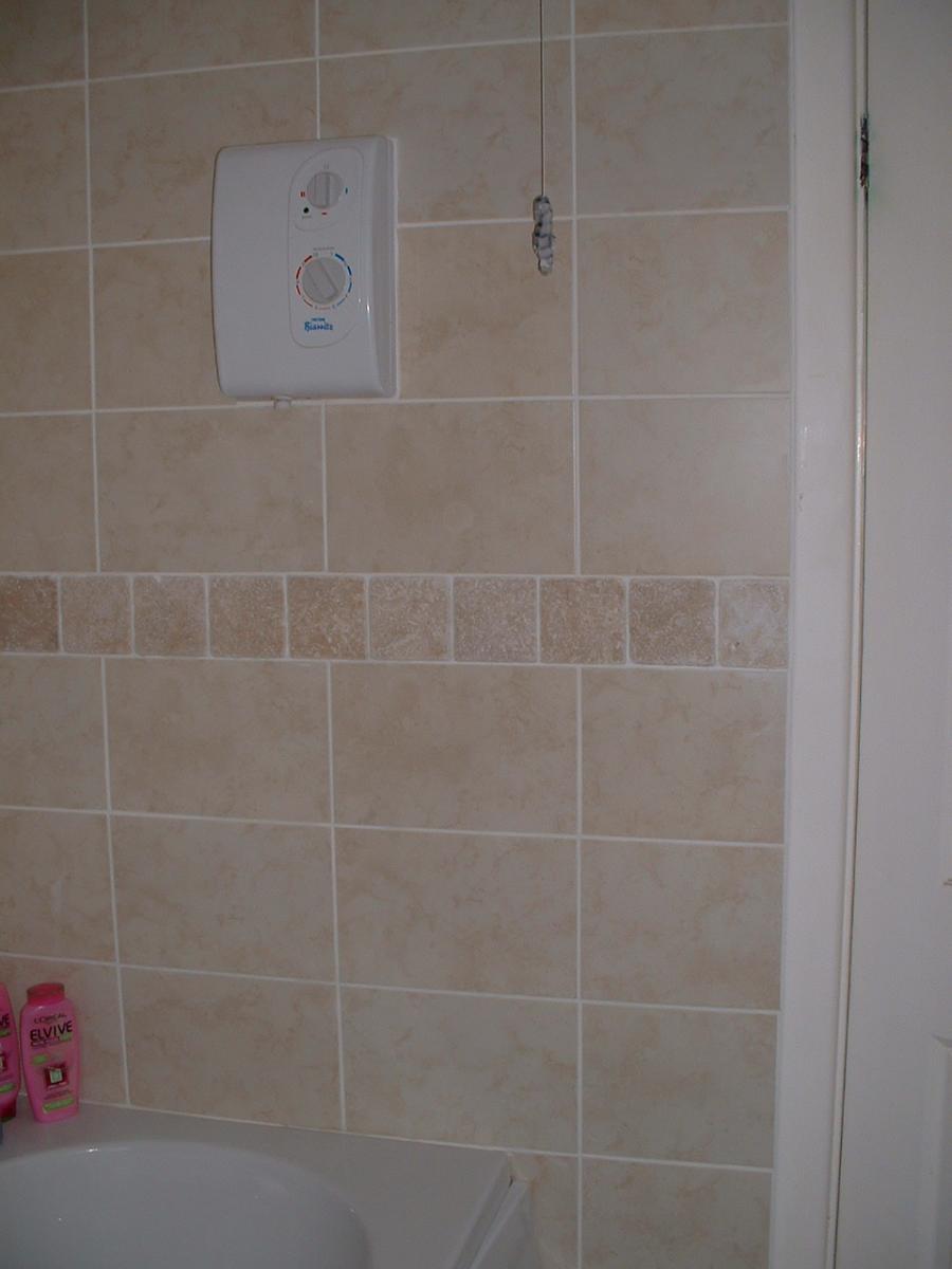

nice work but first thing i noticed was the shower been tiled round. they don't last long and it looks a big unit, there'll be a big gap there when a new smaller one is fitted in a year or two. also it looks a lot better if you go round a corner with a size of a full tile, i.e. half one side half the other or 3/4 and a 1/4. not slating you mate, just constructive critisism like you asked.
Thanks mike.
I will remember that info. The shower unit water feed pipe was too short to bring the unit away from the wall, hence the reason I cut round it. I will bare it in mind on my next bathroom . Thanks for taking the time to comment cheers paul

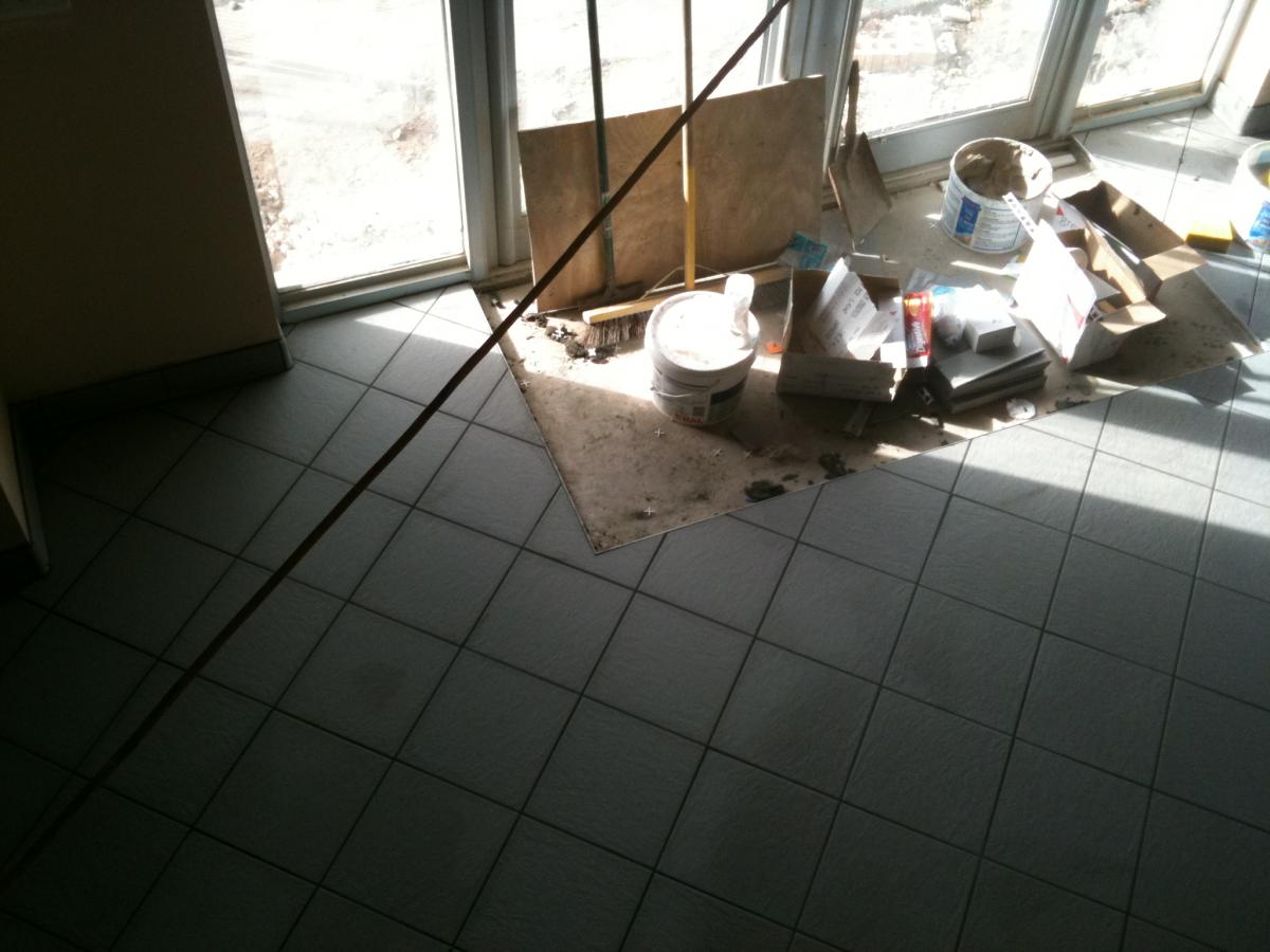

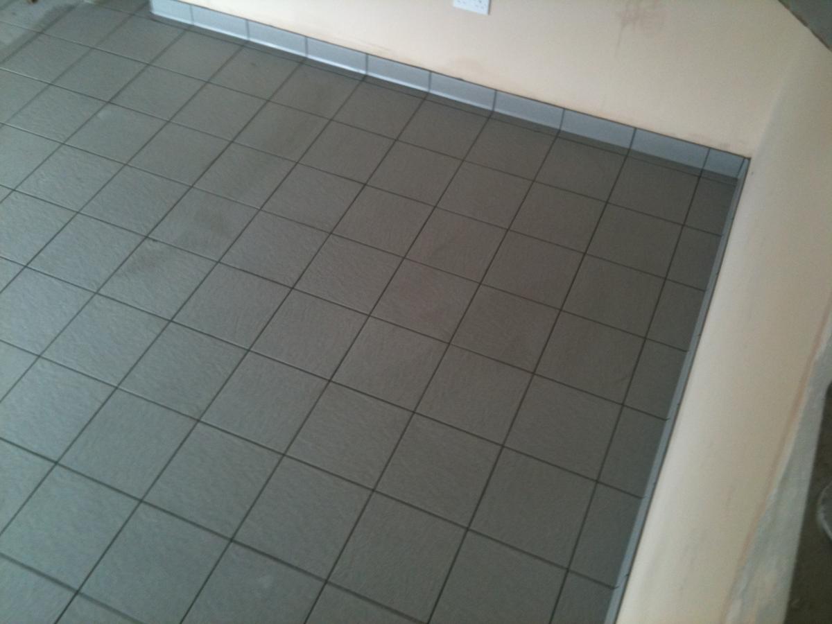

main entrance floor glanford park. scun-thorpe utd
