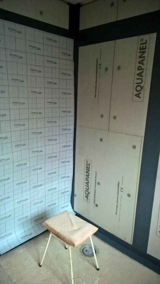

Started fitting the plasterboard and aquapanels to the walls at the . Didn't quite manage to finish but there's not much more to do really. I think I did my dots a bit big though so the boards are further away from the wall than I'd imagined. On the plus side I'll save a bit of money on the tiles as I now have a considerably smaller room! 😳 I didn't think through what I'd do at the door architrave either. Do you have any hints on the best way to build them out?
Also, what mechanical fixings do you use with the aquapanels? I tried hammer in fixings but they went through the panel! I don't fancy the idea of a panel full of tiles falling off but leaving the fixing in place!

Hi. I should have finished boarding the walls by this weekend and be ready to apply the Waterguard membrane. I must admit that I didn't enjoy working with the Aquapanels. Some of them were a bit warped which made levelling them a bit tricky. Plus I dot and dabbed them one evening with a view to mechanically fixing them the next evening. However, they fell off the wall during the night so, lesson learned there. I also should have marked more accurately where the adhesive dots were to make it easier to decide where to put the fixings.
Should I bother taping the joints of either the plasterboard or aquapanels? The aquapanels will be mostly covered by the Watergaurd tanking membrane as I've got enough to cover the floor and well up the walls in the showering area. Is there anything I need to consider before applying the Waterguard.

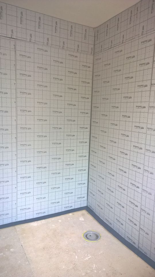

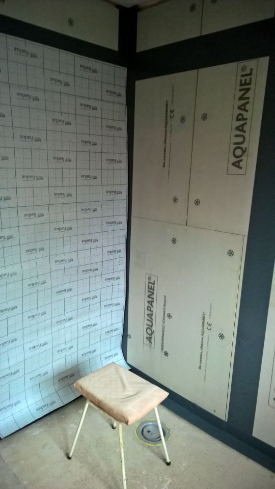

I've now almost finished tanking the walls of the shower area (pics attached). Just need to apply the butyl beading to the joints. The Waterguard membrane was really easy to apply once I got the hang of it. I found the best way to install it was to stick the top bit on first and then gradually peel off the backing a bit at a time and smooth as you go. Super simple even for me. Annoyingly though I miscalculated what I needed and have ended up 1.8 metres shy of what I need to complete the floor so if anyone's got any offcuts they'd sell me I'd appreciate it rather than buying a whole 5m length. 🙂 I tried Impey but they haven't got any spare unfortunately.
One other thing I want to check with you is that, as the floor to ceiling height is a bit more than 2400 I've got a gap at the top of the plasterboard that's up to 4cm at the most. Should I try to fill that before I tile or can I just fill it with tile adhesive when I get there do you reckon?
Steve
