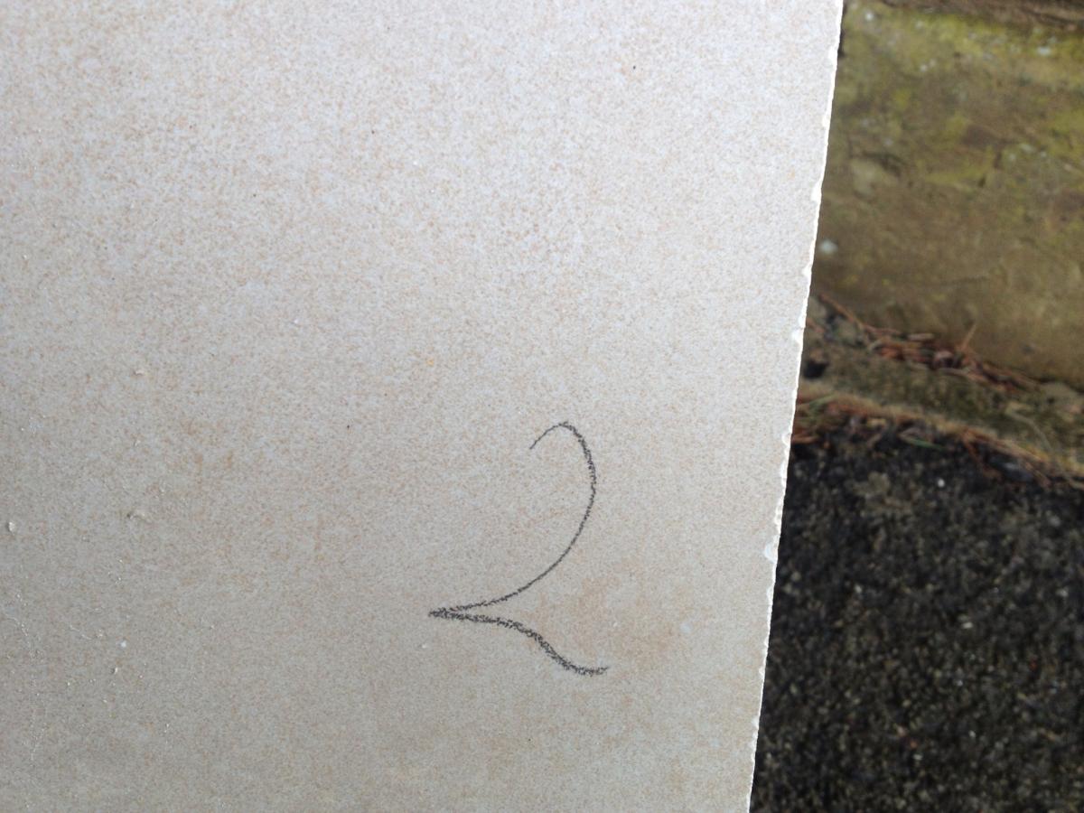

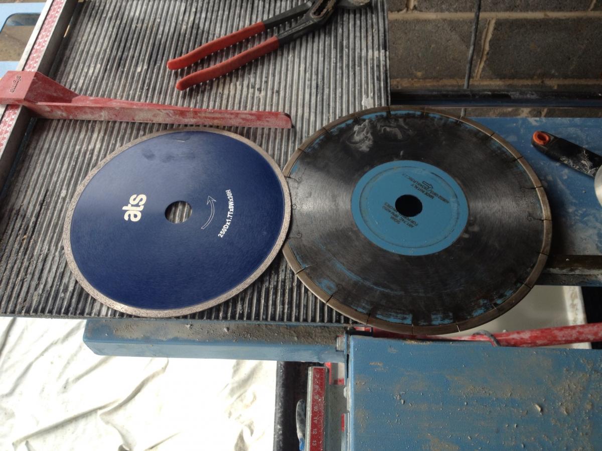

Was shocked at the price of a replacement blade for my sigma 10 m9. So rang Alan at ats. They don't make a 300mm porcelain blade yet, but do a 250mm with the correct hole size. Thought I would give it a try as the standard blade is rubbish on porc.
Pleased with the results so far and the blade is getting better with every cut. The only downsides with using the smaller blade is seeing it under the splash guard and having to run deeper water in the tray.
number one is the ats blade after running through vileroy & boch porcelain.
Number two is the standard blade, this has never been good but put it down to the blade been under mounted. (Over mount dewalt leaves a better finish.

To be fair to the Sigma blade - I don't think it's designed for porcelain, they do offer a 300mm continuous rim Porcelain Gres blade.
Your Sigma blade pictured above is segmented and in a dense product like porcelain, that's always going to chip no matter how good the quality.
