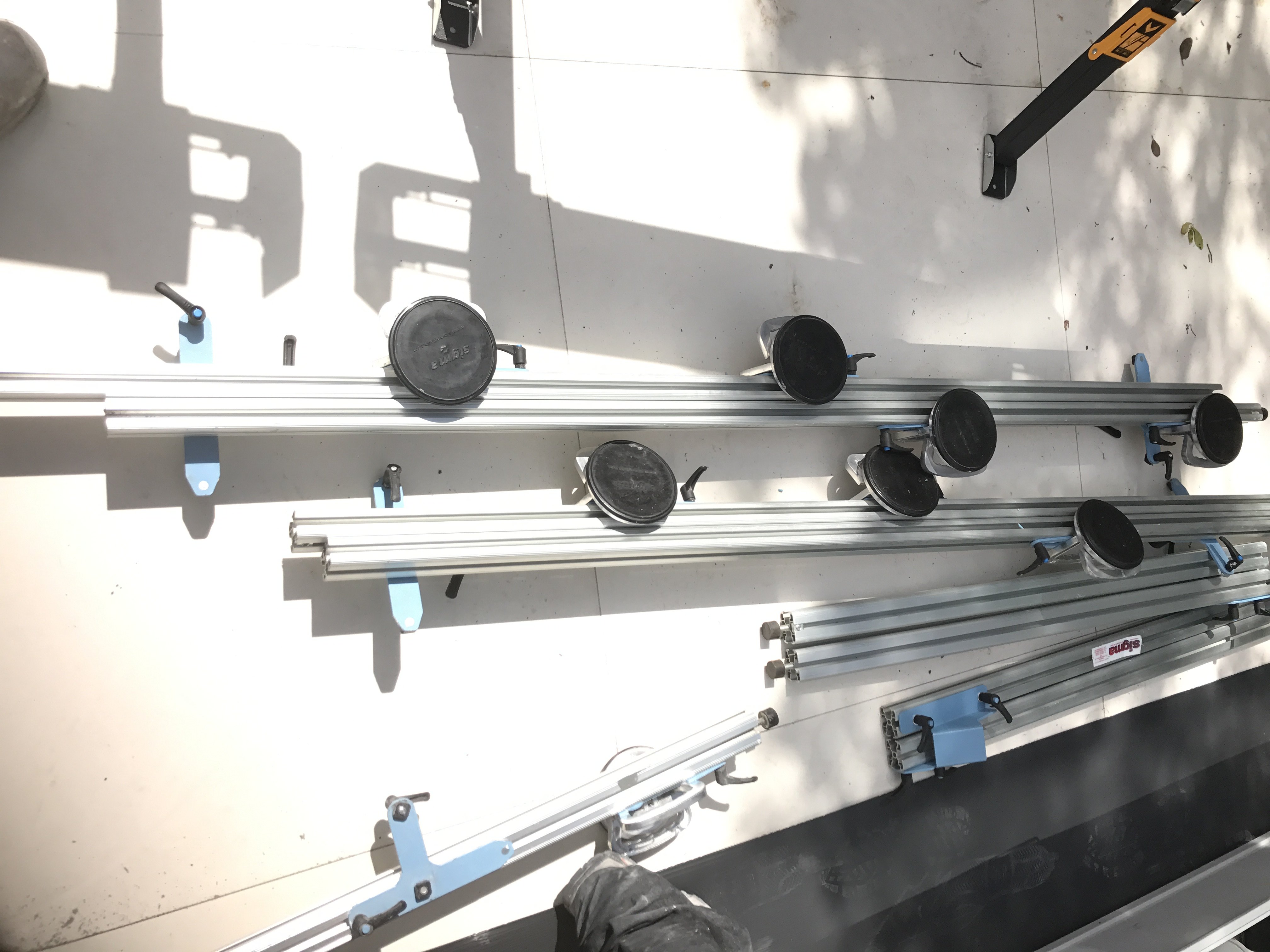

So after spending the day with Derek @Sigma UK
Using the full Kera Lift system, I decided sooner or later I'd obtain one.
Couple weeks ago someone I knew wanted to sell his, and not usually being the type to buy new tools, I thought I'd take a punt this time around.

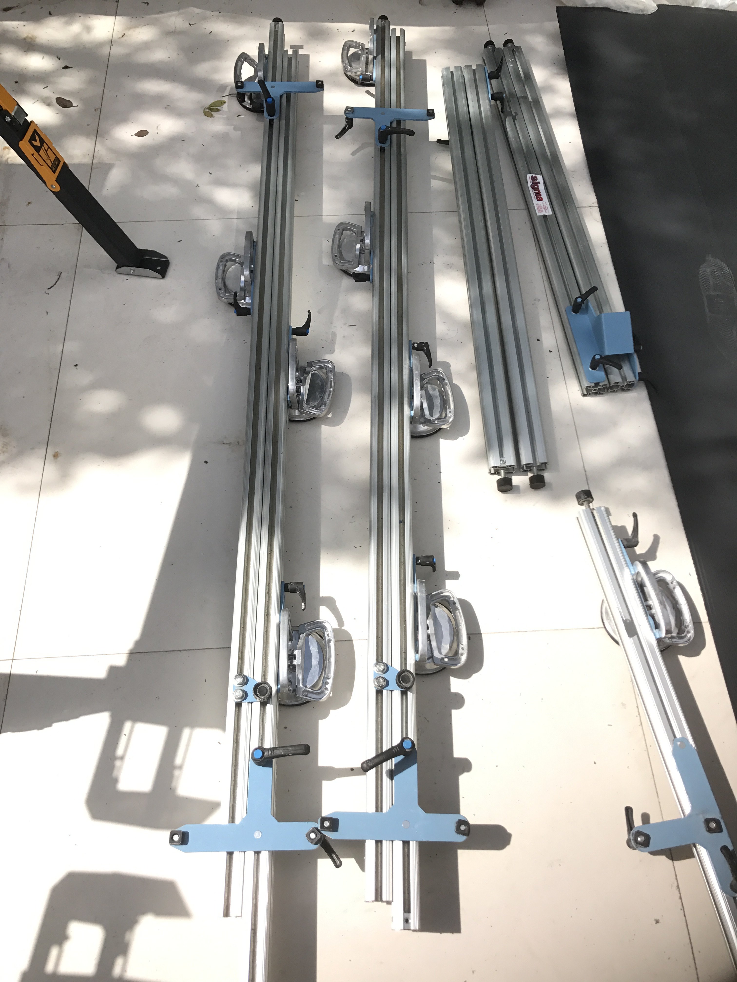

Coming at under 20Kgs, the Kera Lift is the lightest extra large format lifting system out there.
With the Montolit 'Stick' at 35Kgs ish and he Raimondi at a mere 60Kgs!!
It has a built in stand, unlike the others, and to be honest as lifting systems go, it's bloody marvellous.
I've that incredibly helpful man Derek to thank for giving me the opportunity to test before I buy.
If only that service was more freely available!
Imagine how much money we'd save on bloody useless or unsuitable tools.

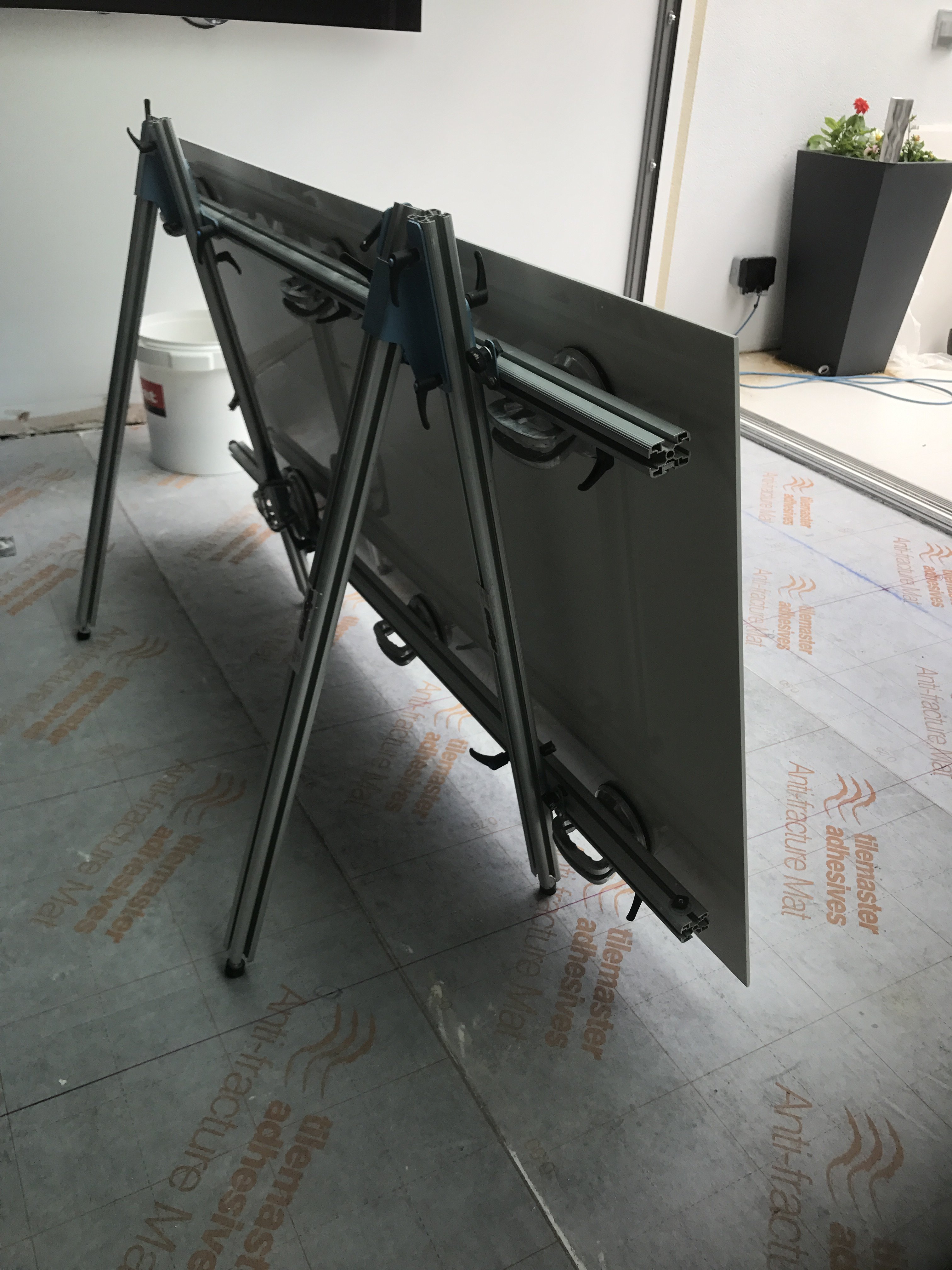

The Kera Lift is very versatile and can be used in many different configurations.
And with the built in stand option and wheels it's a mobile bench for back buttering too.
They're an investment for sure, but I can see them holding their money pretty well too, cos there's not a lot of alternative ways of handing these large sheets, especially if you've taken a great big piece out of it. Haha they stabilise the cut piece and hold it firm until its fitted.

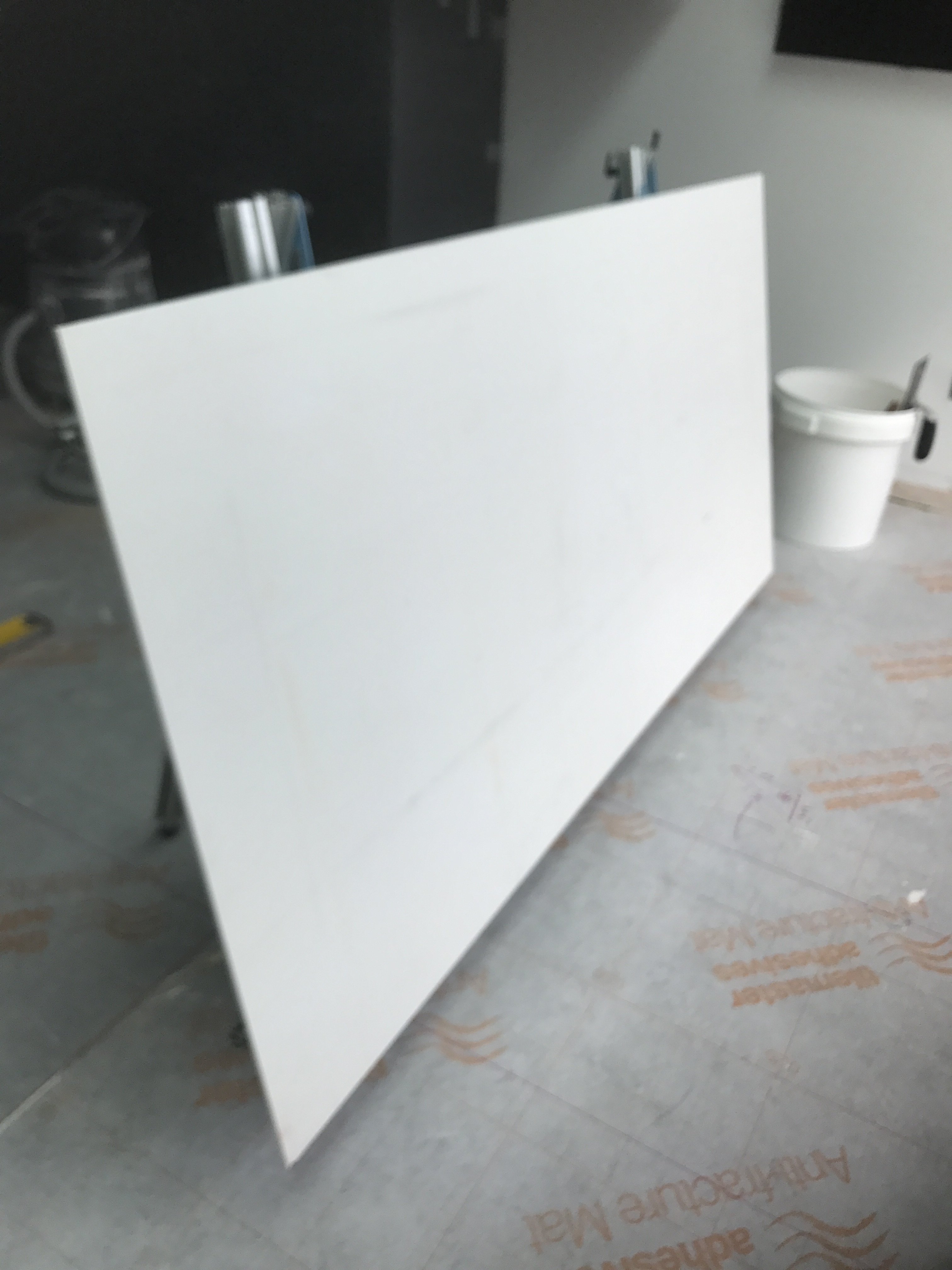

And today it enabled me to handle and fix
1800 x 900 with a complete novice, who hadn't even seen one let alone fitted one, with complete confidence.
He even back buttered the tile whilst I trowelled the floor.
Normally I'd be worried sick that it'd be broken.
Very impressed indeed. :thumbsup:
And of course it's available at everybodies favourite store @Pro Tiler Tools :)

It's the best frame /stand combo available. Just lightweight, strong, intuitive to use and not over engineered like others.
The only weakness in my view is the safety 'hooks' which are metal and liable to chip the tile edge. They need to be either nylon or cushioned.
Yeah I have the hooks, but not fitted.
Have you used them Mark?
It appears they would interfere with installing the piece, or am I not looking properly haha
One Day
They're meant for additional safety whilst carrying the frame, for instance upstairs. But if the suckers managed to fail and the hooks caught the tile, I suspect the tile would be damaged.

And the images I posted of the sigma attached to the tile is a broken down arrangement.
It consists of only 2 x 1.9m rails and 4 x 1m rails.
