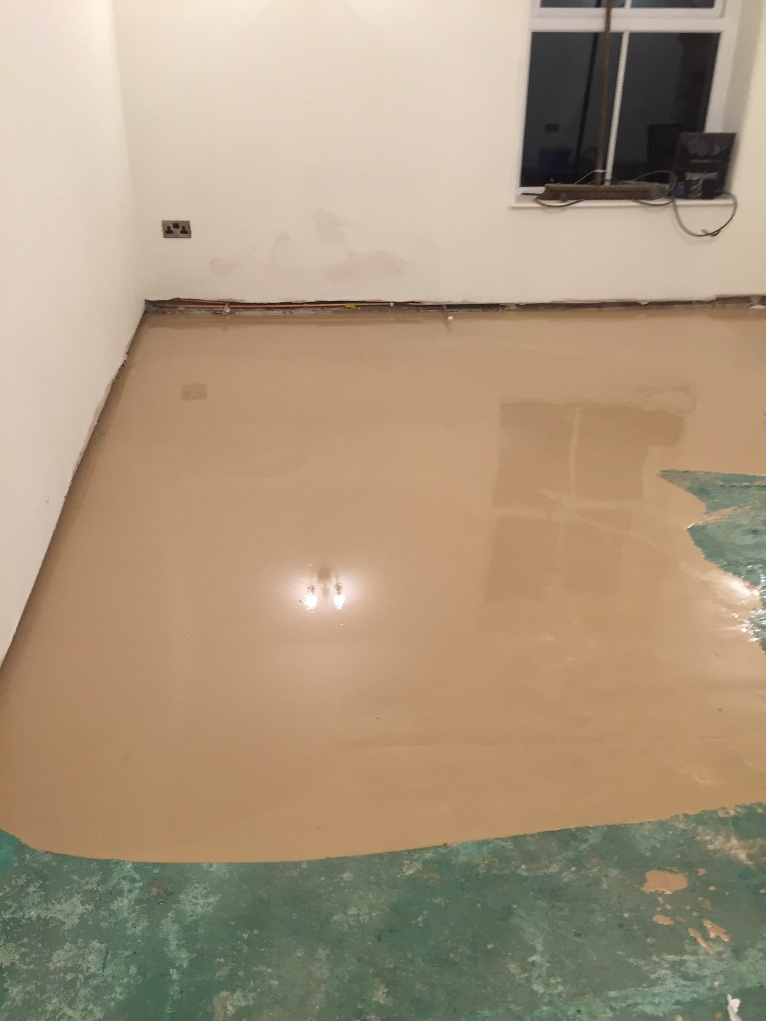

Tile master level 3,around 24m2, 12 bags, mixed and laid within a hour , walked on within another 30mins, I know that cos I left my van keys on the fire place and had to wait till 6.30 to leave 🙁
Tilemasterlevel 30
Ps I'd used Webber the day before, good stuff, but no where near as good as this stuff, flows like a pint down my neck on a Friday tea time :beercheers::beercheers::beercheers:
