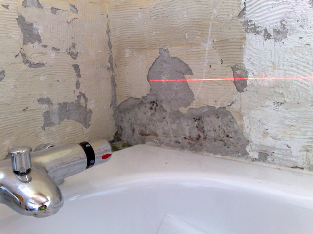

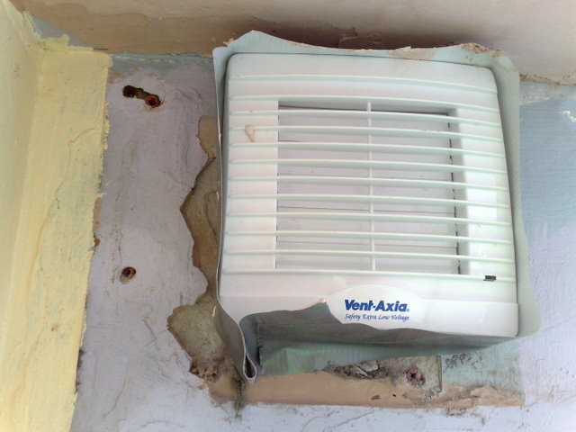

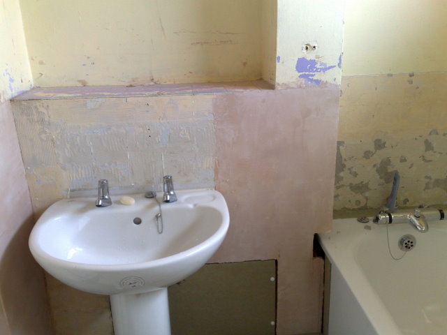

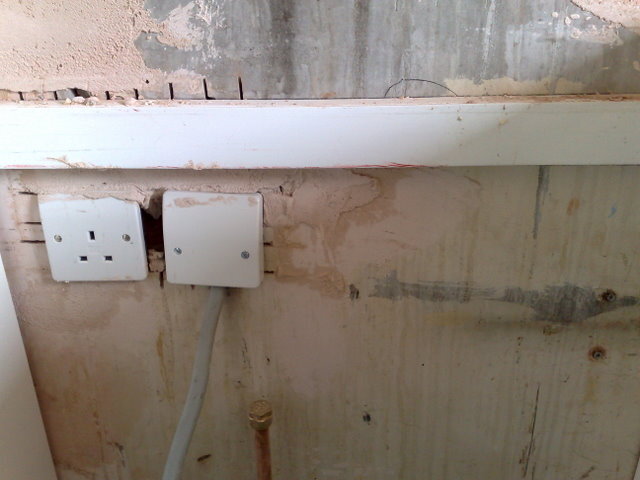

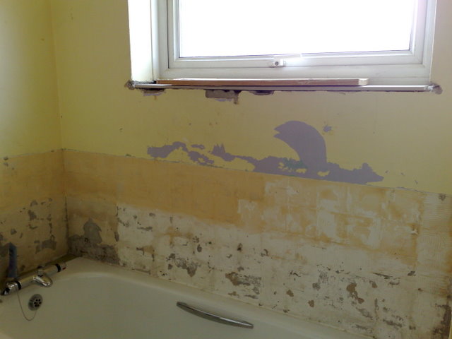

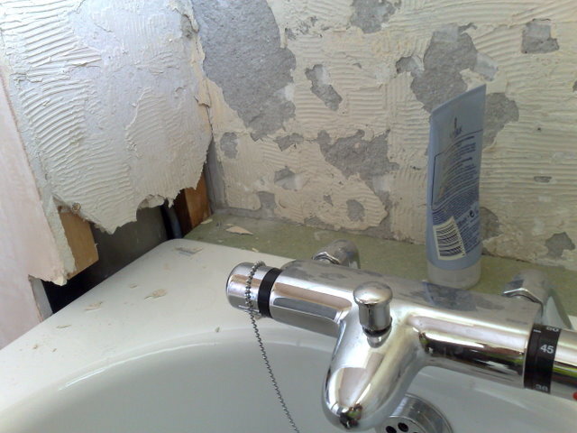

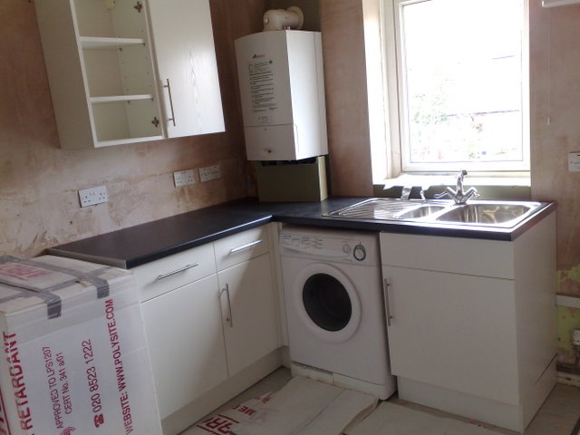

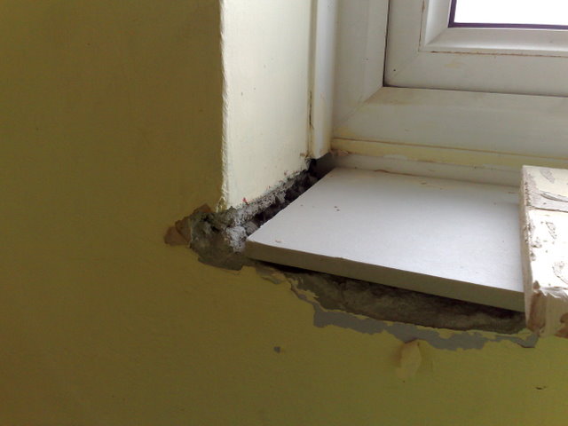

Last week I got a weeks contract on site in Croydon. When I got there I was told it was tiling kitchens and bathrooms in occupied council flats. I got shown around one of the flats and was told where to tile. I asked about the flaking paint, the wallpaper still attached to the walls, the holes in the plaster, the remains of the old adhesive still on the walls, the plasterboard window cills that were sticking out from the wall by over 5mm. I was told to tile over everything and to grout as soon as I had finished tiling. I was constantly being told that the Polish tilers tile & grout 10sqm in a day (earning £150) for themselves. I was not happy. So I did my best to right the walls and to make the substrate as flat as possible. In the end it took me 3 days (earning me £50 a day). I made sure I measured right and made even sized cuts at either end of the walls. So after only 3 days I had to give up that site........mainly due to the fact that my travelling time was way over 4 hours a day. However, I was still not happy at being told to sling the tiles up on unstable walls. I'm pretty sure that this practice is the same for every council house/flat refit, but what really peed me off was the fact that the plasterers, sparks, carpenters etc all did half jobs......which made mine all the more difficult. I was told by my foreman that my work was excellent, but I was too slow. I guess I had been spoilt for 6 weeks working on new builds. I have attached some pictures of what I had to tile over. Cheers Sean
Photos.....

Thats councils for u m8. They don't care. looked at a new kitchen they had put in for a customer about a month ago, all they had done was rip 1 row off tiles off the wall top and bottom left the rest on the wall.then fitted kitchen round it.

I sat here ****ing myself looking those pictures, what are you doing with the laser level out of the box? Mine hasn't seen daylight on these jobs yet!:lol:
I guess the kitchen splash-backs are three rows high on top of the worktop and down the back of the cooker with 15x15cm tiles.
The bathrooms are two high in bog stand 15x15 trade(wafer) tiles. I feel honoured when I get the the full bath area to do. It made my day the last week when I got a doorstep to do...:thumbsup:

Mad hatter, laser level is a great little tool. Got the Stabila LAX50, but I just carry around the laser bit. The tripod stays in my shed. I use it because it's my new toy, and I do find it really useful. It gives me that extra bit of confidence, and it impresses the customers. No minging council places yet because I gave up that site a couple of weeks ago. I got offered another council site in Essex (150 mile round trip). I said no to that too. You are of course right about the tiles and the 3 rows above kitchen worktop. Tiles are quite good ones, so is the addy (Bal White star) I was very impressed with the materials.
