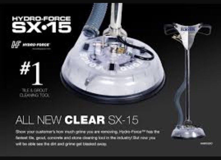

steam cleaning stone tiles! same as sx 15??
Yes a travertine tile with holes can be filled with a resin but it needs to be cleaned out first thats what I am trying to find out why a steam cleaner is so bad compared to the sx 15.
Which statement? The heading for this section is cleaning and restoration! Im not saying post has been ignored maybe some members have not seen it yet?? Im 100% sure that someone will know what a sx 15 is.

I do know what it is!

Ive got diamond pads they wont touch a hole in trav? Im sure you know some trav has hundreds of holes with ingained dirt in thats why restoration companies use the sx 15, ive tested a steam cleaner and extracted and this cleans out holes well but less aggressively, my original question was will it damage the tile.

One of the reasons you don't use steam or pressurised water systems is because it'll remove impregnators and then you're left with extended drying times before re sealing.
And if it has a topical dealer, it'll get behind it and bloom.
Ok thanks yes was planning to just clean trav holes out with steam not face of tile so in theory would only be done every 4 to 5 years with steam not regular cleaning, then would be resealed, like you said about pressure water systems that's what a sx 15 is with hot water and high psi that's why I was questioning how suitable they are but lots of people use them.
