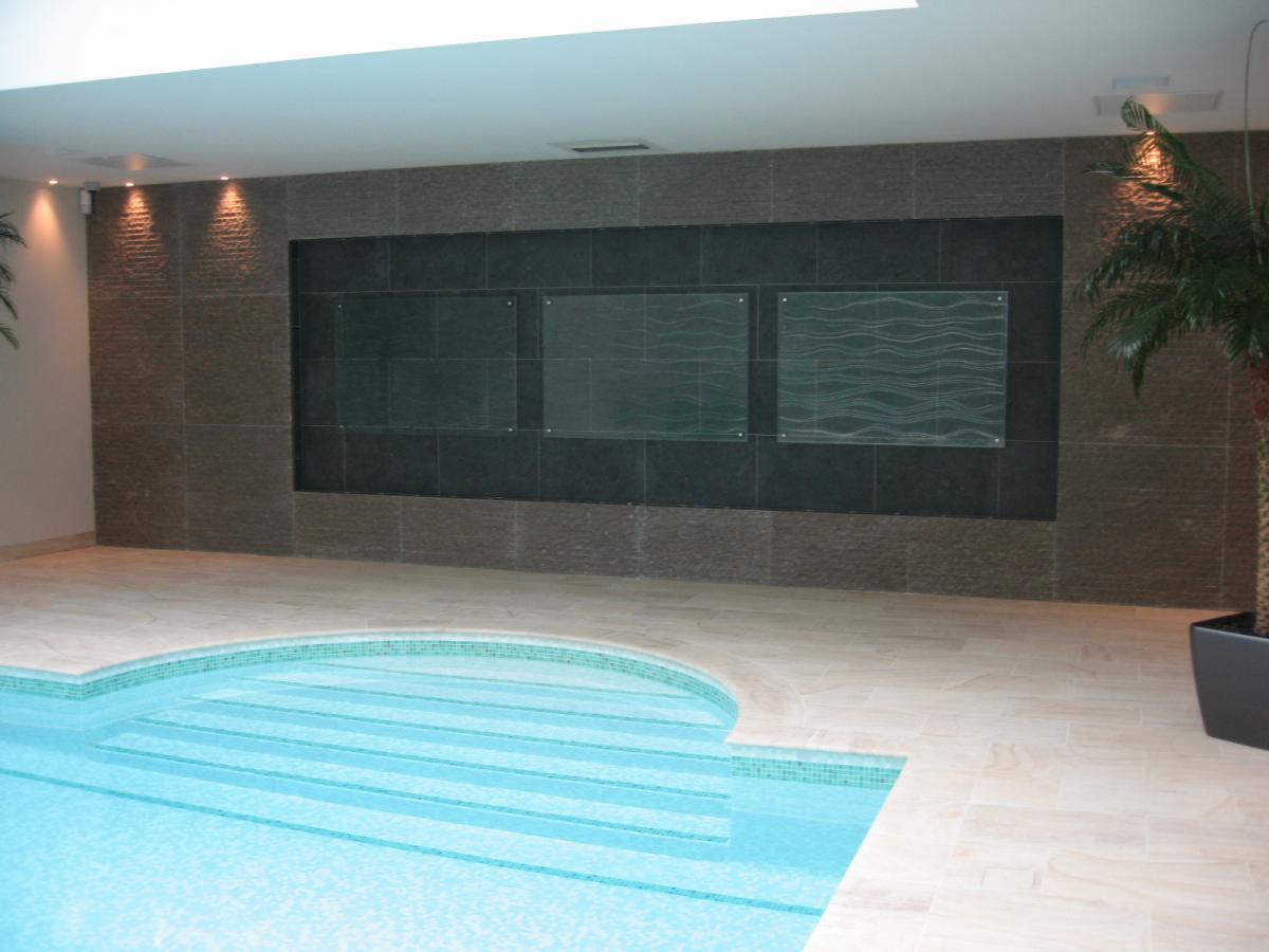

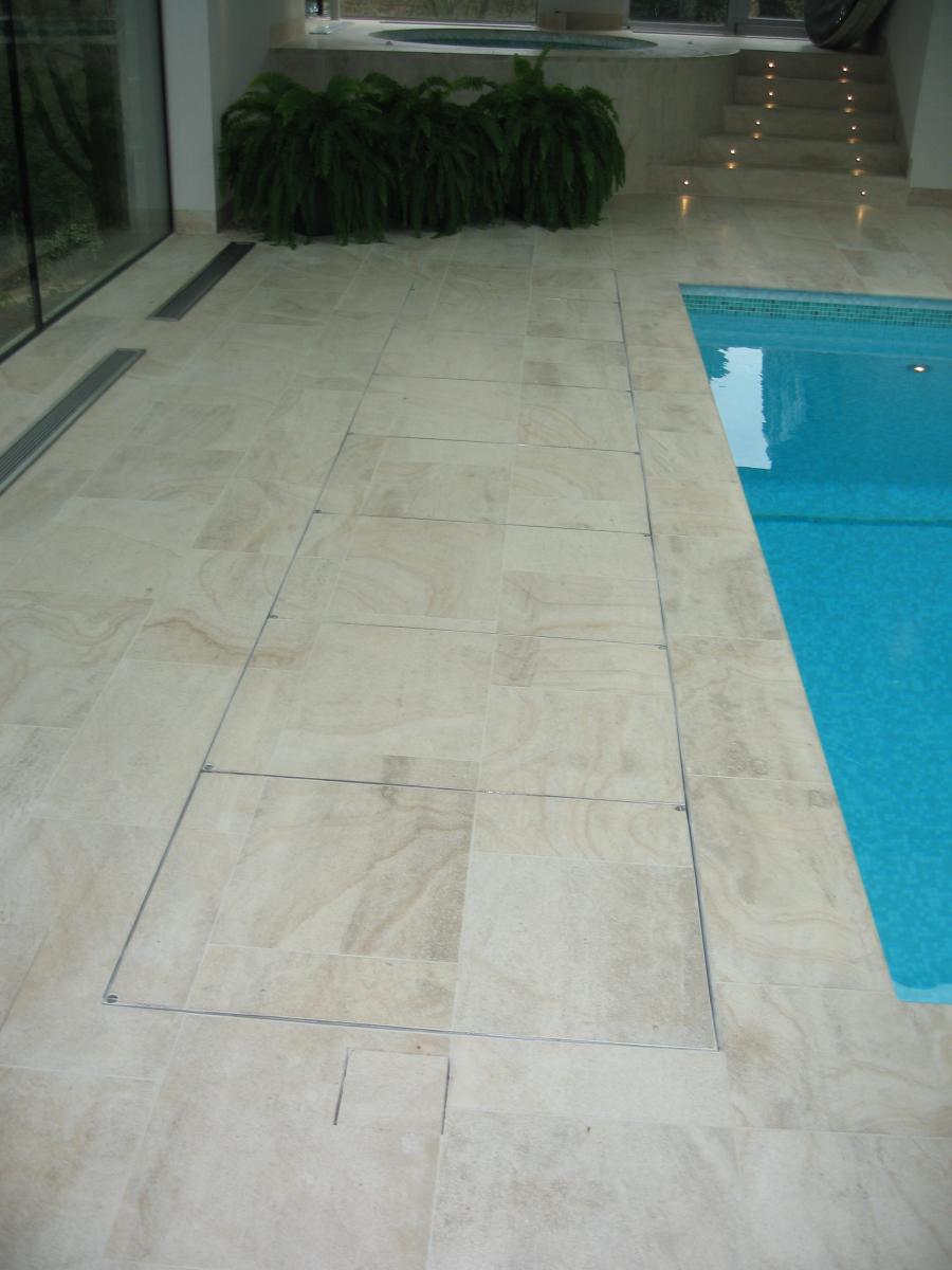

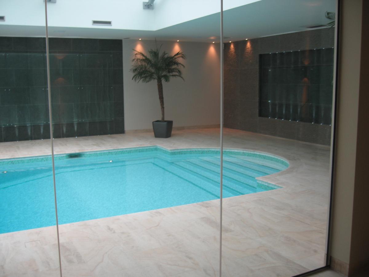

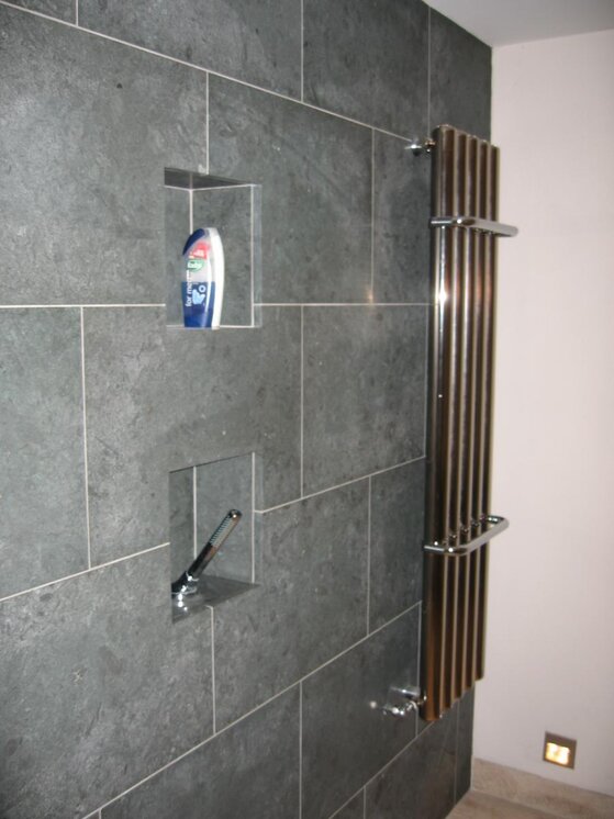

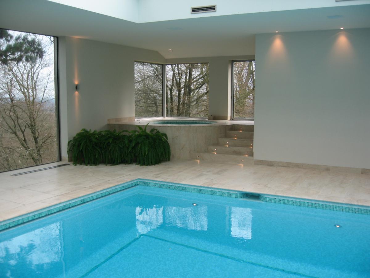

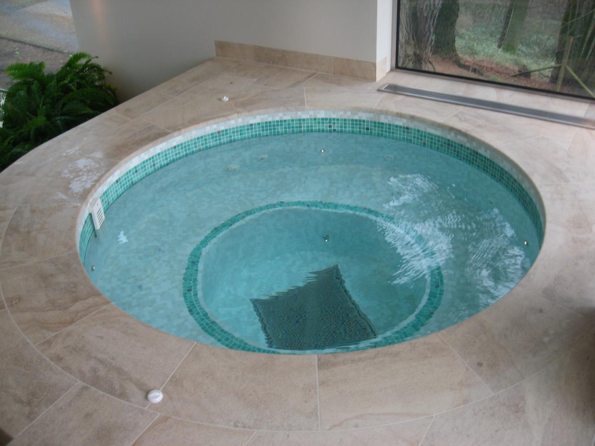

this is probably the most enjoyable contract i have carried out.
i had done a pool surround in the clients previous house.
the client who loves stone did their own research, created their own design and ordered stone with my help about quantities only.
I gave them the quantities for field stone and with the specials we ordered oversize and i cut and finished all the copings /treads /jacuzzi with a dewalt portable wet router.
it was the first time i had set stone on the vertical face as tiles and then it was ground back on site to come flush with the radius coping above.
they simply told me what they wanted , i costed accordingly.
this french brabazon stone is a dream to work with and have used on numerous projects inside and out over last 15 years.
for some reason it never gets affected by outside and has stood up against any competitor.
