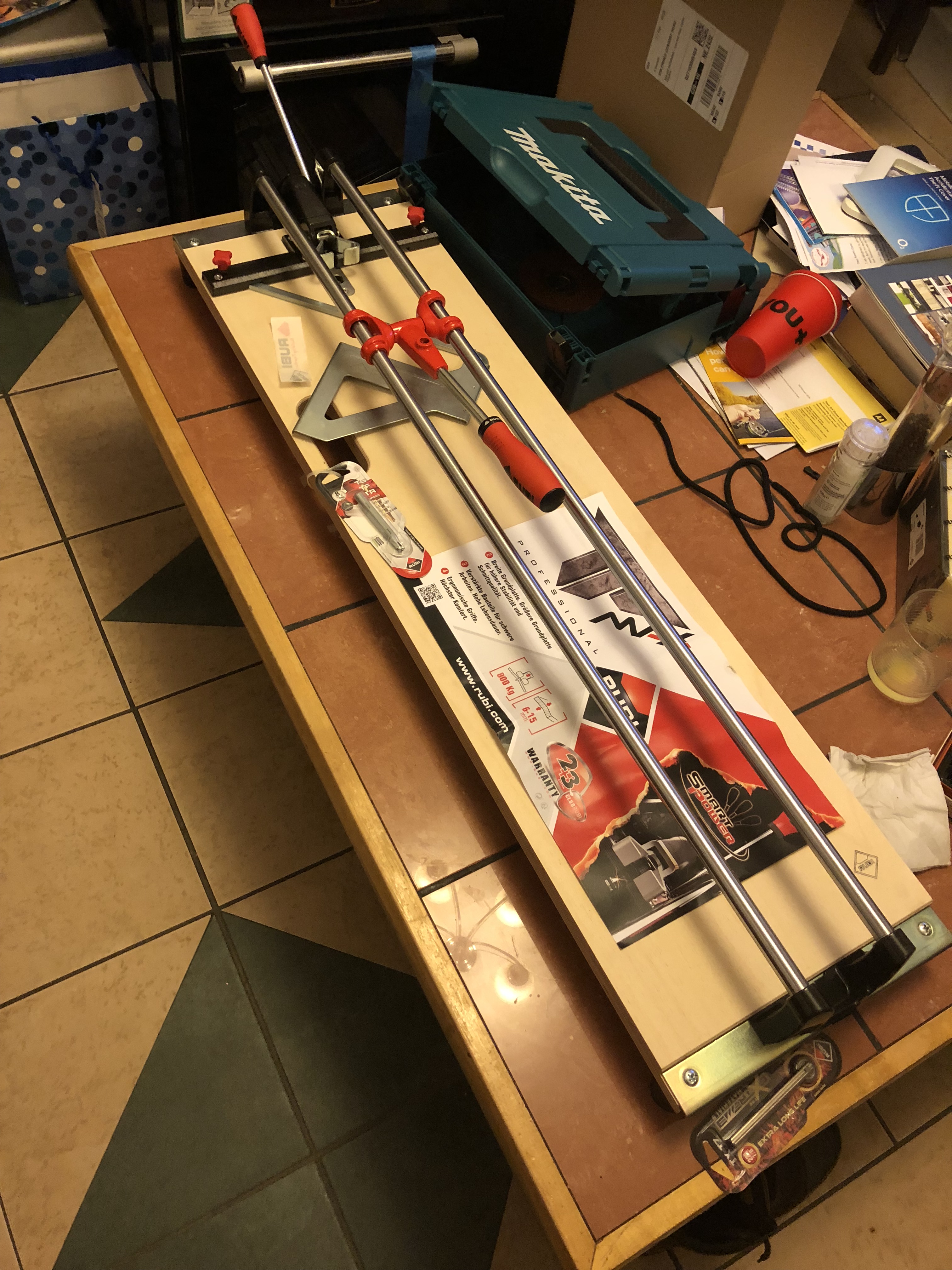

I've noticed that when cutting large format porcelain on my Rubi TS70 plus that I sometimes get a less than perfectly straight cut. Its almost perfectly straight, but I've been getting a very slight bow which is noticeable (to me) when the cut edges are against trim etc. I usually give cut edges a going over with a 60 grit diamond block to smooth them.
Is it me, or is the cutter on its limits for this kind of tile, or something else perhaps?

Cutter. Sometimes my Sigma 1200 does it. I think it depends how much pressure you use
Thanks Simon.
Yes was thinking along similar lines. Its only a pressed steel bed on the Rubi, so may deflect a tad. I've got the latest snapper in it and it generally cuts well...but I did have a go on a Monty which I liked and also a Sigma. Probably better suited to big porcelain, but can't quite justify one yet :)

I had a similar issue on my monty, I changed the scoring wheel and it’s bang on now.
Try changing the scoring wheel and see how it goes
Good idea Adey, thank you. Yes, certainly can't hurt. The cut only deflects about about a mm/half a mm at most, just annoys me in my quest for perfection :)
No deflection on this one
