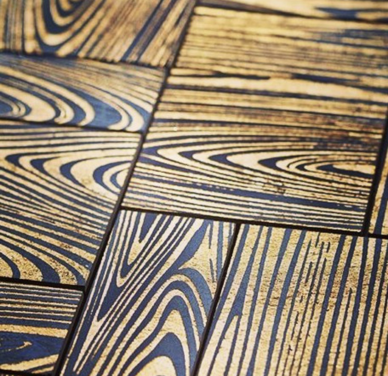

Ah! Actually, I noticed some designer tiles on Instagram today, do you use it Ian?
No had AOL dial up last time I used it!
