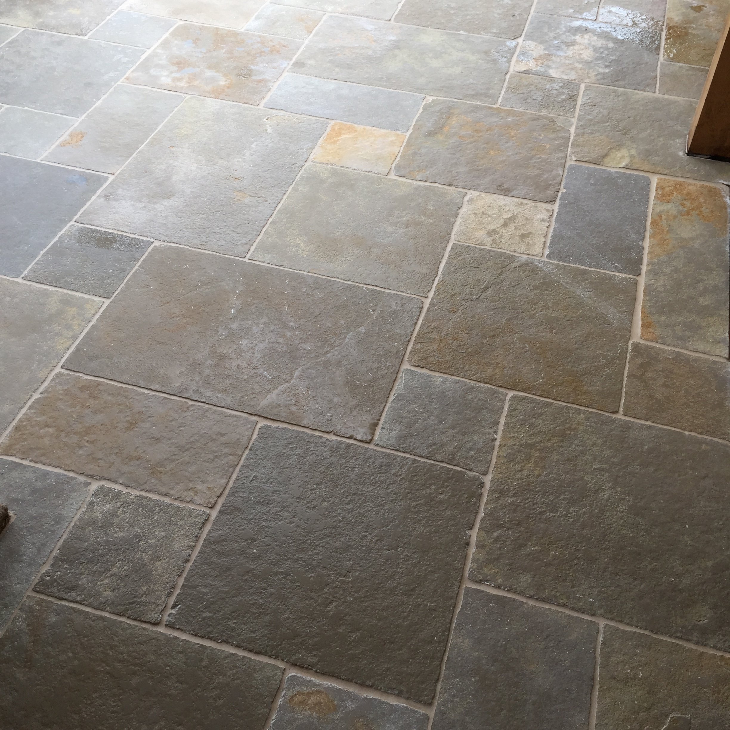

Used the ATS flush cut vanity blade last week and found it excellent...View attachment 92621
Took your advice and after the first few cuts it seemed to wear its self in, worked a dream ✔️ Cheers
