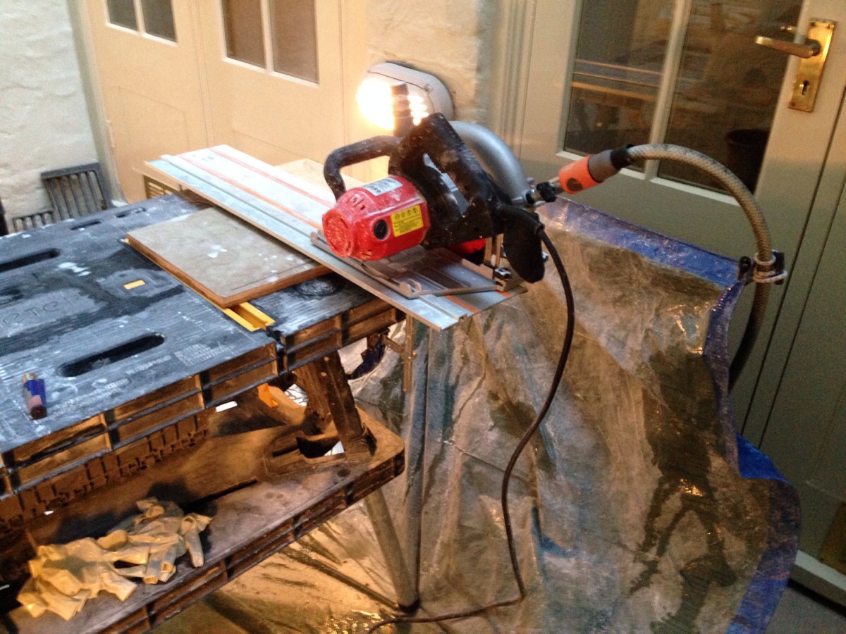

I've got Rubi TC 180. It's wet & dry. With decent dust extraction u can use inside no problem but u must have blade at full cutting depth otherwise the cowling doesn't collect all the dust. When usin wet u must use outside. It's half price of the Flex but doesn't mitre. Use Festool guides and quick release clamps. U can get festool 1400 guide for under £60 whereas Rubi 800mm is over £80 and quick clamps over £50. There is one mil diff between two guides but no noticeable difference. The cutting blade will also overhang the Festool guide by 4mm but u can adjust for that when marking out your cut. It sounds fiddly but it truly isn't and with the right blade for the right material it'll give u factory cuts (well near enough) I regularly use it on 600x300 Porc and gives cuts clean enough to use as a leading edge on windows. if u can access CTD it's stil on offer at under £400. Bargain!

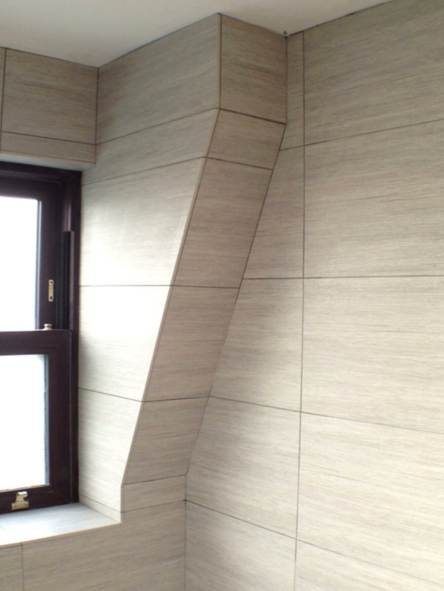

Heres a pic where I've used it dry indoors and used cut edge as a leading edge around window. The full set of pics are in the 'wall and floor tilers work' thread, entitled Another Loft.
