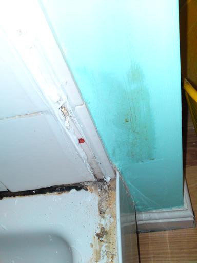

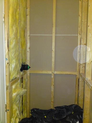

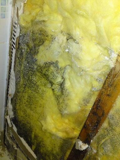

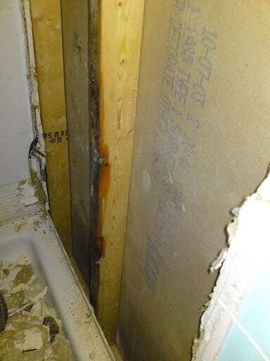

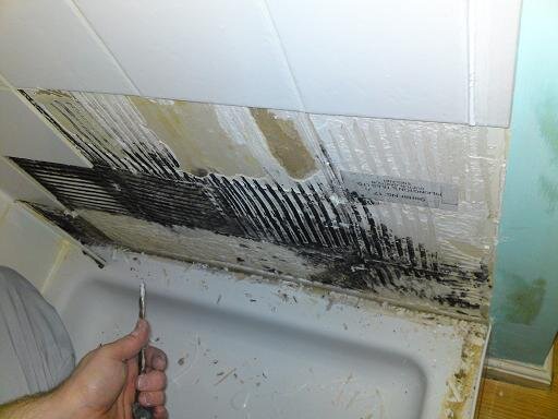

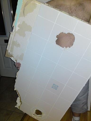

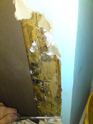

Just started stripping back my en-suite shower cubicle.. I knew it was going to be bad.. but didn't realise it was going to be this bad.

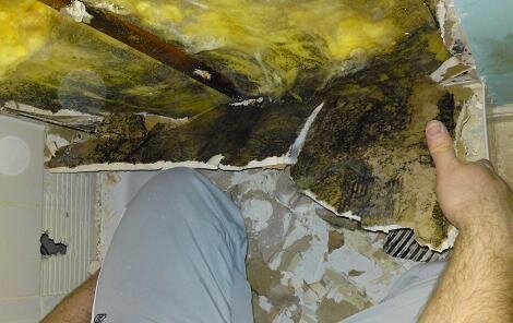

make sure you let that timber dry out completely before you go any further and try and get a coat of timber/rot treatment on..kill any bacteria/spores that can lead to other issues!

Liz..make sure you kill those mould spores..

Did have to do a regrout on a shower once, all the studwork on one side of the shower was gone, rotten to the core.
You mean you avent seen a bargain yet :lol:any recommendations about what to purchase to kill the mould? i have some mould killer solution in the cupboard but it's a couple of years old now.

Good old neat bleach liz..

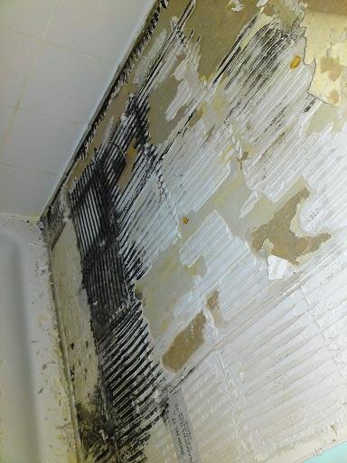

hi liz yes a common thing to see any pics of tap wall as that is norm the source of prob (not sealed around taps ) as already advised let it dry out :8:
