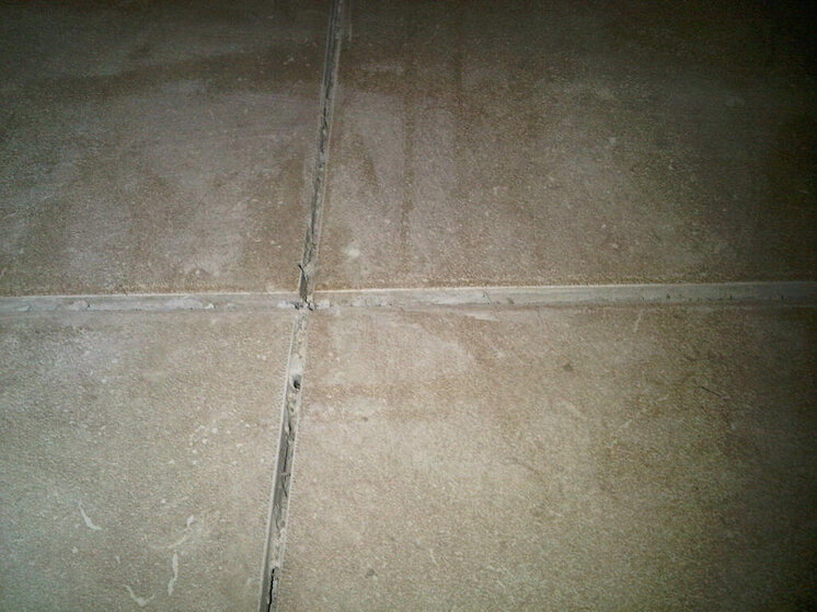

I have laid all the whole tiles and plan to do do all the cuts tomorrow. My problem is that a couple of the tiles have a 2mm lip and a few of the others a 1mm lip which i appreciate is far from perfect. Bearing in mind i have never held a trowel before, let alone tiled would you say i should stick with it and continue or pull up and start again?
Will the grout tidy this up slightly? Unfortunately i only have 2mm gaps so i guess it will only help so much.

hi if you dont mind a pic might help its hard to call without a view thanks
Hi, Its difficult to get it to show with the camera but this might help. This picture is the worse one which is 3mm so i'm going to pull this one up. What the best way to pull up trying not to break the tile?

2mm grout line is asking quite alot of yourself, you said that the slc stage didn't go well, however, if you take your time and lay each tile 1 by 1 (which is obvious!!!!!) you will be fine. Judging by your photos (and please don't take this the wrong way) you have said 'that'll do' and that is why you have the lips. When laying, line each tile up with the ones adjacent to it to make sure they are flush (no lippage) and once you are happy with this pull it away to make your grout line. hope this makes sense, basically what I'm trying to say is line the tile up to its neighbours before putting your spacer in???!!! :)

best to remove and try again you should be able to get tiles down to within 1mm or better time and patience make sure your adh is mixed right as to wet will let tiles slump
if tiles are less than 12 hours old (from laying) then you may be able to lift them but try not to damage next tile if older you can break the tile and remove from the centre out (gloves glasses ect)
good luck and remember you have to live with it

A useful tip. My eyesight isn't what it was and when I am laying tiles in less than perfect light (and you are often in your own light) I need reading glasses. I use a 3 inch piece of architrave cut square and slide this over adjacent tiles onto the one I am laying and back again. If I can feel a resistance then 'not good enough'. Works well and ensures no unnoticed lippage.

I use the same method as easyt as sometimes it can be deceptive but a short straight edge picks up the smallest of lips and you get the little "donk" too,,,,,,,,,,,,,,,,tiling by ear
tbh that lip looks nearer 5mm than 3mm and the tiles need lifting and starting again
tiling is no where near as easy as people think it is, so just persevere and take your time, and as stated above set yout tile to the surrounding tiles and them just pull out to form your grout joint
