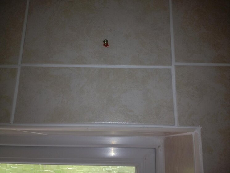

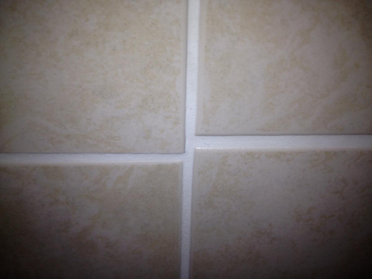

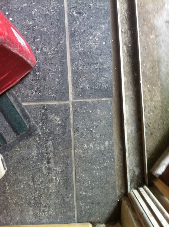

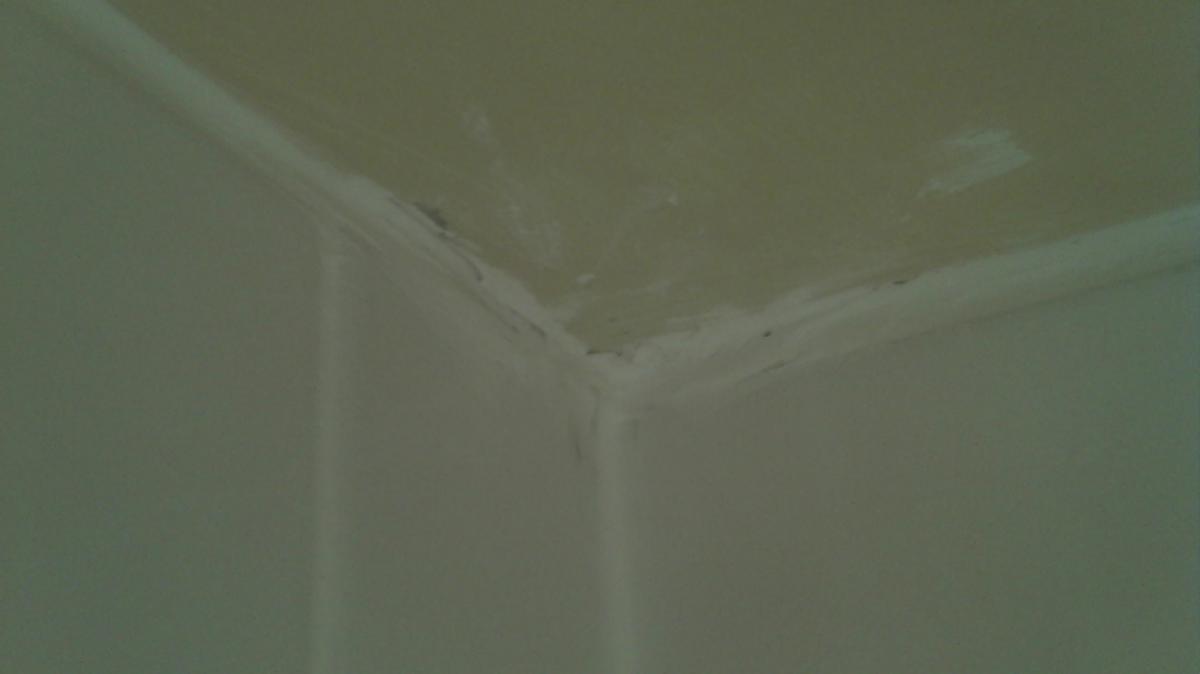

Loving this subject, unbelieveable pics posted. Heres mine, with more to follow.

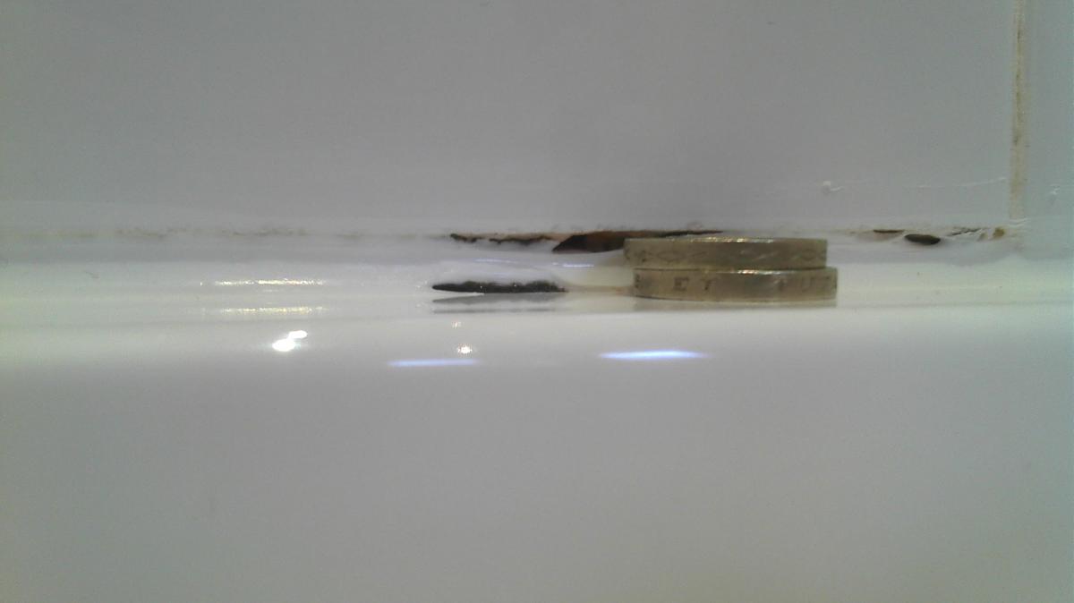

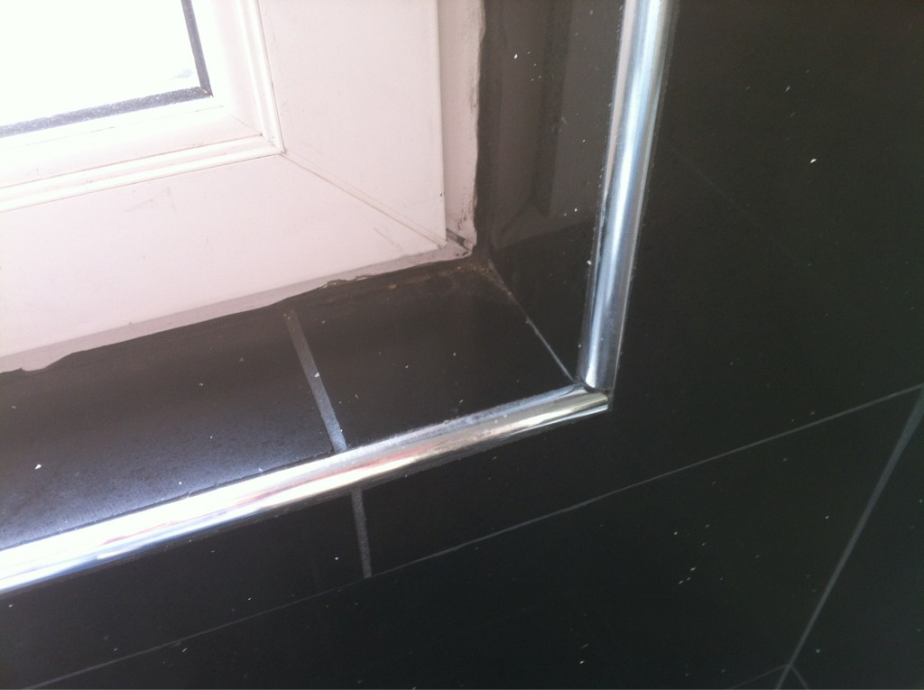

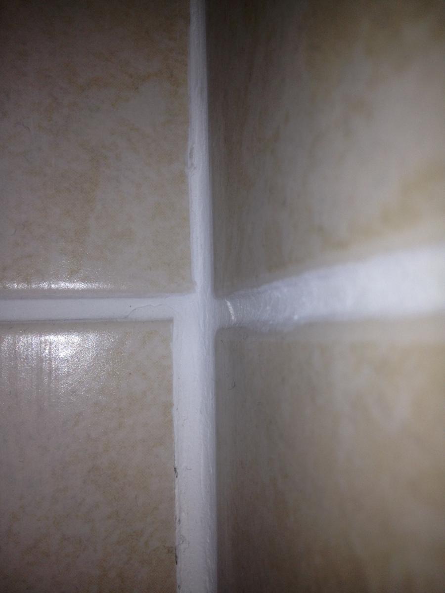

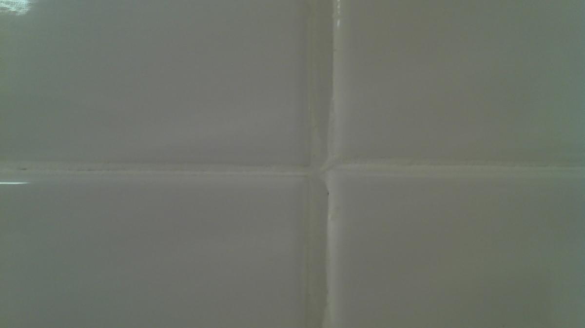

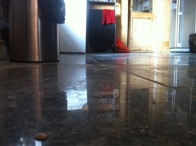

I did a job last year that a builder started and didnt finish, what he had done was crap. He started fixing large glass tiles but couldnt cut them with his grinder as they kept cracking! I fixed the glass tiles and the customer asked me to fix his mess. The floor was p****d and a tiny cut was left running into the hallway that was also supposed to be tiled. He'd left loads of cuts undone and a couple of wall tiles with corners missing!
Apparently he'd not had any complaints before, but the customer said he was a bully. Anyway she's suing him.

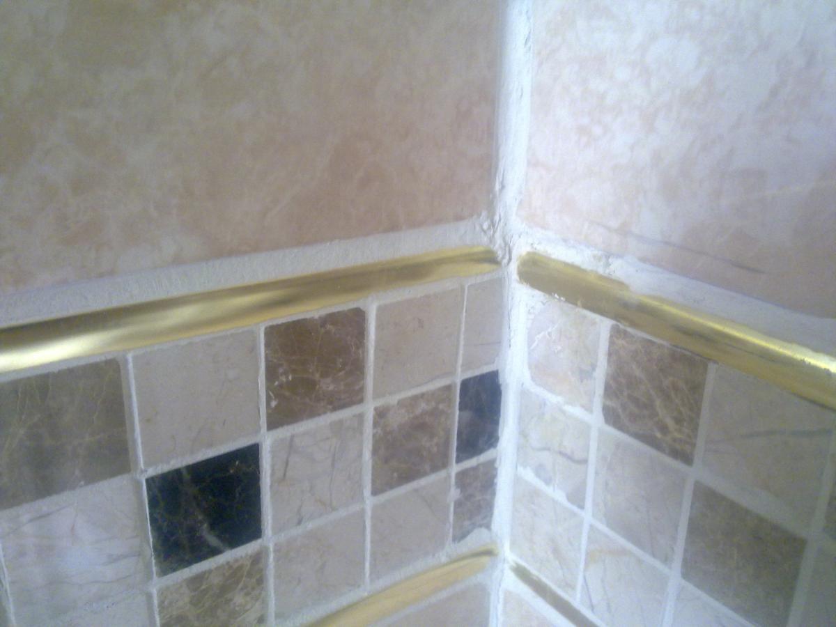

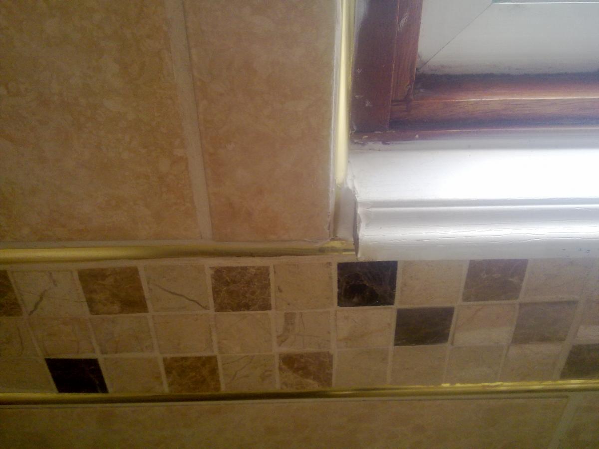

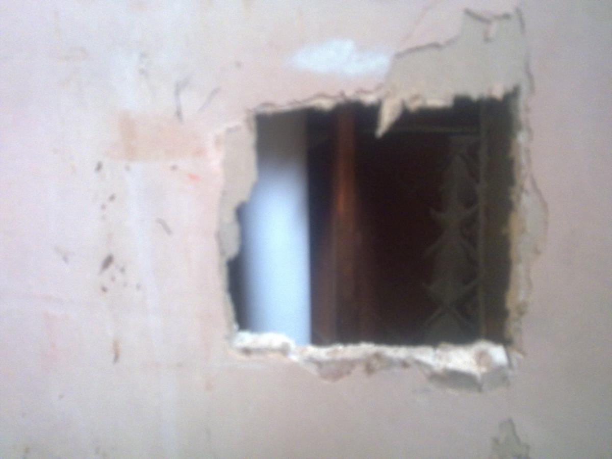

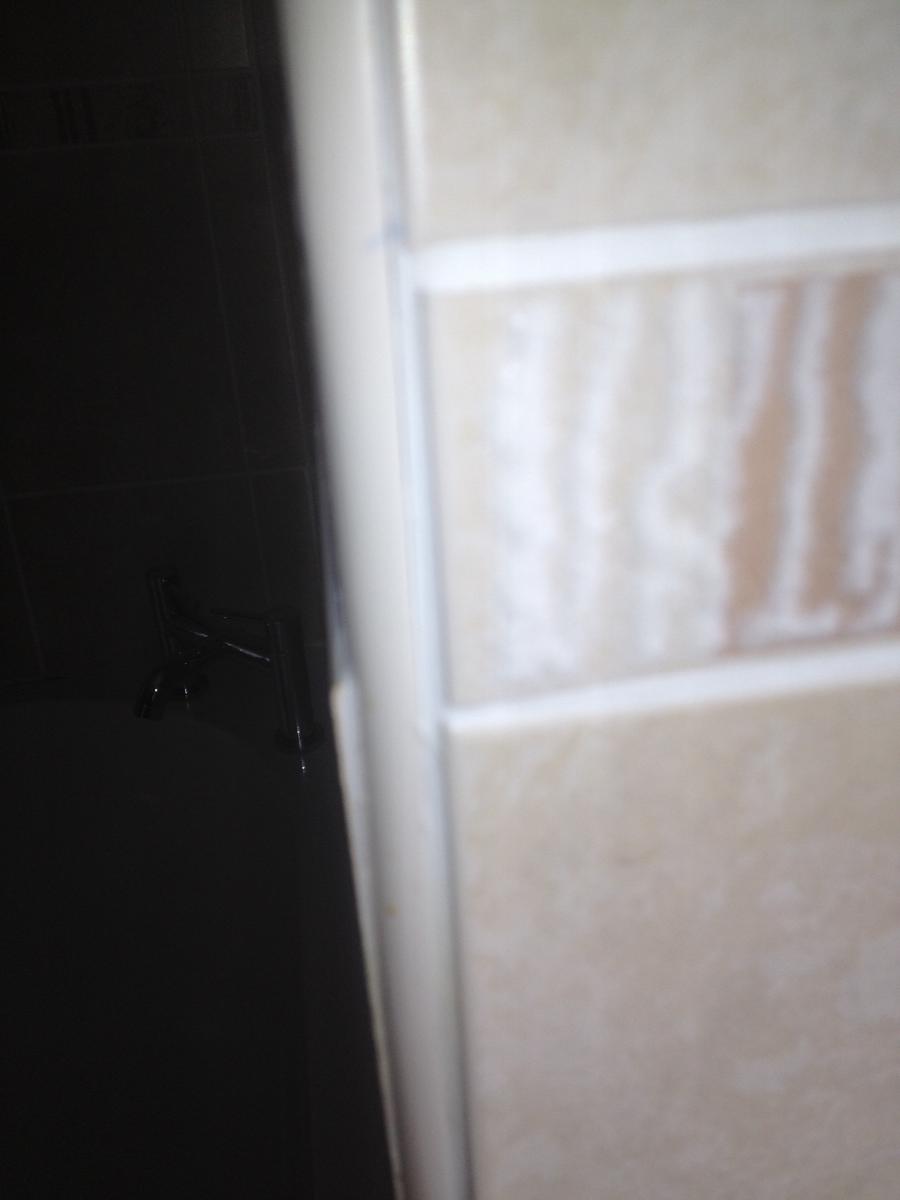

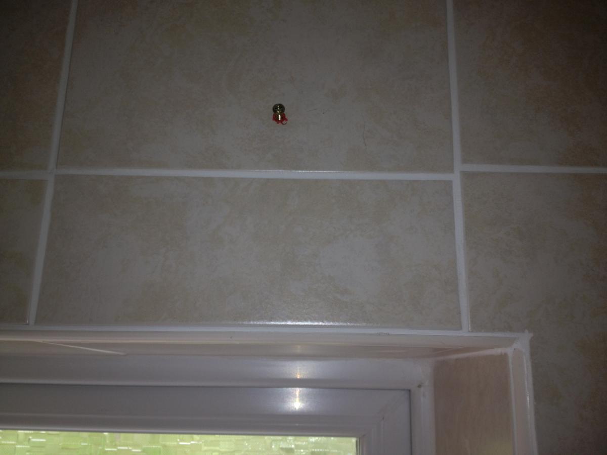

Some stunning mosaic work!
The purple mosaic I re-did, as luckily the customer had enough left, but there were other mosaics in the house that had been done badly but they couldnt afford to get it replaced. Theyd taken the cheapest quote. The plumber called me in to do it as I knew him through another job and he said the bathroom had been reboarded square but for some reason the tilers spirit level mustve been telling them different, hence the gap!
The other pic was from my local chinese takeaway I couldnt believe the mess and took a sneeky pic!

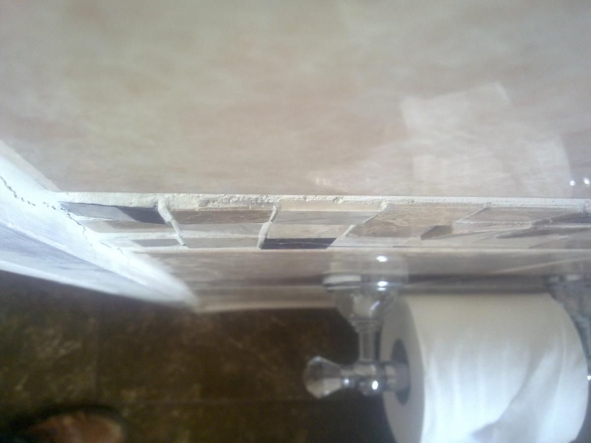

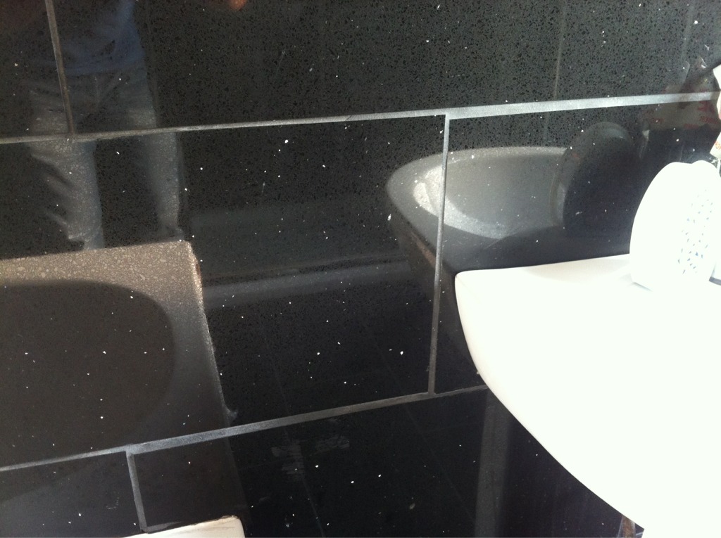

Ok so here are my latest nightmare tiles! Ihave had to look at these daily for almost four years!
Thats right they are in my OWN family bathroom. God only knows who tiled it but love the way they started with the full tile without looking at the level of the wall. If you look closely you can see the colour of the suite too (Sun King for those that might remember)
I particlularly like the dot and dab on the ply bath panel. Hence they ell offwhen i took the panel out. Strangely though most of them left a small impression of the outline of Australia in the addy.

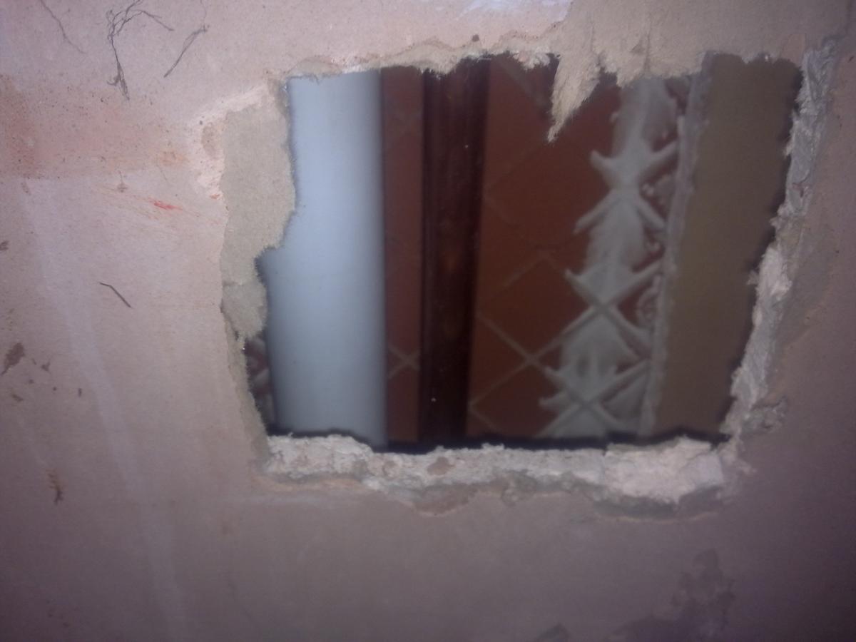

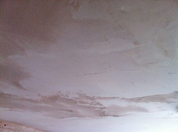

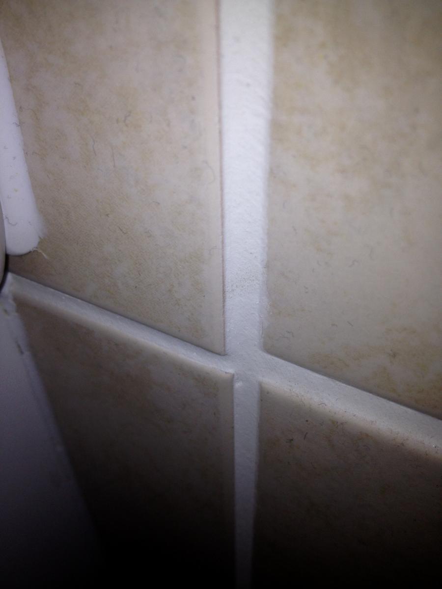

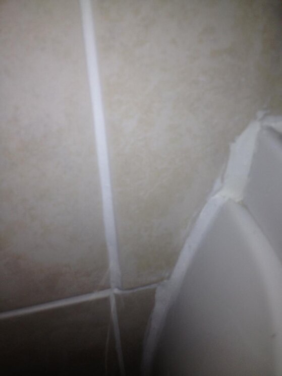

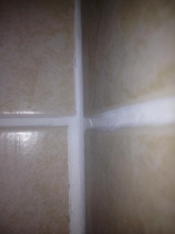

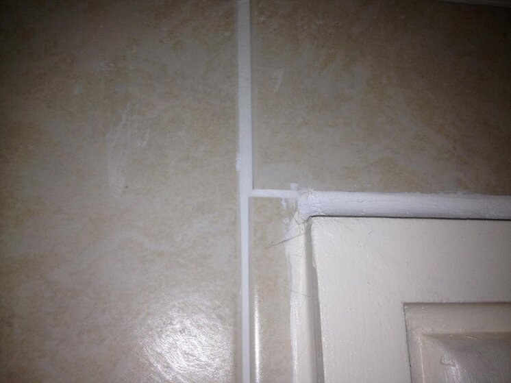

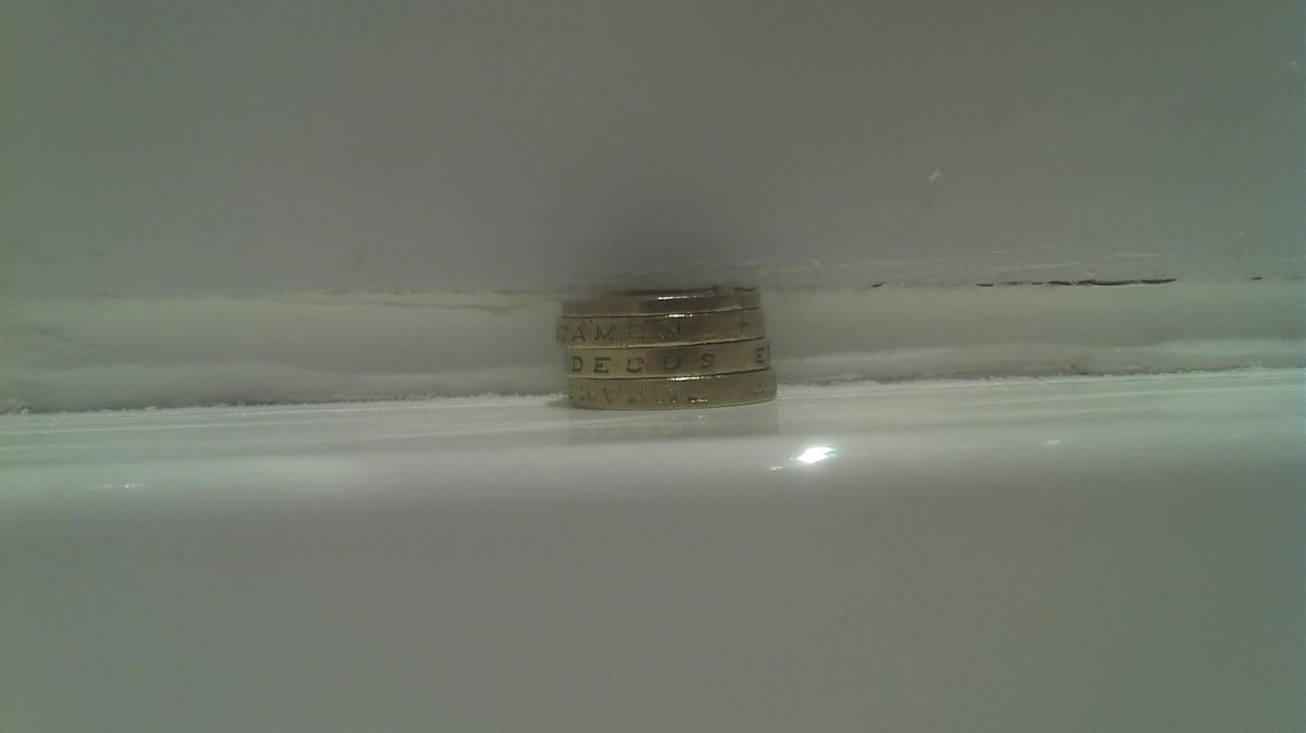

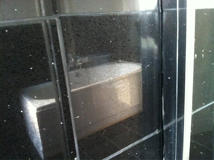

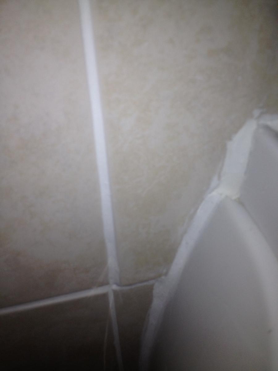

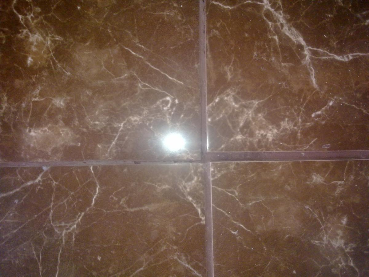

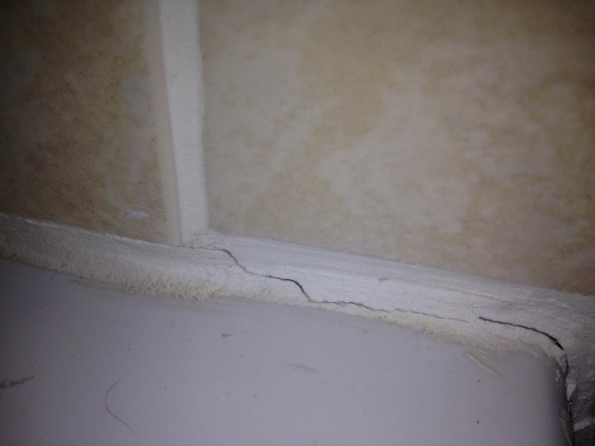

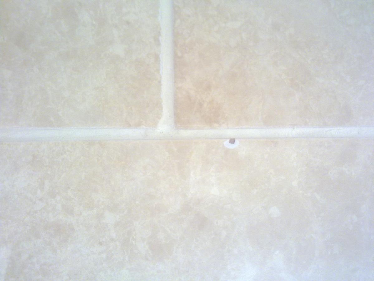

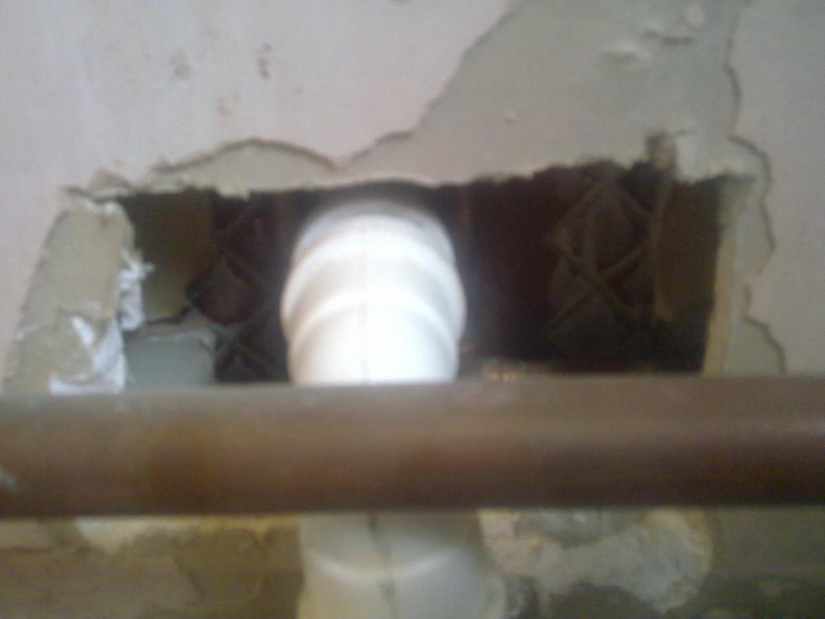

I'll add to this motley collection with the job I went to today!

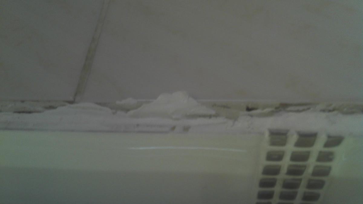

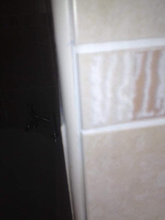

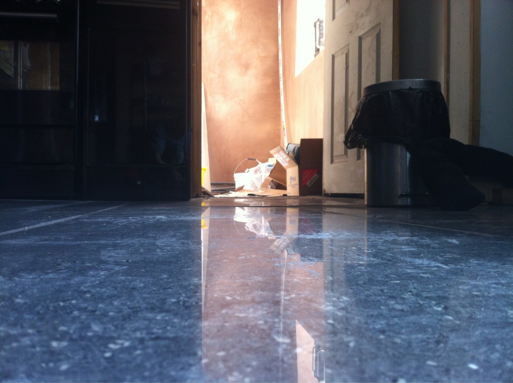

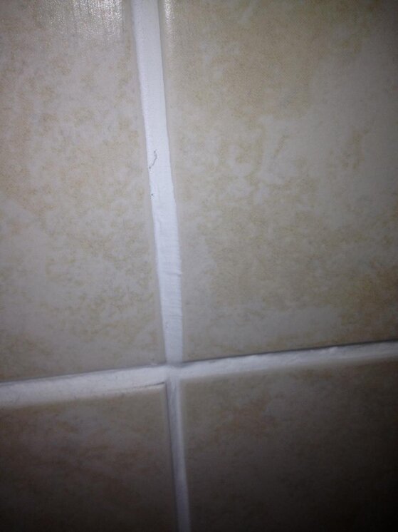

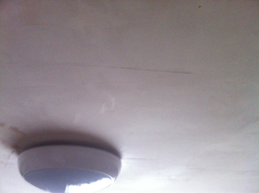

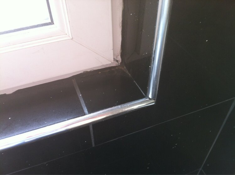

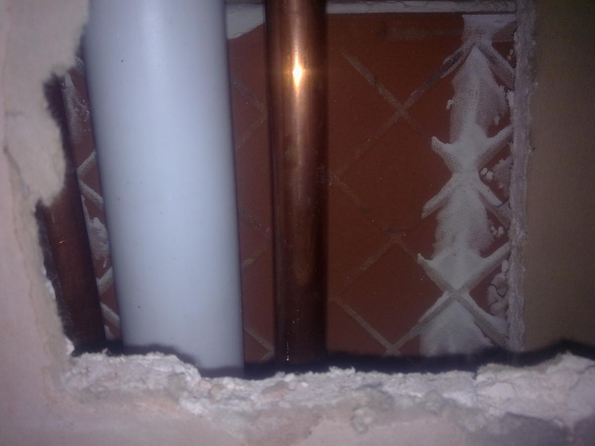

The people had a 'tiler' in to re-do the bathroom...recommended by their neighbours..they wanted me re-grout some 'loose' tiles..there literally was nothing holding the floor down, no overboarding straight onto ply with god knows what adhesive (looked like superflex..but was really gritty instead of rubbery) and they came up with my fingers only..the whole floor has to come up as do the walls (dot n dabbed with plasterboard blown in the shower cubicle) the mastic looked like an imbecile had done it..as did all the cuts.
I told them maybe their neighbours don't like them recommending someone who's work was like this!..enjoy!
