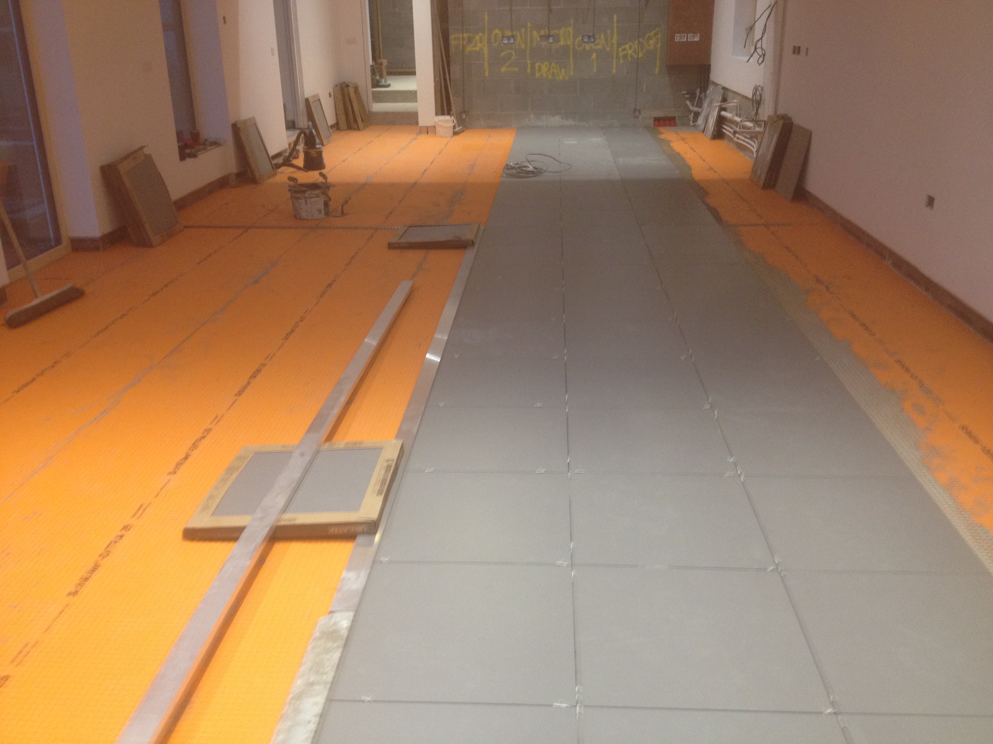

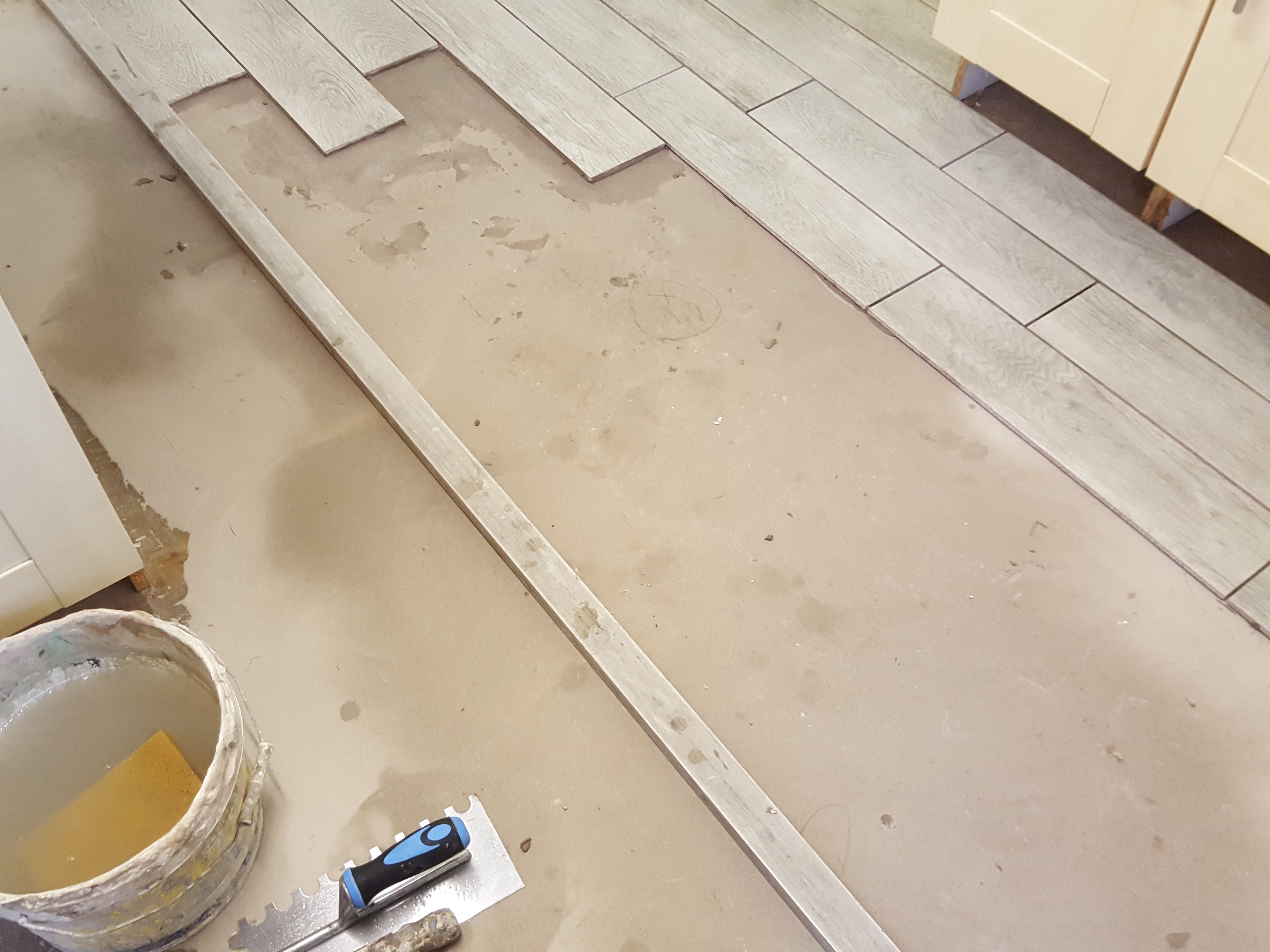

what do people use as a straight edge when you need one longer than a 6 or 8 ft level if any?
I was wondering if a portable straight edge exists or does anyone have a home made version.
Saw a few videos on Instagram from some Canadian tilers laying large format floor tiles with long metal straight edges and was wondering if anyone knows of anything similar

My dad used to make fire engines and a long piece of aluminium box section fell off one and landed in my van.... :)
Ideal for me as I never use spacers on floors, just straight edges..
We stock a 3 metre aluminium straight edge if that helps. Thickness 12mm & width 100mm or thereabouts without being next to one to measure it accurately.
