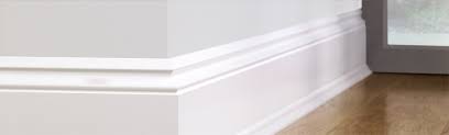

Think I'd trim the skirting if I was bothered about edges..
How about what you'd normally find in probably every house in the country??
images
I do have a wet cutter yes.
It's what the lady wants, wooden skirting would be a lot easier and quicker but he who pays the piper calls the tune.
