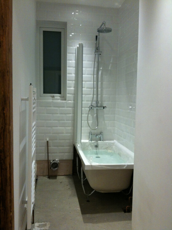

Regarding the sink height... I completely agree about removing sanitary ware before tiling but the sink is wall hung with no pedestal. The fixing screws are already in place as I wanted to make sure the rag bolts were securely bedded in the brick (and not the tiles) so I secured these in place before tiling the wall. Basically, the sink height cannot be changed. I suppose I could fit a flexible connector to the wc pan but I have already bought a fixed straight one and wanted to avoid a flexible connector if possible. There is a bit of give on the current soil pipe but not much!
I realise it isn't ideal, and like any job I would probably do things slightly differently if I started over! I've attached a picture of where i'm at with it but I really want to try and avoid raising the height of the floor as much as possible so i'm just going to have to make the best of it.
I think I will definitely go with the BAL Fastflex adhesive and BAL superflex wide joint. If I was to overboard with a single layer of 6mm board, would you recommend cement board, hardiebacker or aquaboard for the floor? Also, do i need to prime the chipboard and /or overboard and what would I best be using for this? APD or SBR primer?

sbr and yes prime the chipboard before you install the tile backing boards; with single part flexible adhesive and screws. aqua panel is what i have available to me but hardi does have a good rep too.
if bal is your adhesive choice then it is great stuff, if you can afford the prices, they are the industry leaders in this country and have good tech advice and is guaranteed for 25 years.
from what you have done already looks good from what i can see, hope you will put some photos up of the finished job.
put some real thought into removing the sink before installation, as it would benefit the overall look of your project. ask yourself the question? on completion 6 month down the line are you gonna wish you had taken it off? if not then leave it on.
hope you have got all the advice you need to tackle this project and again dont forget to put pics up of the finished job.
