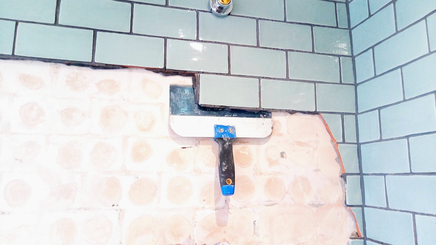

Tiles falling off the wall due to condensation: shower headView attachment 136112
No matter what you install on the walls, tile or panels there is ongoing condensation going on behind the tile/panel 24/7
Hmm. I'm no expert but it looks like those tiles have been dot-and-dabbed and/or have been very poorly applied in the first place and/or the adhesive itself has failed, ie nothing to do with whether the substrate was plywood or not.
Is this really the way walls should be tiled? I applied my tile cement with one of those notched trowels and none of the tiles are even loose, never mind falling off, including the ones I fixed to the ceiling!

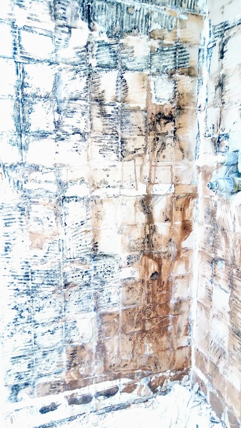

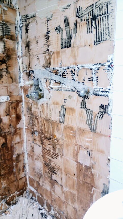

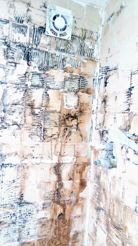

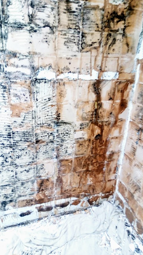

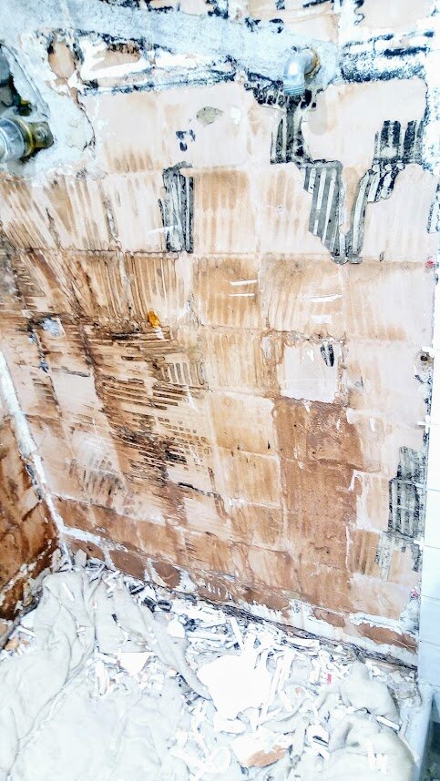

See these pictures, it is a brick wall, troweled, condensation/moisture damaged, black mold like never seen before.
Notice, the black mold grows from inside out.
Every single job of mine is well documented. An effort to educate the customer about what is going on withing the building trade and the importance of using the best materials available on the market, and the importance of waterproofing.
Once you get into the repair business and run into these jobs on a daily basis you get an idea what's good or bad. There are good, bad and in between materials available on the market. Good materials cost money but gets you a top-notch lasting job. Bad/in between materials cost less but gets you nowhere.
