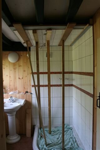

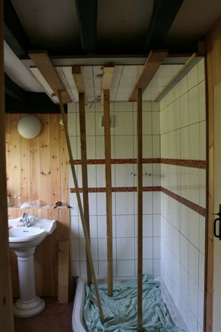

Meanwhile, just to show I don't always listen to reason, I decided to tile the shower ceiling anyway. :yikes:
I figured that if they started to fall off, they would just match the shambles that is the rest of the house. It's surprising how relaxed you can eventually get about windows where the original wood lintels have crumbled to dust, cracks in the walls and doors with such wide gaps that toads find their way into the kitchen overnight.

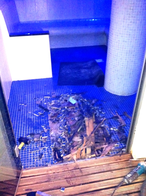

Plywood expands and contracts more than concrete backer board. If water finds its way onto and into your plywood, the plywood will expand. The expansion will create a soft spot under the tile that will give in when someone steps on it. This will almost always cause cracks in your grout and in some cases will pop tiles up completely.
hello
I have a sample too, this floor was done half year ago in steam room, Ply was tanked with paint on system all joints seems was taped too,
Ply was soaking wet, I was ripping ply like piece of paper, just pure nightmare 🙂
