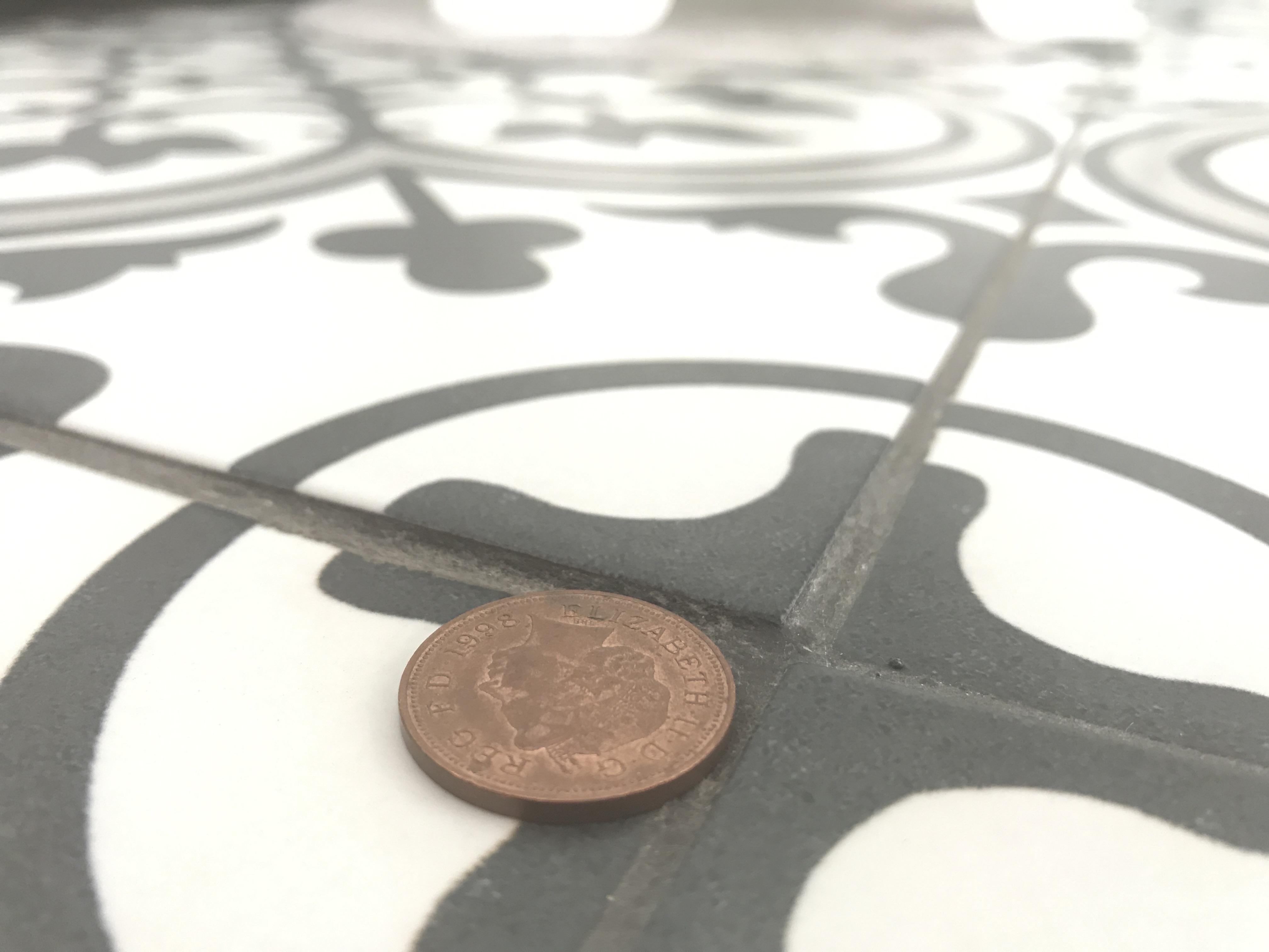

I posted yesterday about the poor job that has been made of our shower wall tiles. Since then I’ve become something of an expert on tiling (haha) and have another query regarding our floor tiles. The lippage seems excessive in areas. Photos of the worst area below. Is that acceptable?

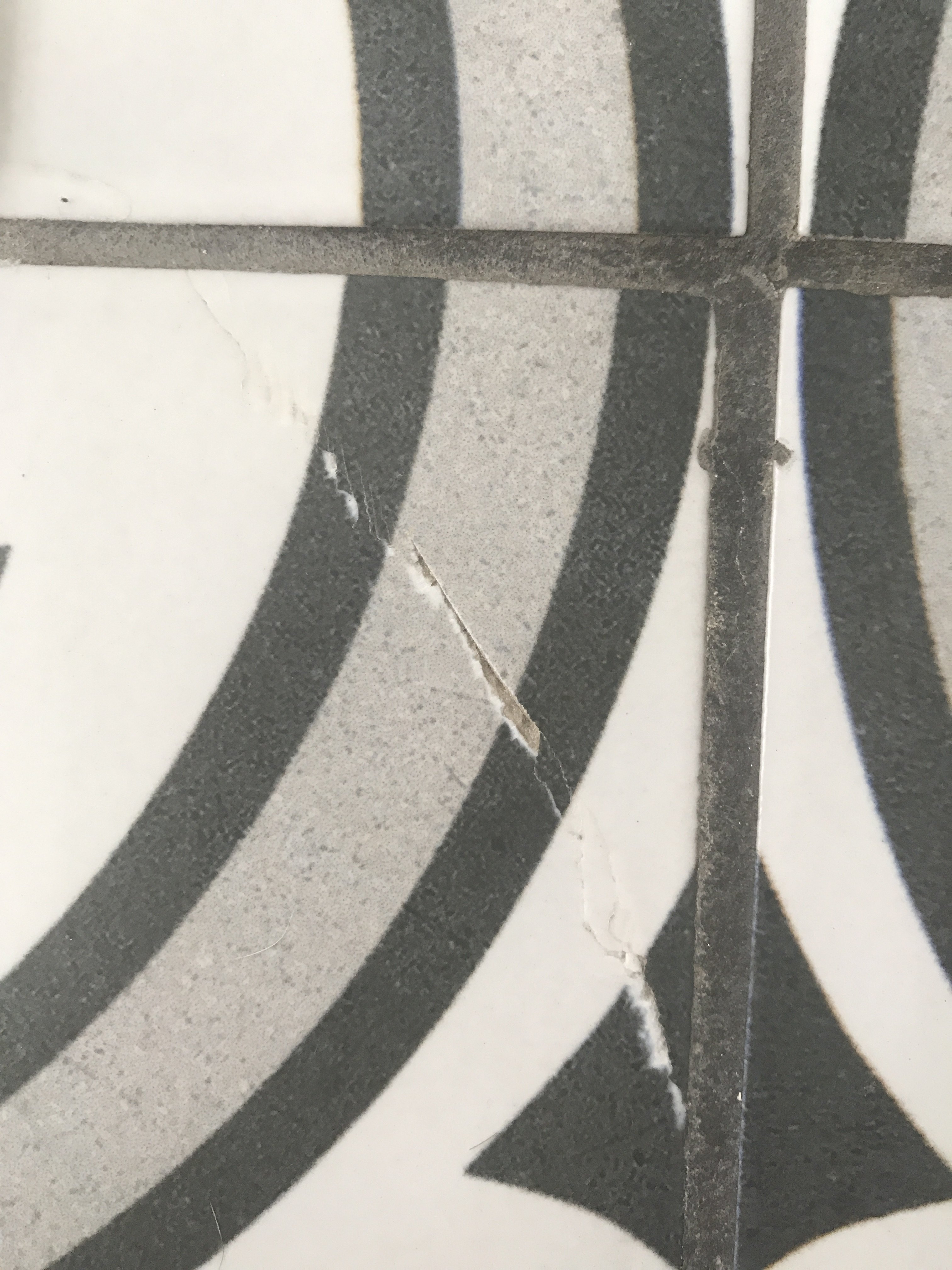

Further more this week I’ve found a cracked floor tile that definitely wasn’t there before. No one remembers dropping anything on the floor but it kind of looks like a blunt force from above so I am willing to accept it must be something we’ve done. However, given the poor job elsewhere there’s a slight concern this is due to the way the tiles have been laid?
Bathroom all 7 months old. Will include a picture of when the tiles were being laid.

I'm afraid it's atrocious. Both in method and finish

It's been spot fixed and fixed to ply. Should have been overboarded with cement board, levelled then tiled use a notched trowel.

Thankyou. I don’t think it’s been spot fixed, I remember them laying it and the whole floor was covered in stuff I think? That last picture is before they cut the tile for round the radiator pipes.
Could the fact it’s been fixed to ply have caused the crack?
Does that lippage look like it conforms to industry standards? Does any of it conform to industry standards?!
