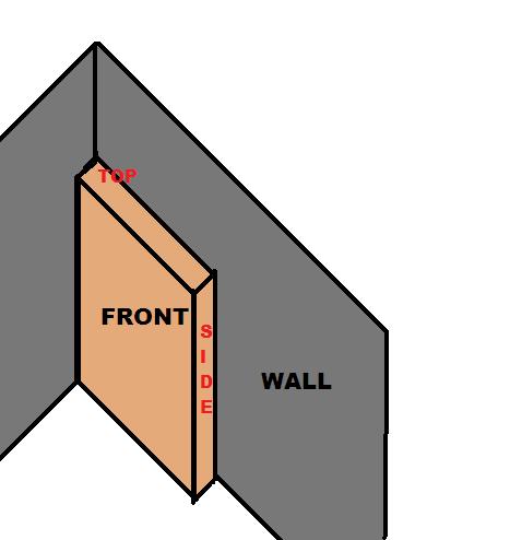

when you have a three way mitre on boxing in ( so you end up with a shelf essentially.. )
how do you tile, having cut the trim?..as in, which surface first?
I feel it would be the top(shelf)?
then place the trim along that edge and tile the front panel, place the trim between front and side panel
then tile the narrow side panel.
I am likely making zero sense, In which case apologise.
Have you set out? Once that's done I would personally go up the 'wall', side, front and then top ensuring grout joints are all in sync.... Don't know if it is correct method though just my 2p

I would go up the side as when you hit the top you will be bedding in 2 trims at the same time. What trim are you using as if it is box or quadrant you can buy corner pieces that sit inside the trim and make up the corner nicely so if you think you might struggle it may be a good option... Hope this helps
Front, side, top for me.

Ye, front side top for me too. The trick when using all trim (especially metal) is to make sure all tiles accepting the trim is on the same plane ( all flat along a straight edge) then insert trim after the tiles are on

tried tiling first then sliding the trim behind, not a chance.. what I did in the end was left the trim slightly out of final placement and slid it the final few mm last thing.
