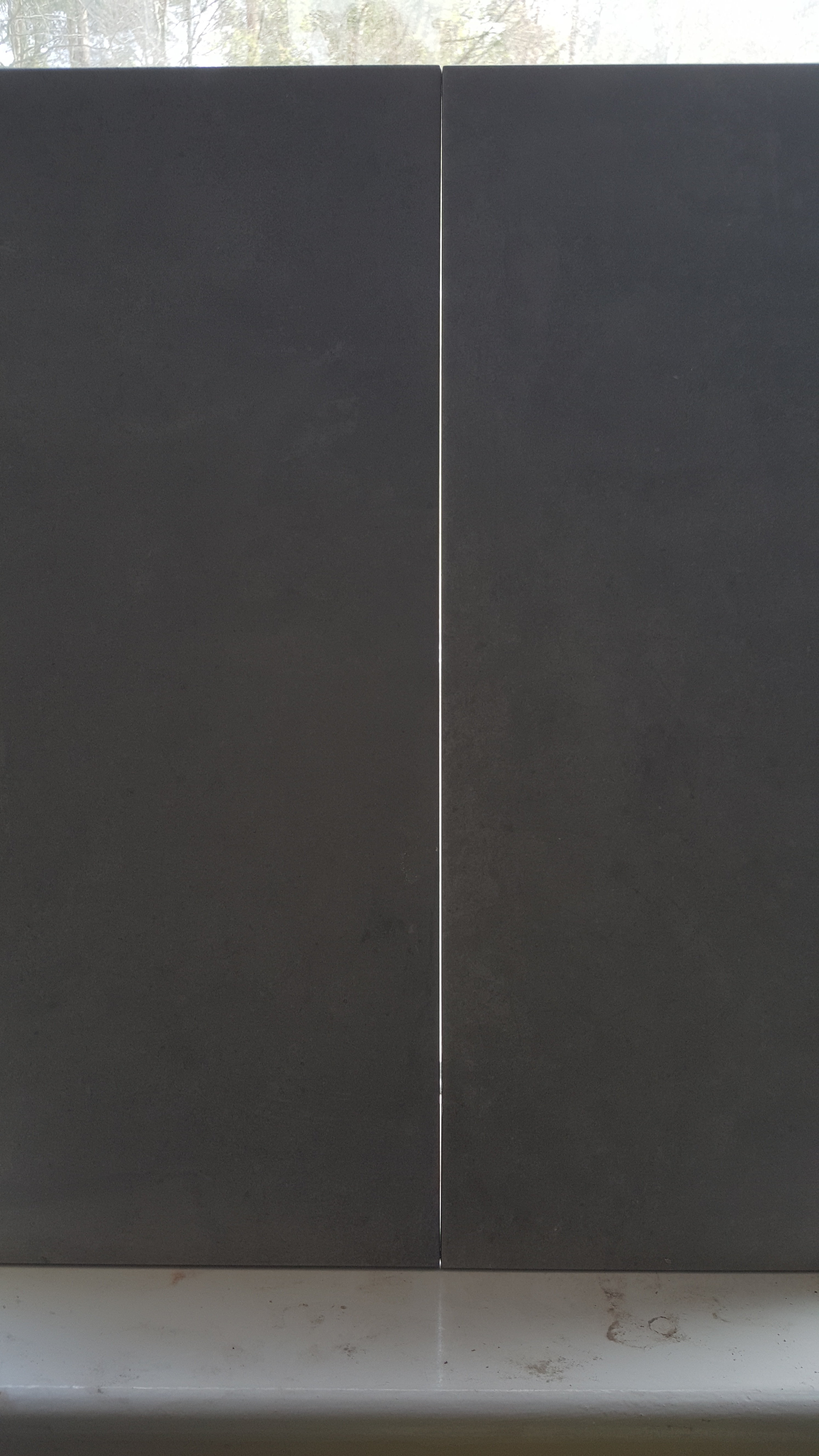

Well what a frustrating annoying week dealing with guys from topps tiles that sell tiles at extortionate prices that are just not up to scratch I pity the general public that purchase tiles and feel bitterly disappointed

Were the batch numbers the same? Why was it a mission trying to deal with the staff? Surely they'd have seen that and just took the tiles back and gone to their suppliers to complain.
If it was a mission dealing with them, I'm kinda thinking they were saying the batch labels are different maybe and them arguing that's down to the tiler?
Might be wrong.
Shocking if they're marked as the same batch! Because they are for sure not!
Variation
Without knowing the exact tiles the manufacturer may have produced these as a V2 V3 or V4
If these are classed as V1 then they have been supplied with different batch numbers
Were the tiles all bought at the same time ?
If the tiles were purchased at different times and you have not specified batch and caliber numbers then i could see how this could happen
If the tiles were purchased and collected at the same time then the stock at the shop has been all batched together
If the tiles had to be ordered in from supplier or Topps warehouse then the person picking the order they did not have enough stock to fulfil order from one batch so used what was available
I've had that loads of times from topps, one of the worst tile shops I've come across for this type of thing...
To be honest ive only had the shading problen once in all the years i have been using Topps ,its the prices of there materiels that i have a problem with

Last year my customer came back from Topps Portsmouth with 6 boxes of floor tiles. Upon checking the batch numbers I found 4 different batch numbers. The tiles were black and the differences were very obvious. I rang Topps and they said that this has happened because their policy states a customer can return unused boxes. Therefore, my 6 boxes were made up of customer returns. No apology. Customer took the boxes back and chose a different tile.
