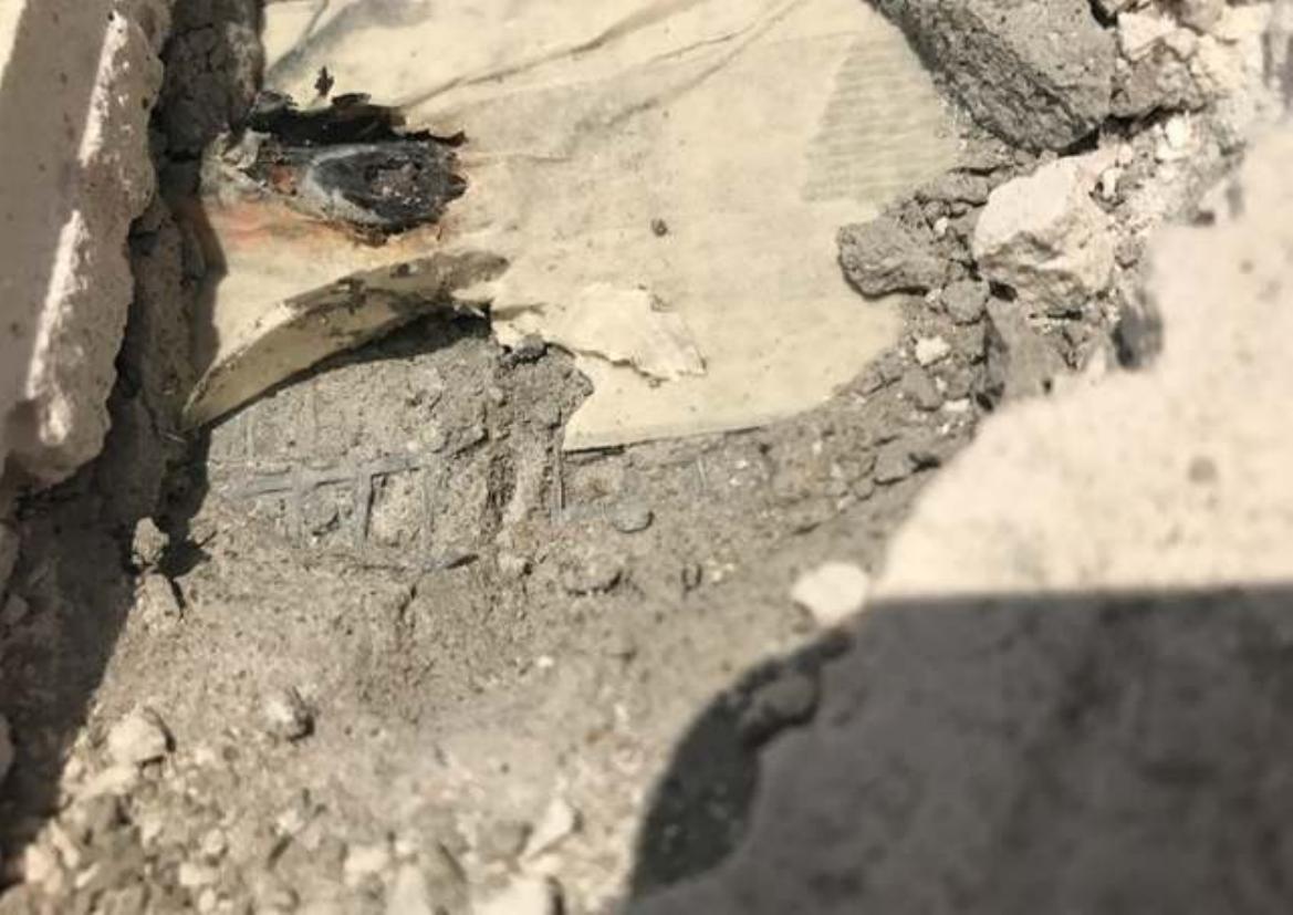

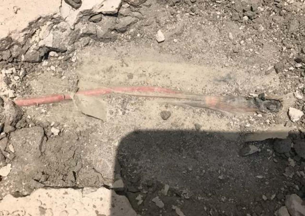

Thanks for your replies, the contractor is now threatening legal action if I don't pay the invoice. He has sent me the pics of the repair and honestly don't believe that by masking tape the termination joint it would burn out like that. The installation instructions actually say that any lose wires can be hot glue gunned or masking taped down. Anyway here is the pic

We'd never recommend to cover the joint in a masking tape or any tape as it can cause excessive heat in the joint. It could be that the joint was loose which has created heat and caused the cable to burn out as it isn't a secure connection. We always recommend to put our cold tails into a conduit and bury the conduit in a 15mm channel in the floor, before being self levelled.
