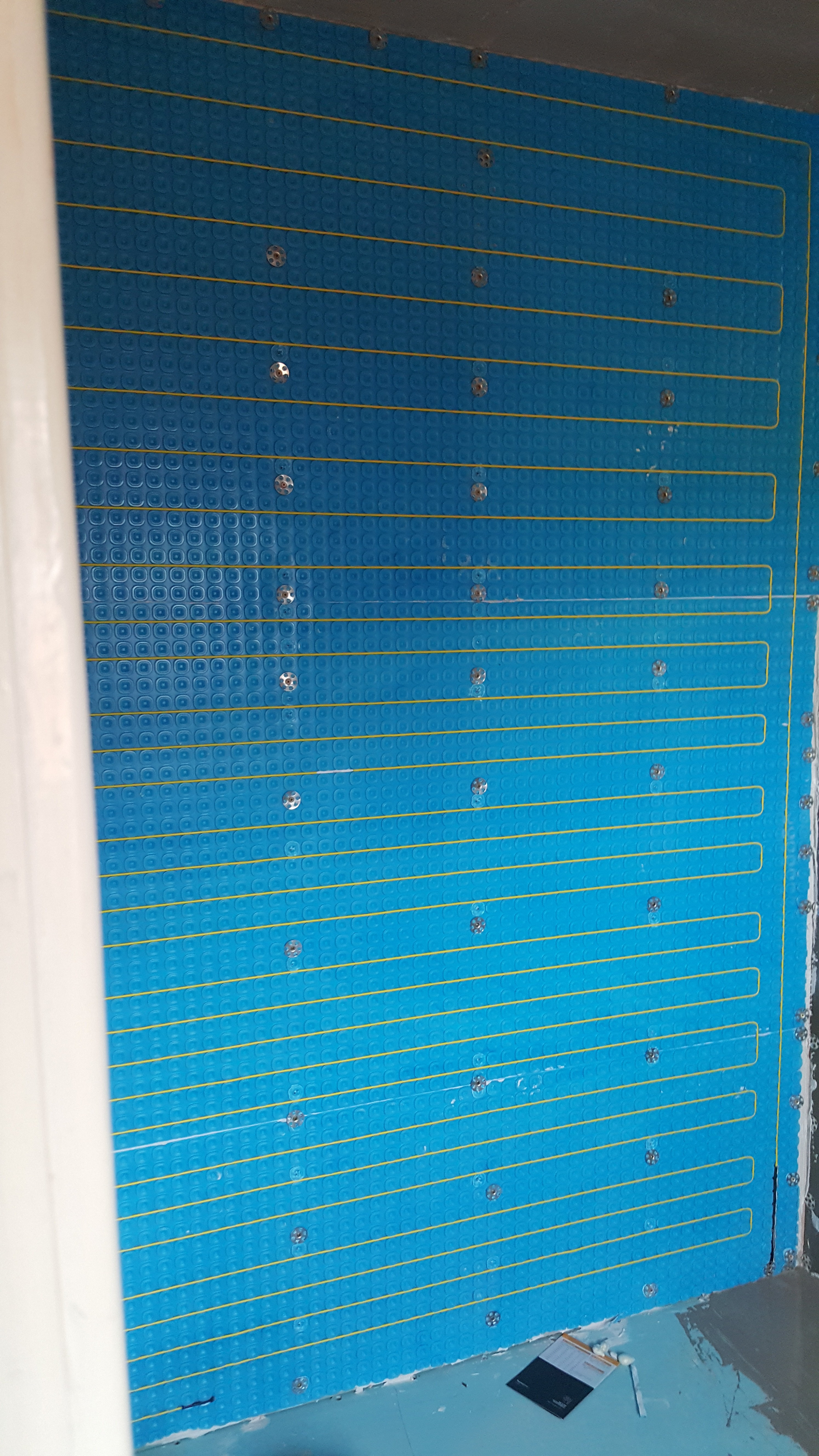

Have you ever fitted one on the walls @impish ?
Yes, but I shouldn't have.
I had WAY too much cable on a job (using Ditra Heat) and ran it onto a wall with spare matting.
I chased back into the wall to give a softer bend on the cable.
This was before I found out Schluter did it.
Not done any since...
Dumbo
Looking good. I am keen to do one, I have a job in the pipeline which I may try and incorporate. I saw on thermogroup Instagram page they had what looking like a regular mat version on a wall and they said it was for that purpose!
The membrane went up well and once you've done that your 3 parts there . Just got to figure how to turn the room on its side to latex it .

Sorry wasn't vary pro but another they sell. They like to experiment ! file copy.jpeg
Heated walls, great for oneupmanship with the neighbours and friends!
One of the benefits they try to push in a bathroom Andy is the lack of requirement for large imposing heated towel rails. With a heated wall you can hav just a slim towel rail tight to the wall and it does the same job.
