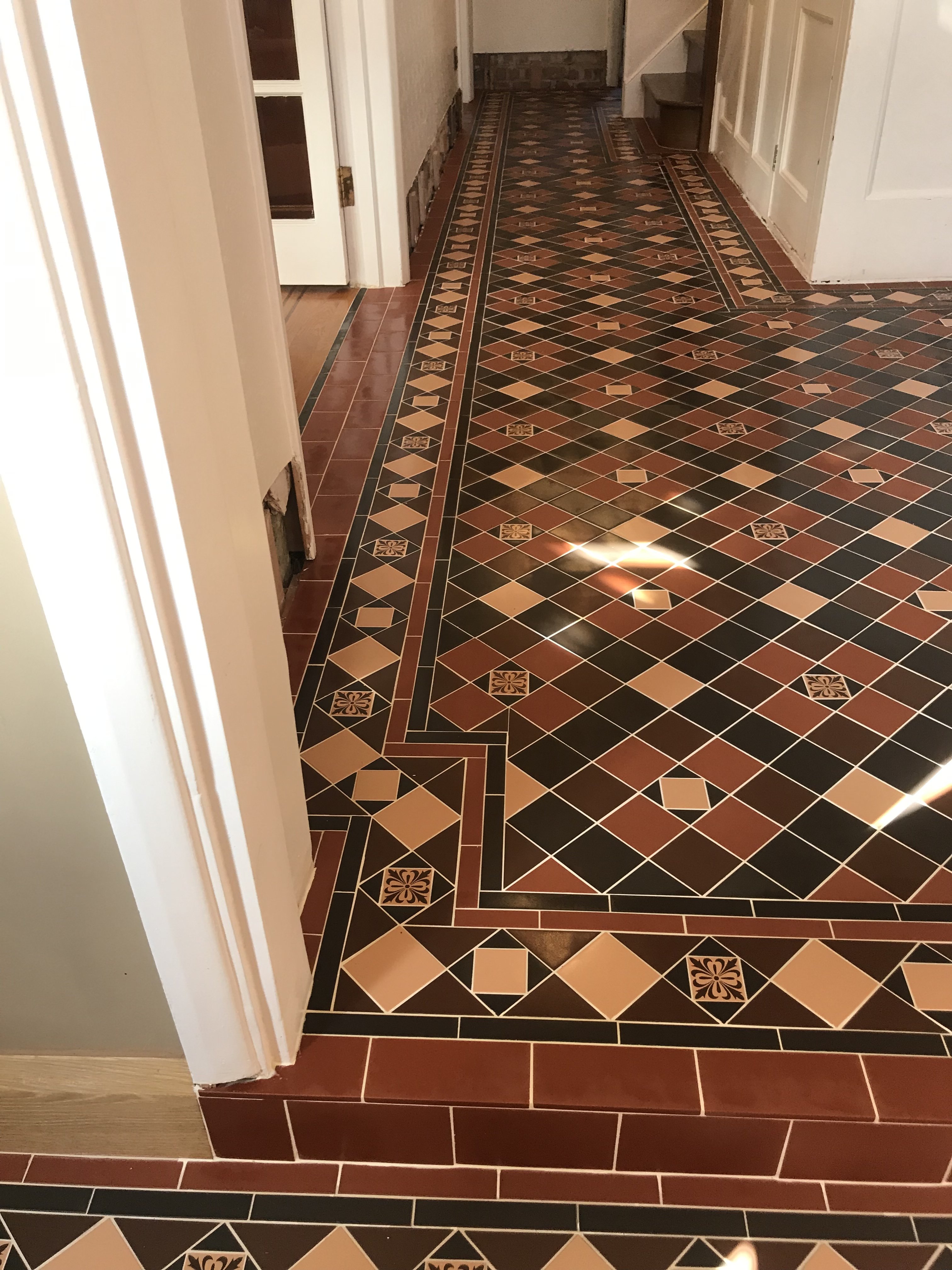

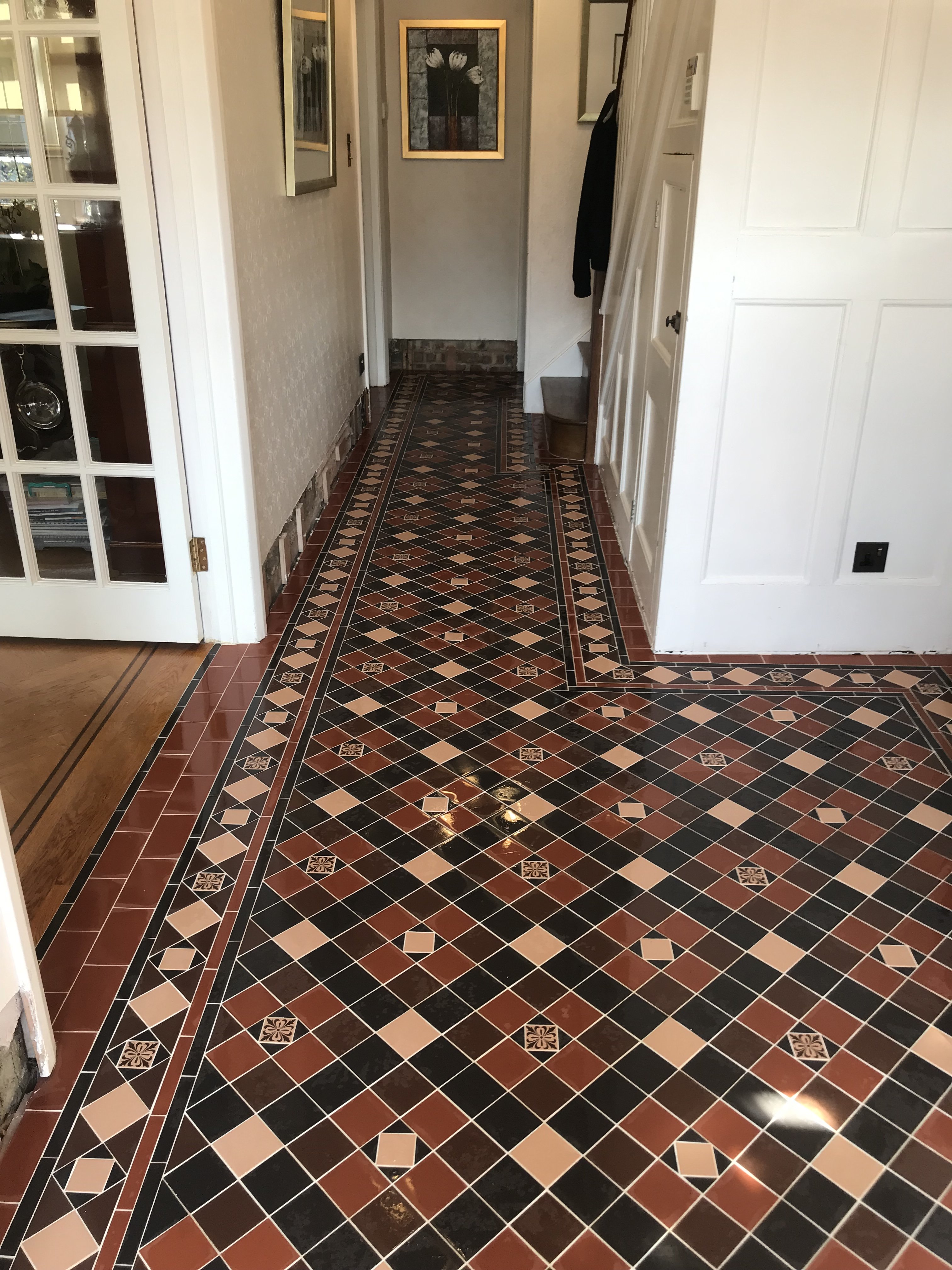

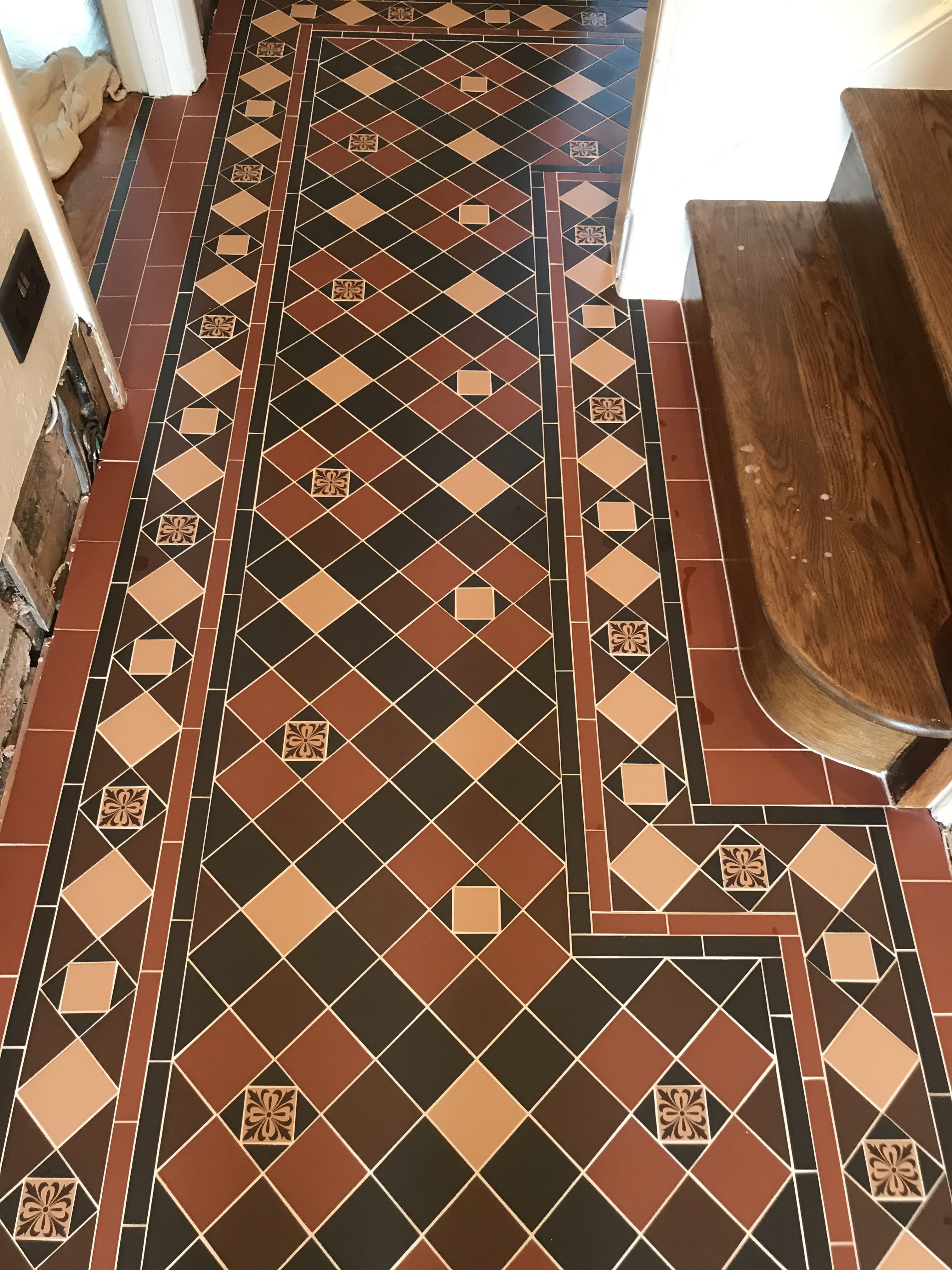

Hi, anyone done any original style flooring ? I’ve done a few but I always do my own layout and setting out. So just wondering how you other tilers do it Sid
A2222F7E-62B0-41B4-9F58-C95DF919ABEE.jpeg 0C0FD7E0-4473-49F5-8201-AC680467AD3F.jpeg 56A2164F-3C04-43F8-98DB-7695DB6BB67F.jpeg 6CFCBB6D-2FDB-402E-8B52-8C672AFAA935.jpeg Mainly do my own hand cut porcelain geometric designs but it’s usually easier just picking them out of boxes...

Everyone is individual - just start in the middle and work out - isn’t it!
I just get the customer to pick the field and border. I've had a original style cad before and they're pointless imo
Yes the customer picks field and border, but I still do drawing so I can show them how it will look and so I know where to start and finish. Also so I can count how many individual tiles they need
I don't think the drawings do the jobs justice. I imagine you triple check your measurements on the floor anyway? The drawings are a waste of time I think but each to their own and I imagine some customers like the effort
Yes I workout the size of the tiles and how many fit best in the area allowing for the boarder. Any discrepancies are taken up by the tile against the wall
