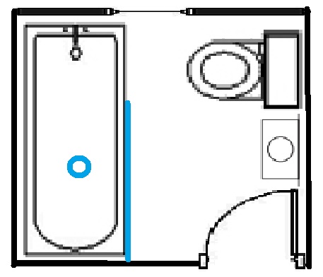

It's the full floor within a bathroom. It contains a bath with an overbath shower, though there would be a glass bath screen to prevent most water from the shower going onto the floor.
The diagram shows the bathroom layout, with the new marine ply floor would covering the full bathroom. The blue circle is the over-bath shower and the blue line is the glass bath screen.
