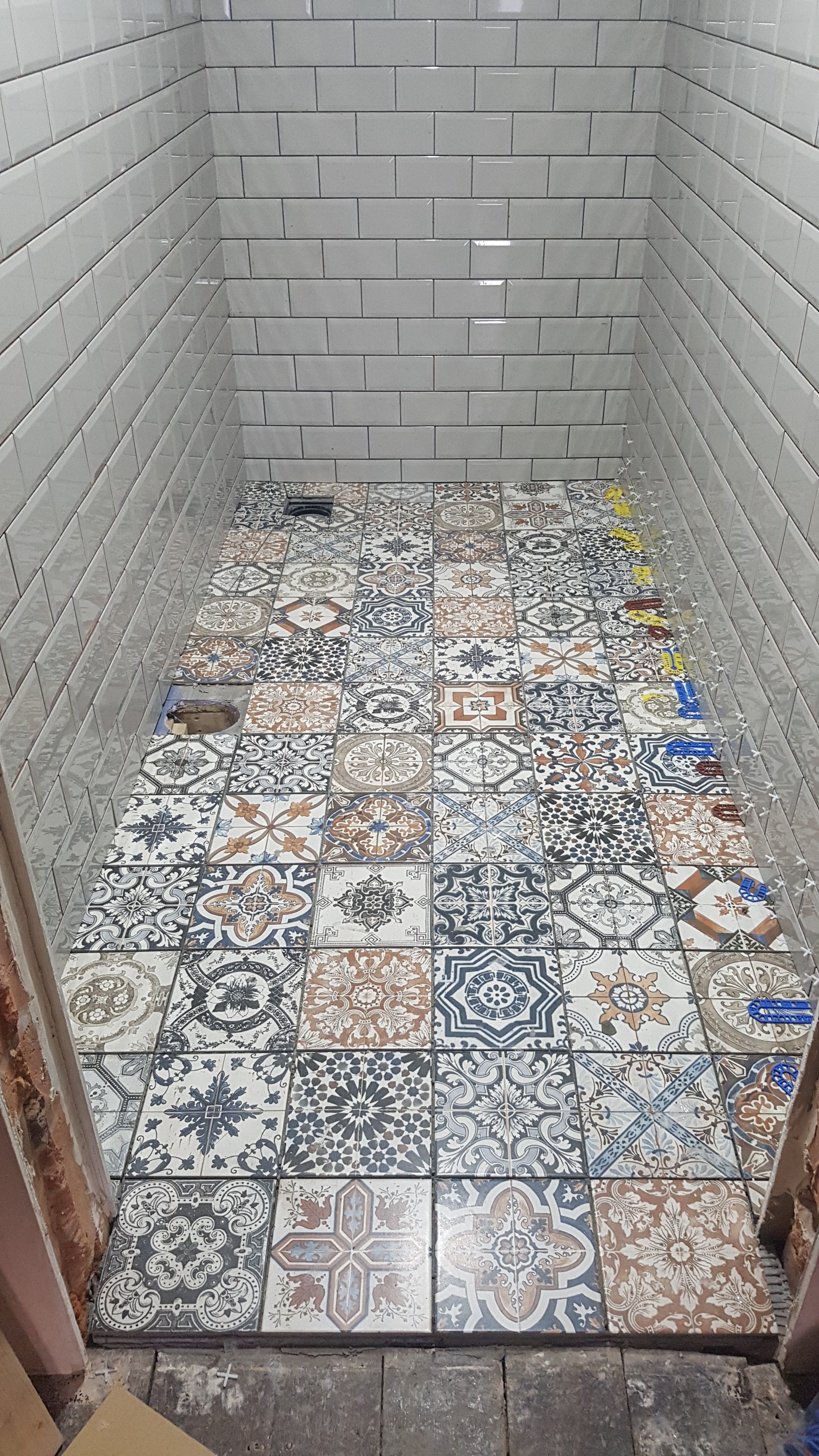

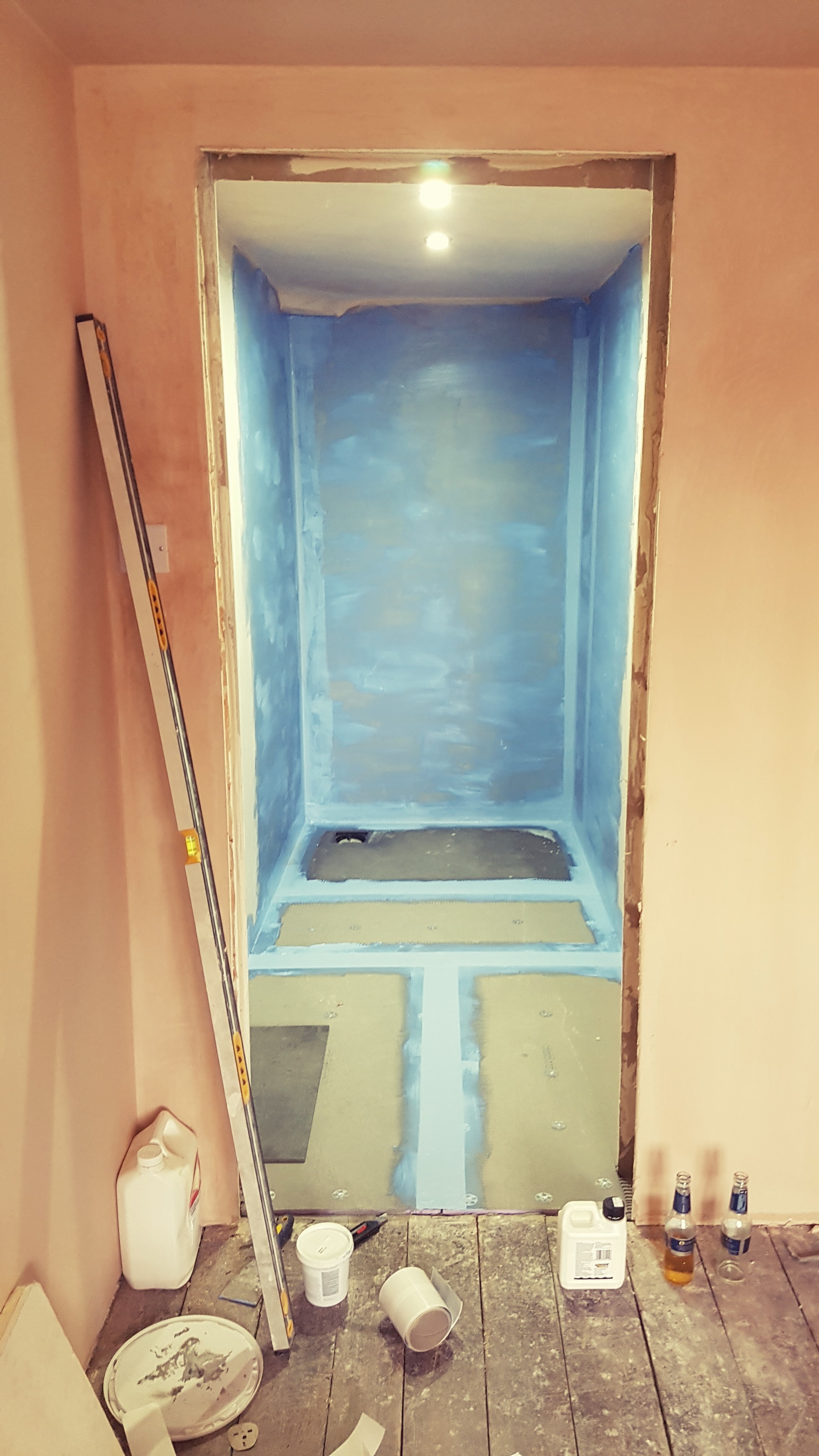

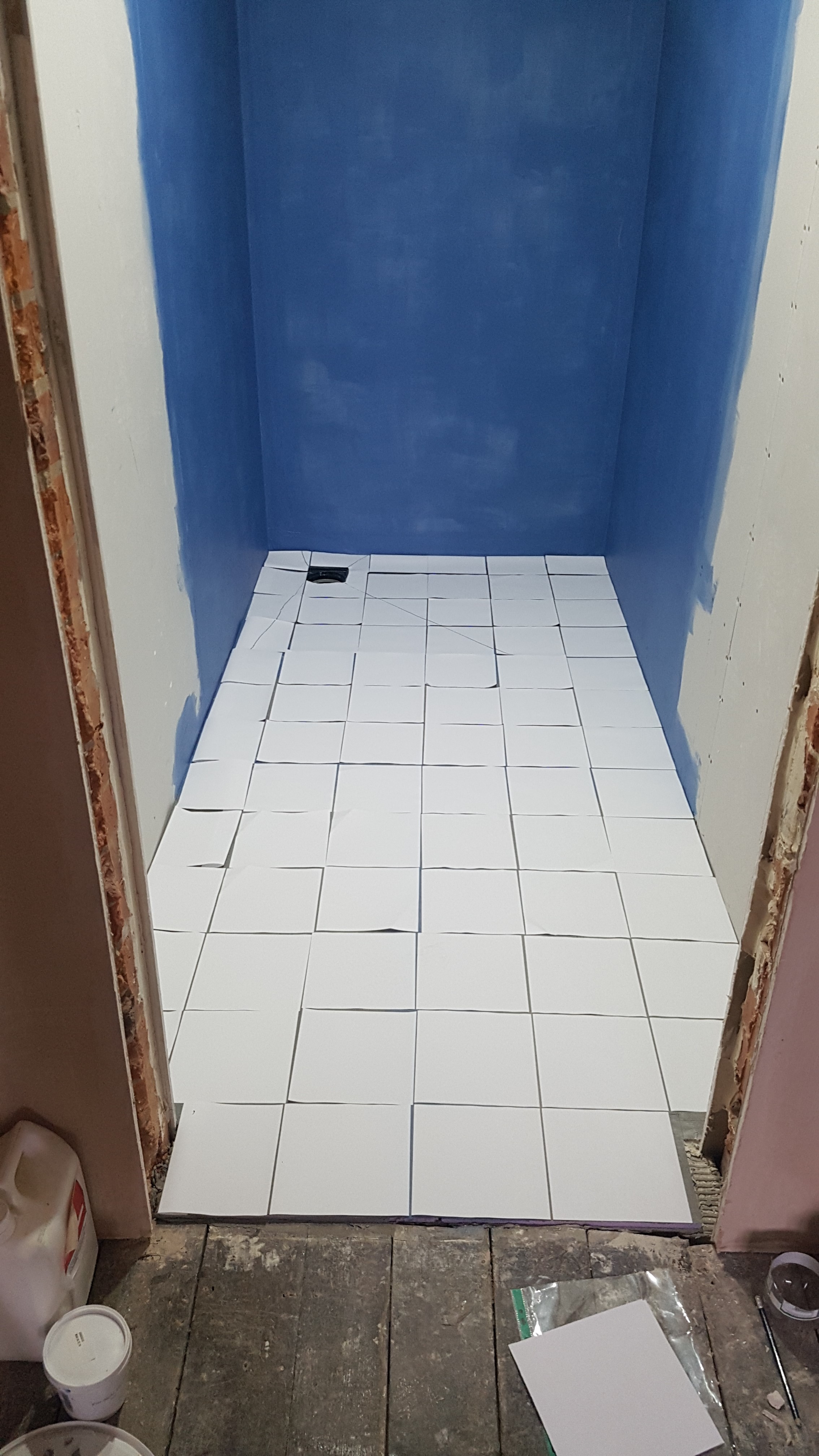

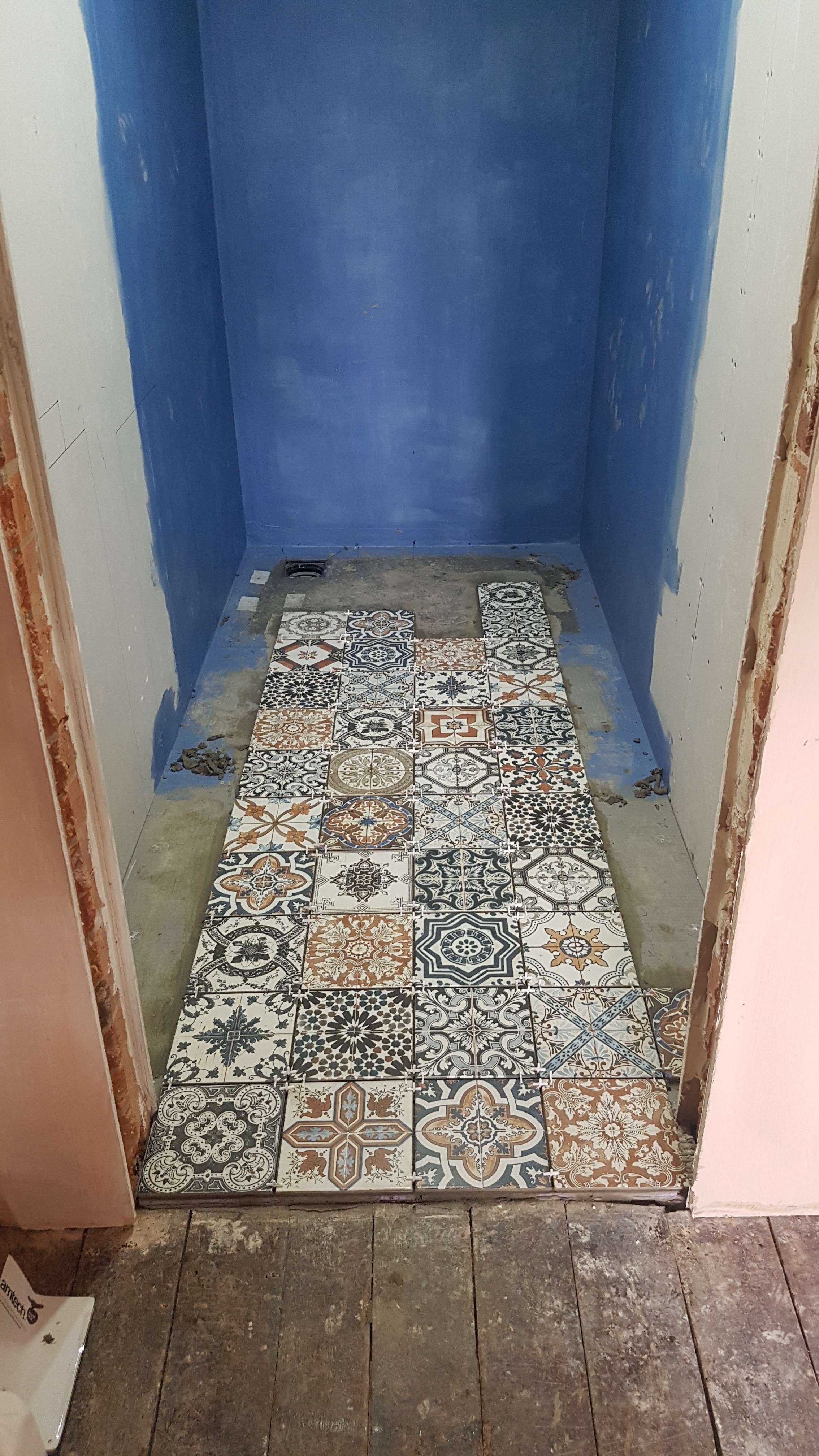

Im just about to start tiling my wet room ensuite. I think im ready to start the floor, but I have an adhesive question. I have cement boards on the floor on top of very solid supported chipboard. I don't really want to use a rapid set adhesive as I will be taking my time to ensure I get it right. The tiles are Vintage Hews from leekes, and have P1 stamped on the back.
Can anyone recommend a standard setting flexible tile adhesive for fixing porcelain tiles? Im also unsure what gap to leave at the wall transition, the wall will have a Metro style tile about 6m thick.
Im sure ill have plenty more questions! Thank for reading, pics below!

Sorry I did mean insulation boards. They are glued and screwed as per the reccomendations. Yes tiles are porcelain with a Matt finish so I believe they do not need sealing?

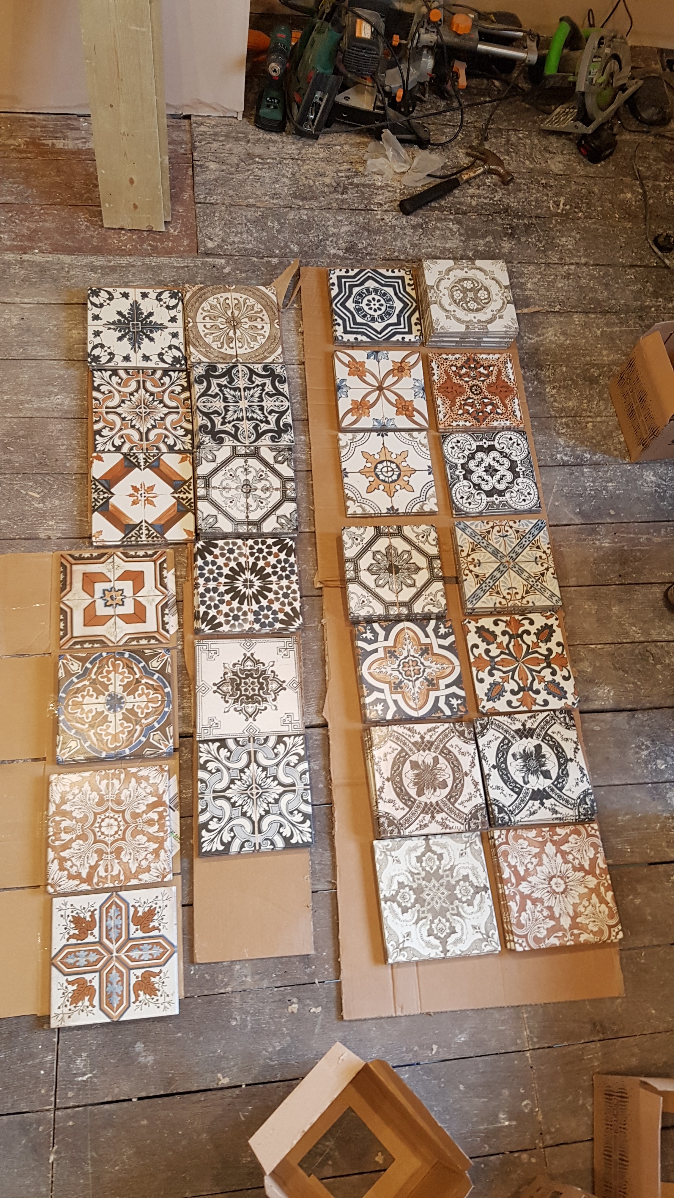

MY local Screwfix only has Mapai Rapid setting adhesive which I'm not keen on using purely as I want to get this right first time. I work in precision engineering so I know this is going to be a nightmare for me to accept the variations in tiles!!
MY local DIY shed has Unibond ultra flexible, is this a decent make of adhesive or shall I look else where?

I wouldn't use the unibond, you want a reputable brand such as tilemaster, Mapei, ultra or granfix is ok. Where do you live, there must be somewhere local
There are a few local but I'm aiming to pay the same price as my Local Screwfix for Mapei rapid set which is about £26 for 2 20kg bags. I love near place called Devizes.
