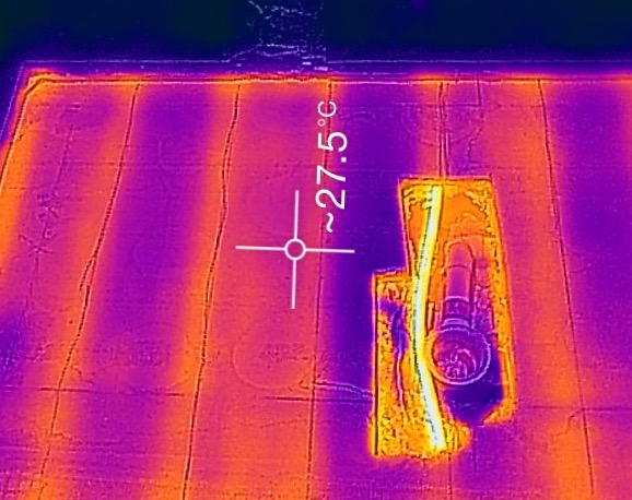

If you use a thermal imaging camera, you can sometimes pinpoint the leaking area, running shower cold would show up as a dark line.
And you could use it to make a plan of the UFH
Won't help you separate tile from floor without damage, but may give you a better chance of choosing an area to remove a tile.
