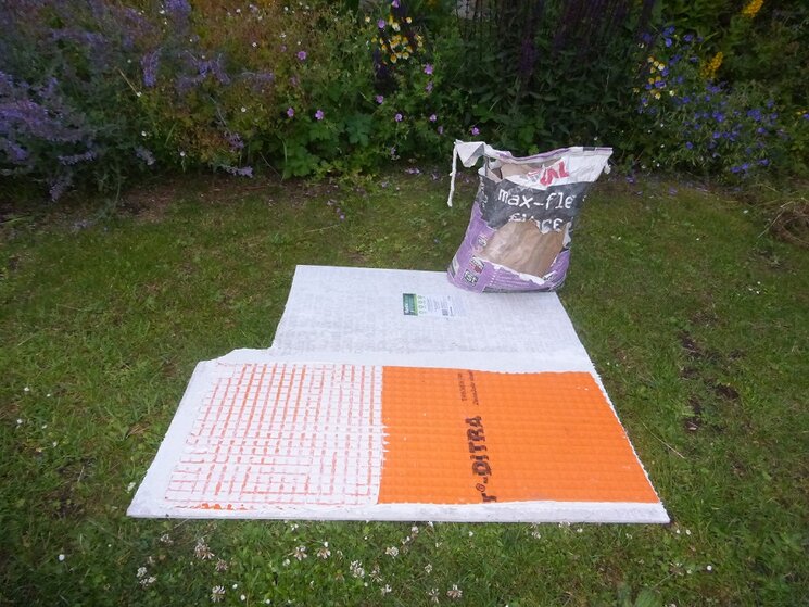

Picture to share.
Maybe pointless but anyway little test with some bits I had in the garage.
Ditra onto Hardiebacker then half the cavities filled with Bals fibre flex.
In a day or so will fit some mosaics onto the filled and unfilled ditra and then when cured see if there is any difference in the bond between the 2 when I try lifting them. Also able to form an opinion on pressure points and to see if the plastic crosses of the Ditra affect the tile.

Picture to share.
Can't wait for the outcome.
