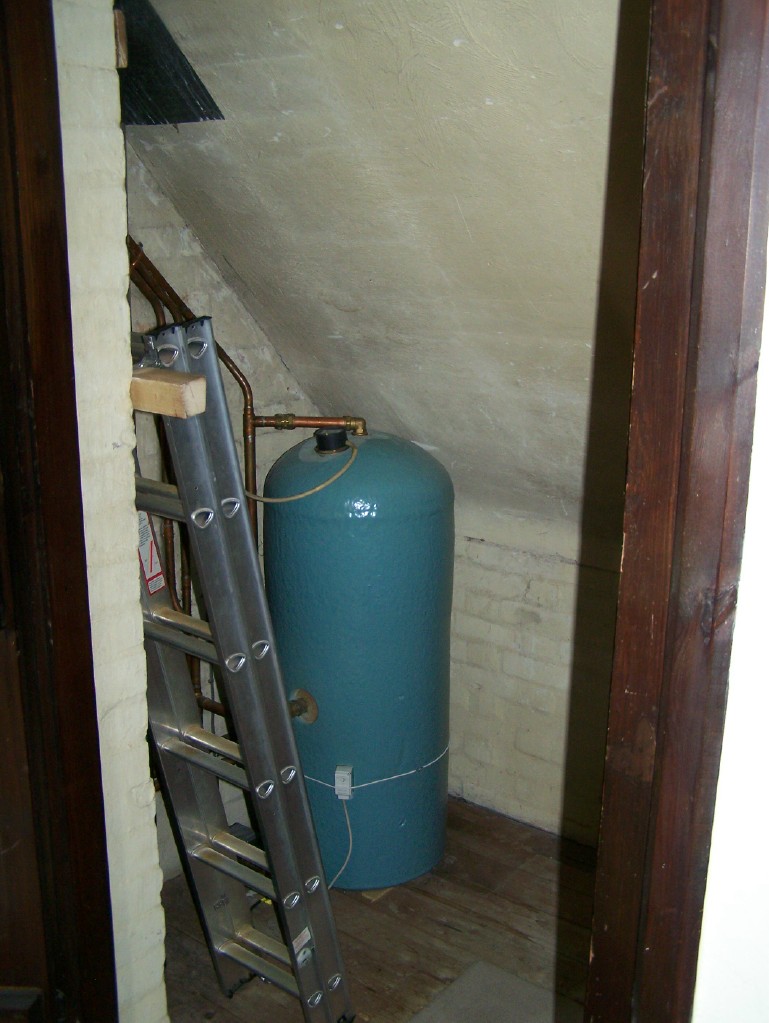

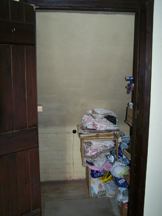

I've got a wetroom job to price up..you'll see from the photos it's a very small room with a sloping ceiling, which will have a velux window..
The whole room is to be the wetroom (no glass shower wall) and the tiled floor is to be sloped down towards the shower gulley..it will have a wall hung WC and basin so no worries about levelling them up on a sloping floor..all the walls and sloping ceiling are to be fully tiled..
I plan to use a tuff2 grp former tray, plywood the remaining floor boards, fit durabase wp over the ply and tray, lay ufh on the ply area (undecided about ufh on the tray), cover ufh with a either slc or flexi adhesive with a slope towards the tray..I also plan to fit durabase wp on the walls and sloping ceiling..
The floor tiles will be natural stone and I suspect natural stone mosaics on the walls and ceiling..
My main questions are...is durabase wp going to provide sufficient bond on the sloping ceiling? and is durabase wp on the floor going to provide sufficient uncoupling, given that it is a very small floor area?.. any other comments also welcome...

What is the ceiling construction..?
The ceiling is currently lathe/plaster but will be ripped down and replaced with a moisture resistant plasterboard..it can change if you think something else is more suitable...
Thought thats what it was in the pic..
Personally i would use a cement backerboard for added security...making sure plenty noggins and extra strengthening if needed... the truss's need to able to support the extra weight.

Yes on both counts.
The Dura-WP tanking membrane will uncouple the floor for you up to around 8m2 providing its not a heavy traffic area such as a kitchen etc. To use the floor should be either over boarded with 10/12mm ply wood screwed at 300 centres or renewed with 22/25mm ply fixed the same.
On the ceiling, board out with 12.5 pb and fix Dura-WP membrane before tiling or go Dave's way. Your call on that one we cant see it or know what you are going to find :smilewinkgrin:
