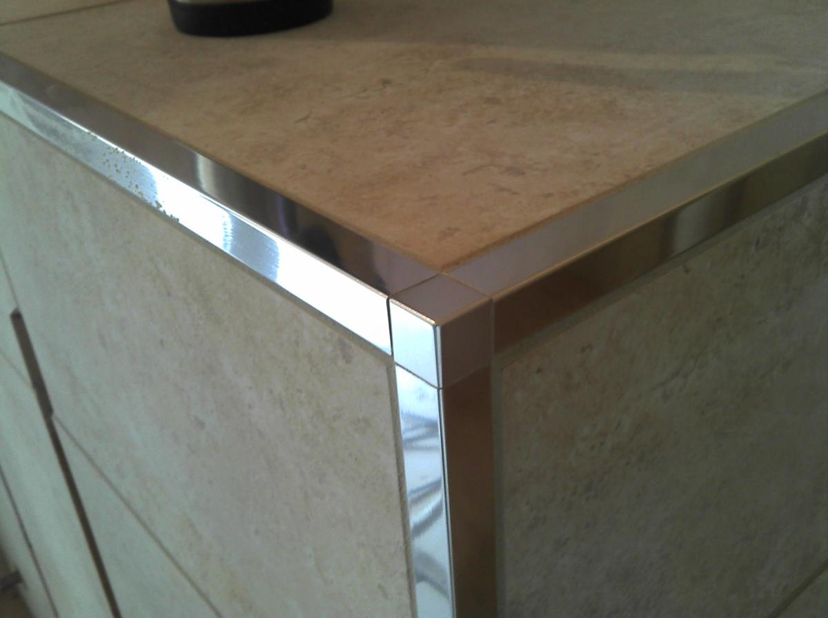

Try not to use plastic these days. Polished or satin metal looks quality and use square blocks for internal/external corners. Customers love them 2011-02-10_13-45-34_975.jpg

i have to agree that it doesnt look that great on the ends if their exposed. what way do you end on the top of a bath or shower tray
