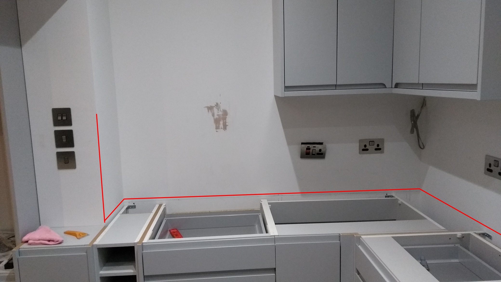

I'm panicking a bit now as I have a length of this, from Genesis, please see attached. Do I not bother using it in the internal corners? Shall I mitre the tiles instead in the corners?
Also, this is the external corner trim I have.
Shall I use that instead in all corners, both internal and external then?
I crossed out the wall on my atachment as that doesn't apply in my case, I will move the profile slightly to the right to sit flush with the left wall, if you see what I mean.
DIY gets me excited but when a pro says you doing wrong I start panicking! 🙁
So with metros. Pick the centre of your main wall. Usually a cooker hood area. But in your case it’s a sink. If that is centred between the two wall units then find the center of that. Tile from that line off the counter top.
I'd say 99% of metro jobs done by professional or diy get the tiles butted up in the internal corners same as any other internal tile corner and siliconed after.
Great thanks. Mate is coming round on Friday to help fit the worktops, the base units are all level.
Do I need to batten, from the starting point, I am guessing no?
