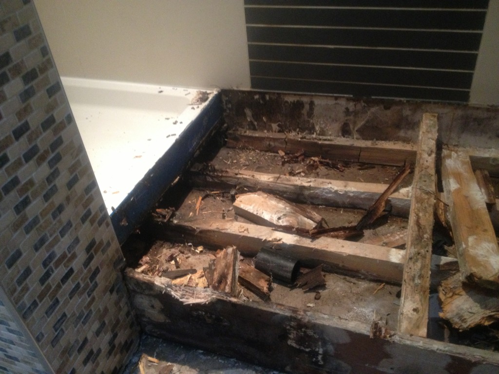

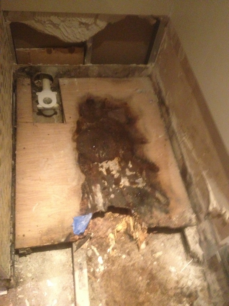

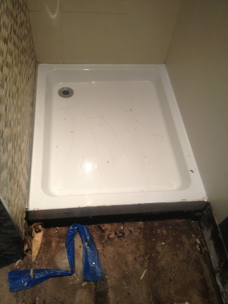

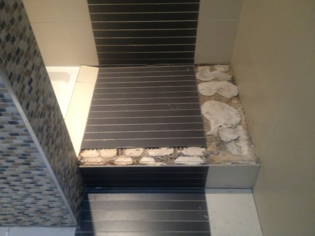

ok im on a job at the mo, 4 bathrooms 3mtrs max each floor ive ripped up the old tiles to reveal a gypsum floor! theyve got showers in these rooms that ive also ripped out cos theyve been leaking and rotten all the timber under the trays,they must have been leaking for 3years since they were built??
these floors are 60mm thick and wet through!!!! ive already been waiting 7 weeks for them to dry out and ive got heaters on them aswell. dont mind cos ive got plenty of work..but the hotel is now getting impatient cos they are loosing loads with the rooms being out of action.been over there today with my tramex damp tester and they are still slightly damp....so they said to me today we cant afford for the rooms to be out of action any longer!and if there not dry by monday just tile them damp or not(me i cant if there not dry enough,because if it fails its down to me)hotel we,ll sign anything you want to cover you if it fails saying its down to us. we,ll pay you to come and do it again!!!!! never thought i would be in this situation.. anyone know of a way to dry these floors any quick smart?? :mad2:
cheers..

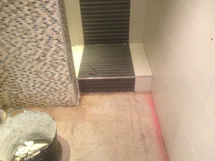

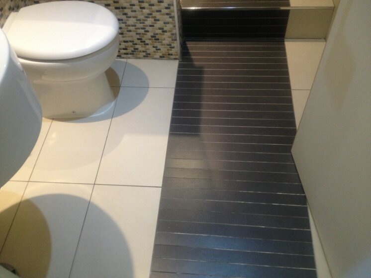

ImageUploadedByTapatalk1365536905.671200.jpg ImageUploadedByTapatalk1365536930.433279.jpg ImageUploadedByTapatalk1365536947.957475.jpg ImageUploadedByTapatalk1365536963.557207.jpg ImageUploadedByTapatalk1365536985.569396.jpg ImageUploadedByTapatalk1365536999.445530.jpg ImageUploadedByTapatalk1365537012.274587.jpg
Here's a few piccs!!

You need to measure moisture in anhydrite over 48 hrs.. a simple touch substrate meter does not read at the base IMO..
If cement screed gets wet it can be fine to tile when some damp is within it and use a vapour membrane but anhydrite you have the issue of sulphate migration Andy..
Have you tried a simple sweat test..?
I know it's damp though Dave,you can see it! Most of the floor is bone dry but there's a patch right near the door that's staying damp! and I can't tile until its all dry?. Grrr
