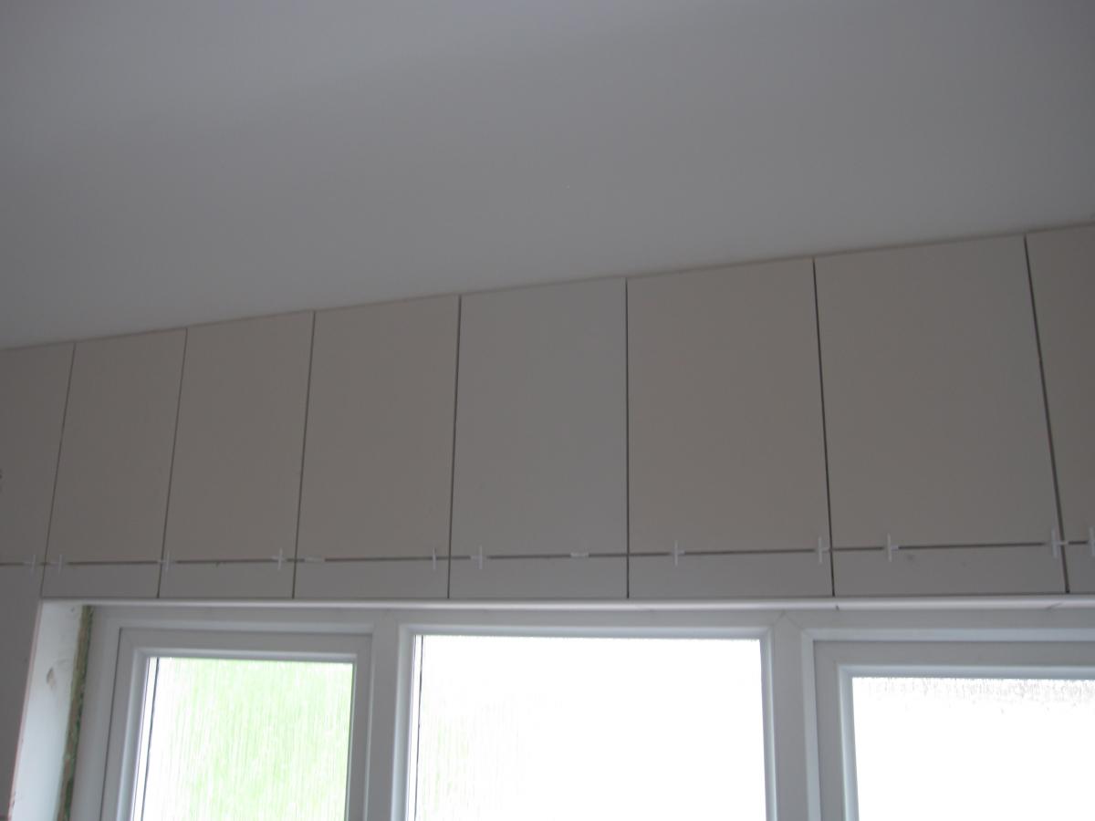

I have a major problem. My tiler has put tiles on my bathroom wall:
FIRST SESSION: 2 walls around bath
SECOND SESSION: rest of the room
Towards the end of the second session the tiles put above my window are substancially different in colour (pictures don't show it as obviously as real life)
The tiler has said he only noticed this once they were up and he stopped straight away and phoned me at work to come home. On viewing, I agreed that we had a problem. We then both started picking out more subtle but still quite different tiles on the walls that had been tiled during the first session (2 days earlier). This had not been apparent previously. I estimate that around 4-6 tiles on each wall are noticeably different.
We left the tiles up and tiler took an off cut of the different tiles to the retailer. Their desk immediately acknowledged the problem and agreed to look into it. The manufacturers rep was also in the shop and acknowledged the fault. On close inspection the offending tiles look like the inverse of the correct tiles. The correct tiles have raised very small white dimples with what looks like a more peachy coloured groove running between them. The faulty ones have a peachy dimple with white grooves.
Anyway, a week down the line and manufacturer has agreed with retailer to provide a colour matched run of tiles based on a sample we sent to them. I’m happy with this.
However the retailer is claiming no responsibility as they say the tiler should have checked every tile for shading before fixing to wall. They even said he should have laid out all 20m of tiles on floor prior to fixing. I have stated that both myself and tiler carried out reasonable checks – all batch numbers were identical, a broad check of a sample of the tiles appeared the same colour. I know the tiler would check this where possible – he recently tiled our kitchen and laid out all tiles before cutting and fixing and asked us if we were happy with them. Also, many of tiles look fine on initial check – it’s only when you step back and see them all together that you start to pick out the problem tiles.
I believe the tiler carried out reasonable checks (1 or 2 tiles per box of 10, which is certainly more rigorous than retailers QA process) and stopped fixing as soon as fault became apparent. As a result I believe responsibility lies with the retailer for providing the faulty tile and are therefore also liable for “consequential losses” i.e. cost of removal, making walls good and re-tiling.
I have written to retailer asking for them to cover the consequential losses but they have phoned blaming the tiler and citing a lot of clauses on the back of their invoice saying they are not responsible. :mad2:

just looking at the pics seems to be a lot of difference in the tiles

@jay: the pictures I've put up are the most obvious runs. Can't be certain why it wasn't picked up earlier but tiler says that he had couple of boxes in bathroom and fixed the pipe chase and above window - becuase he was close to tiles when fixing the difference wasn't as obvious - only when he went to get an additional box from downstairs did he come back in and notice.
Having not tiled myself I'm not entirely sure if this is plausible, but have used tiler many times and he has always highlighted small issues and checked with us before fixing so no reason to think he was just hoping we'd not notice. He didn't finish the window and asked me to come round and look rather than continuing so I think he's honest enough. Also, in some light it just doesn't look as bad (although it is always noticeable)
On the other walls the difference is more subtle but once you're eye is tuned in from the window wall, you can pick them out easily on the others.

I see the point about the tiler - as mentioned to Jay it was that run of 10-15 tiles that is most notcieable. on other walls we didn't notice it originally after the session, but now it seems quite blatant to us.
