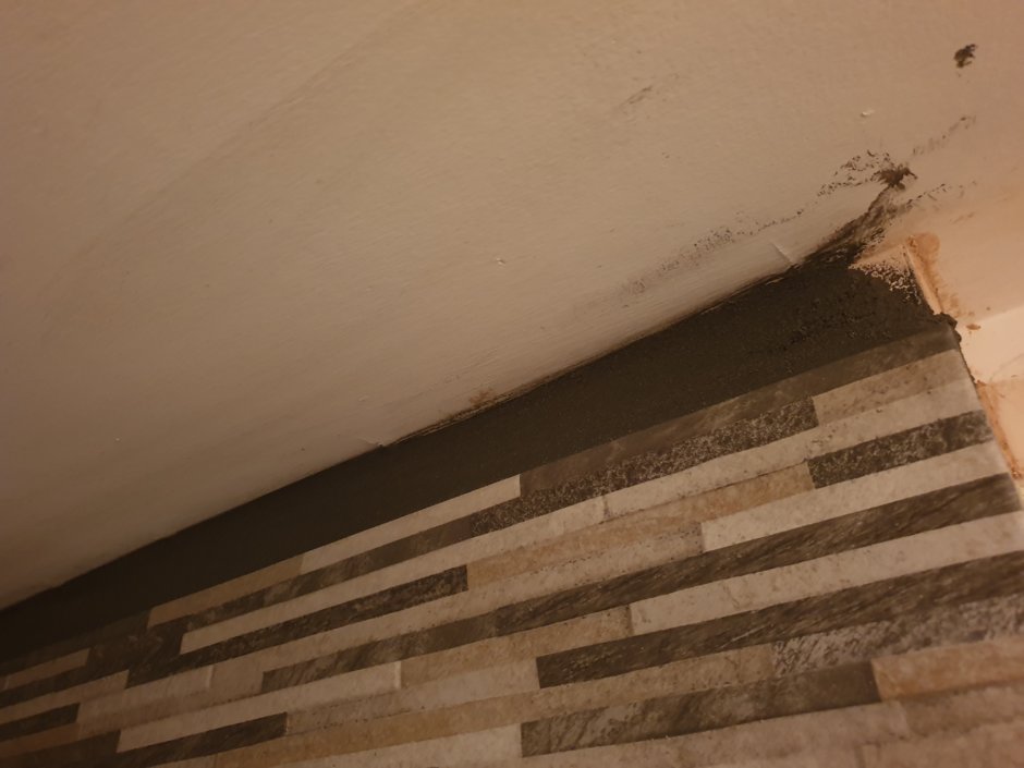

He’s also left a gap of about 50mm at the top where the wall tiles meet the ceiling which he’s filled in with grout. I think it looks pretty awful, but was wondering if this is normal?

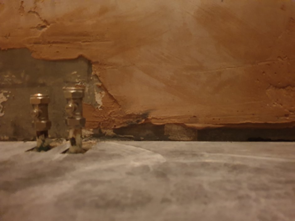

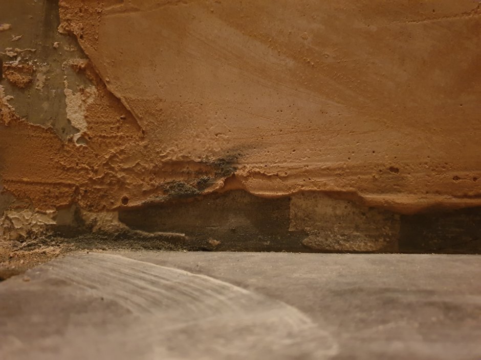

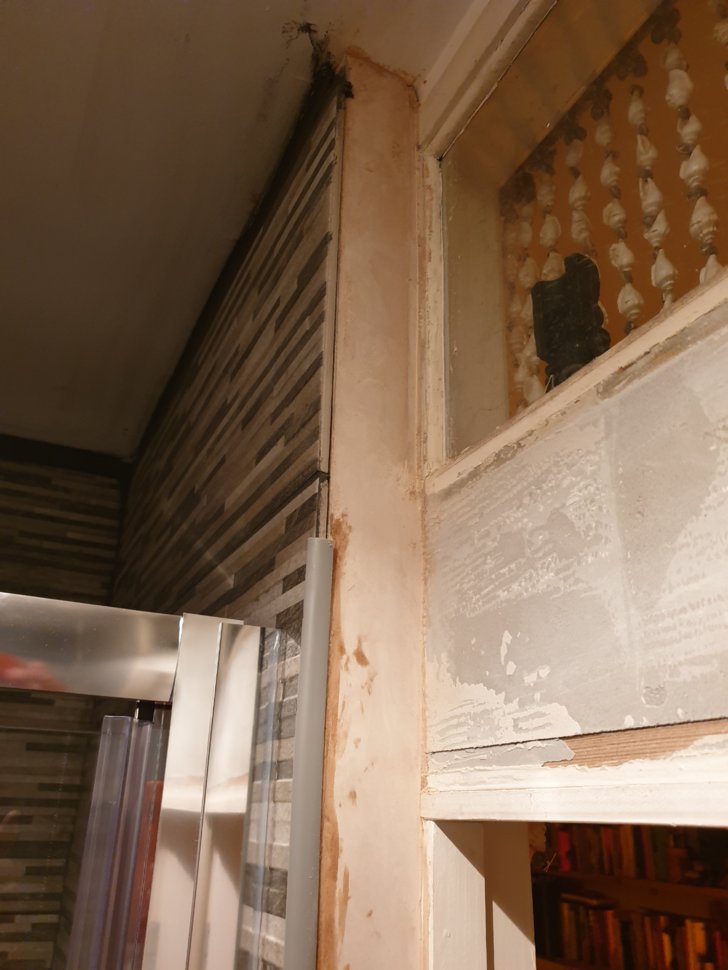

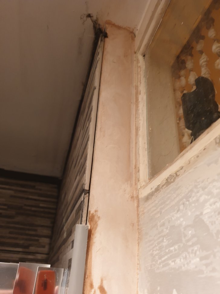

Thanks everyone. I've got a picture of the area - plus the edging (he didn't put an edging strip in when he did the tiling so the plumber tried to squeeze one in after the tiling was finished). This also shows how he's left the top of the tiles and how he's finished some of tbe plastering. His view is that the job is finished.

The 50 mm gap at the top should have a cut tile put in .

Yeah, that’s what I thought. Does anyone have any ideas for what could be done with the edging, where he didn’t bother to put any trim in? (2nd and 3rd pictures). It’s really noticeable and the trim the plumber glued in looks like a bodge.

As stated above a trim could be inserted. But to be honest why should you have to do it? The original tiler should be held to account, I'd never expect a customer or plumber to tidy up or rectify my mistakes. And no real excuse for the gap by the ceiling a 50mm cut could still be scored and snapped from split face porcelain. Sorry if I'm not sounding festive.
