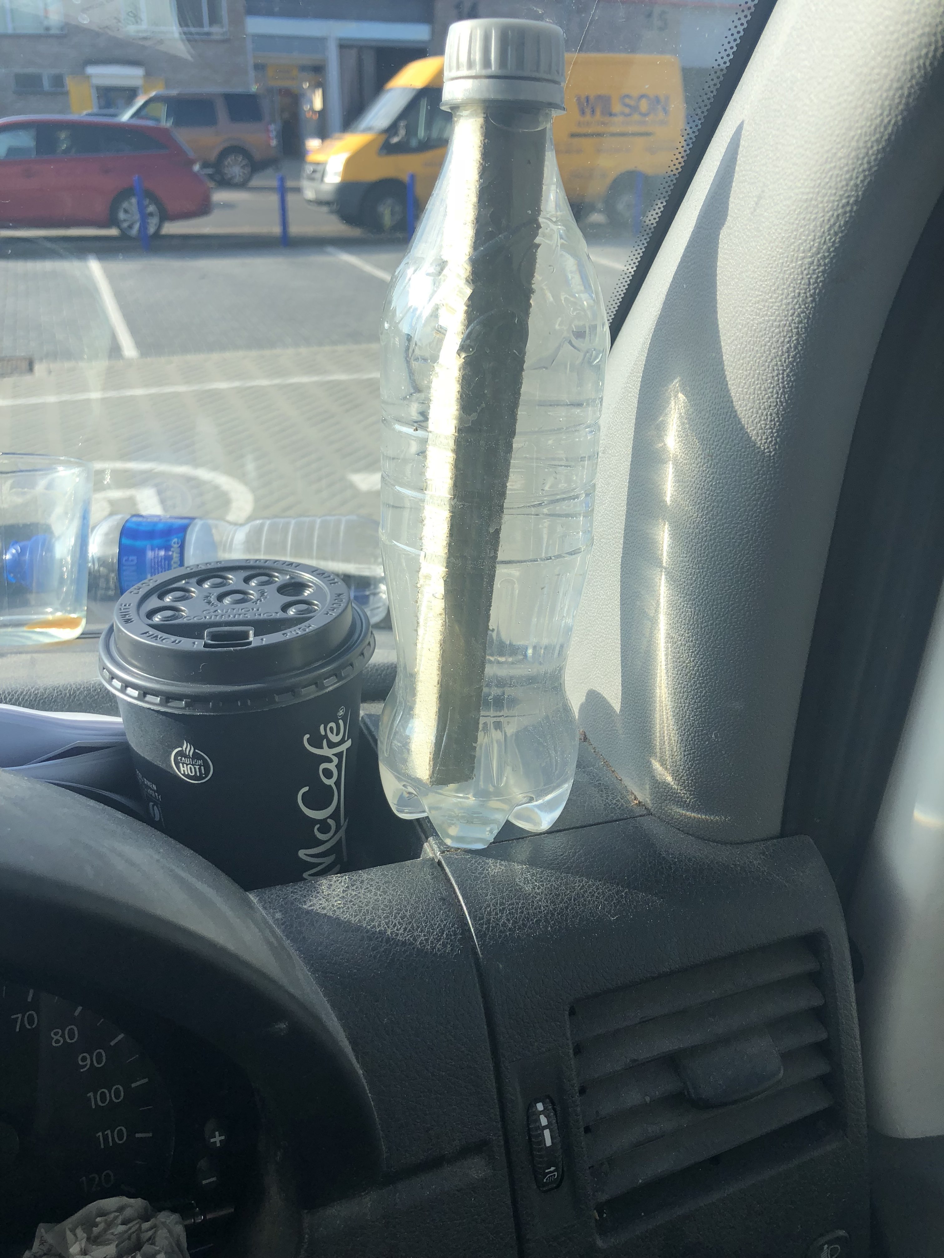

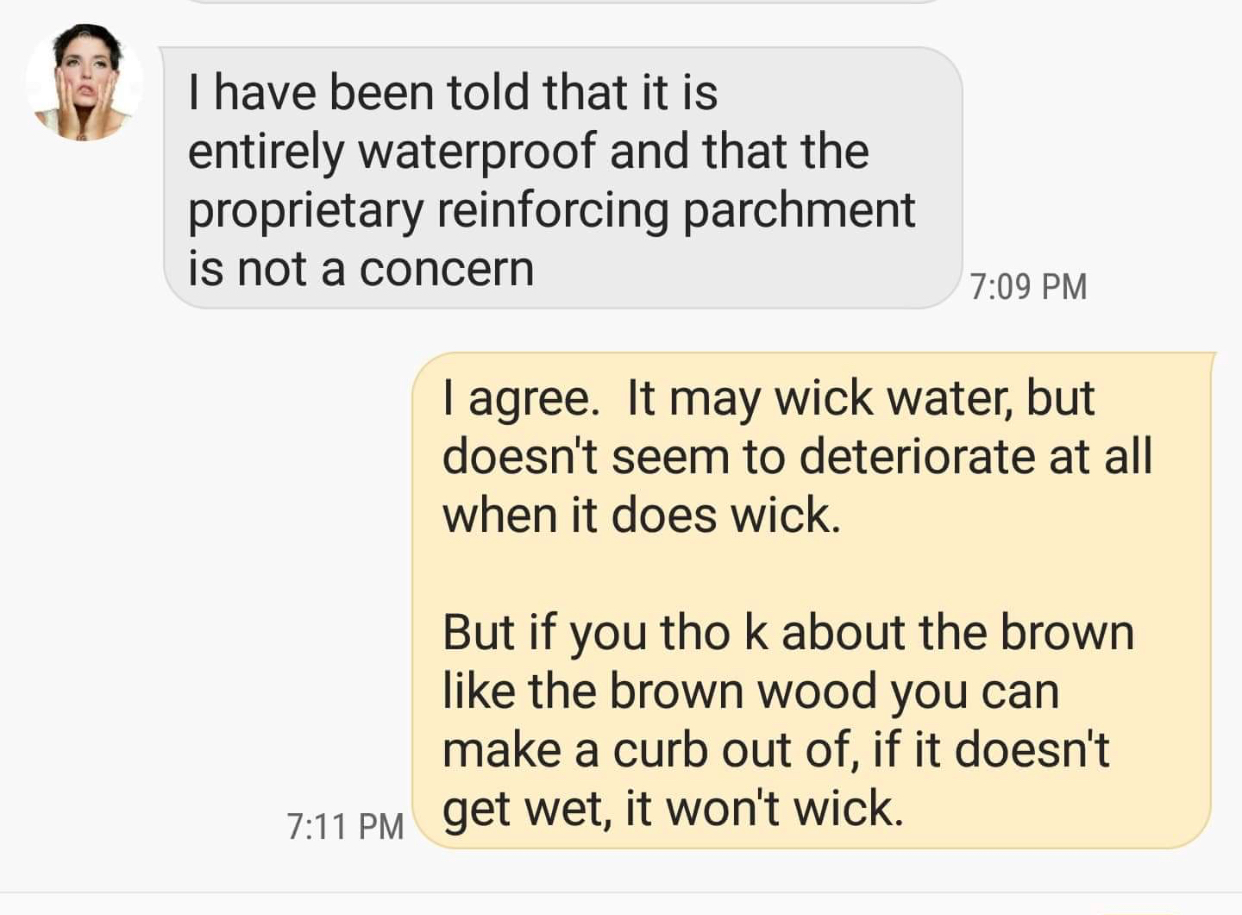

What we need is a tile backer board that cuts as easily as a foam board, is waterproof like a foam board yet comes in decent sizes. Even 1800 x 900 would be good but the board needs to have a bit more rigidity than the foam and must be able to be dabbed onto the wall with dry wall adhesive.
Hopefully I’m not asking for too much......:kissingclosed:
I’ve seen it at bal HQ on a training day, basically another version of hardie backer I think. But cuts easier.
Waluigi
“Water and Mould resistant”
Waterproof please if it’s on walls. Otherwise it’s pointless.
