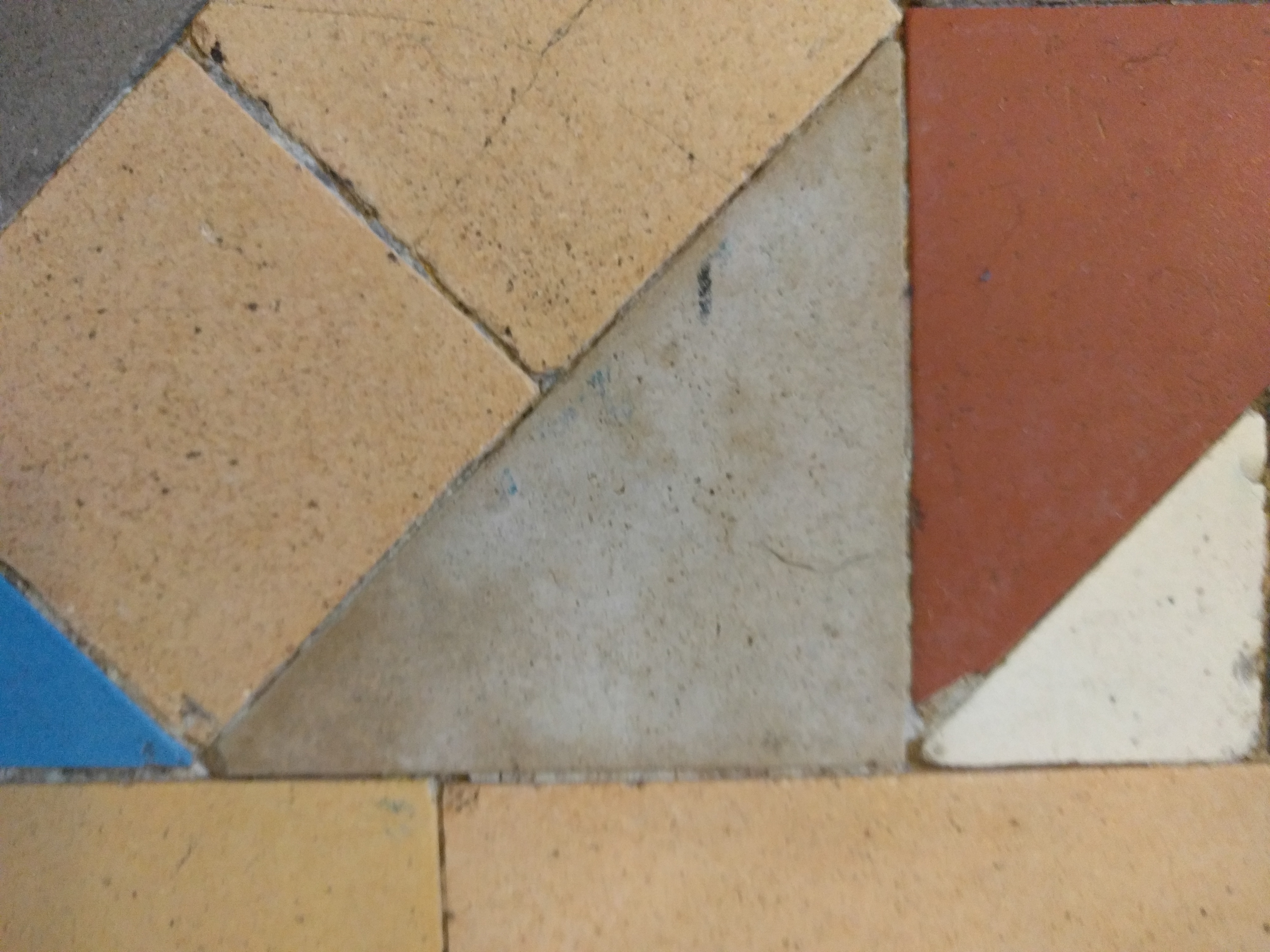

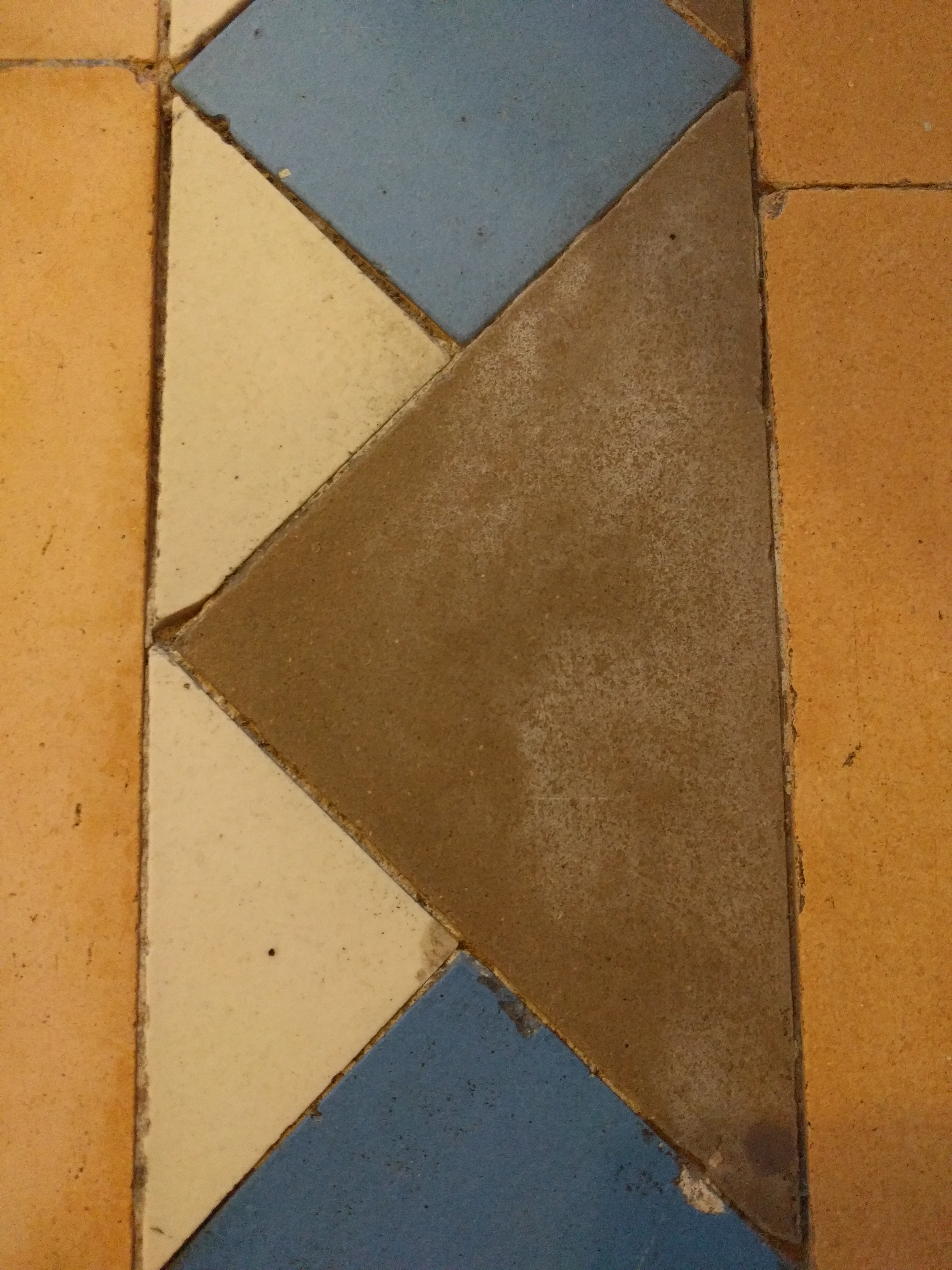

Belated thanks for your advice everyone! I'm attaching some photos incase that helps identify the problem. To clarify, the floor was recently restored - so some tiles were replaced and grouted but only some - then the whole floor was washed and buffed in an acid bath but not sealed (as the whole job was running over time before Christmas ). The white patching is sporadic and I can't see a direct correlation with any that were grouted. I'm going to try the water and light buffing by hand. I also happen to have a product called Lithofin power clean if any of our residents think that would help? If anyone has any more suggestions now you've seen the photos I'd love to hear them!
14844066320792049895681.jpg 14844066724921845136402.jpg 14844066922581188476267.jpg 1484406707579865046167.jpg
I think the acid has slightly bleached the tiles. You could put a 50/50 mix of white spirit/boiled linseed oil on the affected tiles and return the colour . Try on a less obvious area first and make sure it's rubbed well in and none allowed to remain on surface after 10 mins.
On picture 1 - why the full half tile on the restoration and not quarter pieces.
Was it a professional restoration?
