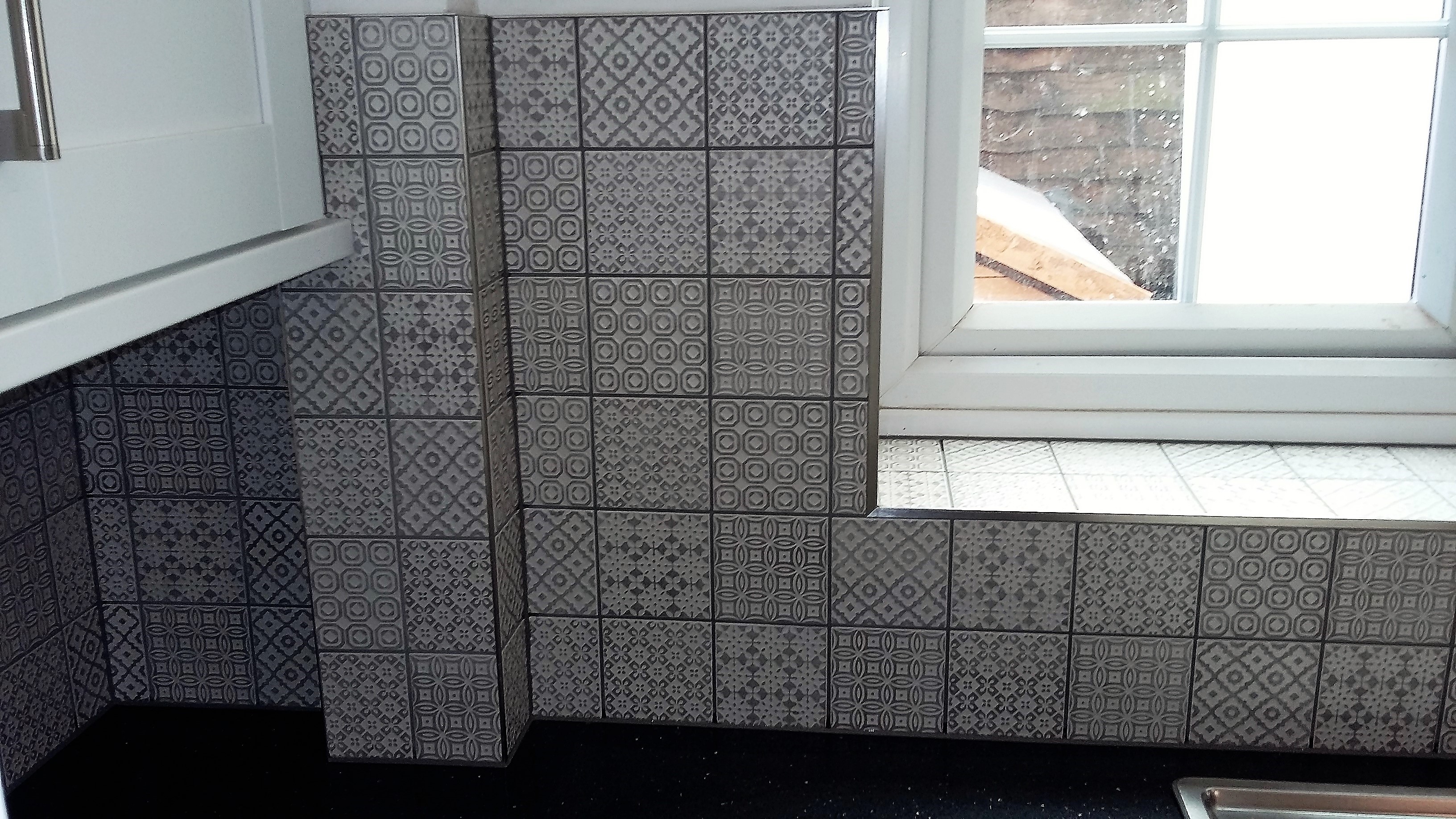

FD199145-1764-4FBF-8B40-25C8A5F1DCA1.png @Andy Allen - I know exactly what random means and those are not ‘random’ - without forethought or attention .
But that’s not the issue - those corners defy logic - to turn out work like that is akin to DIY.
Over 4-5 tiles on a splash back your customers can hide it as with the bottle of wine. But show us your fully tiled bathroom walls with this careless setting out.

So how would you set it out then John?
4 inch tiles, that wall being the main focal point as it’s part of the range cooker over mantle.
The cuts you see are over half a tile, the other tiles are full tiles as the mantle was built to accommodate them and the grout joints.

View attachment 104833 @Andy Allen - I know exactly what random means and those are not ‘random’ - without forethought or attention .
Sorry john, but I'm going to have to disagree with you on this.
And as there is no ' god of tiling ' hand book, stating exactly how this should be done, then it's all just your opinion.
And opinions are like arseholes, everybody's got one ! :)
And my opinion is, I don't like it wrapped round, I prefer to see it random, on this particular tile.
@Andy Allen - I haven’t and I won’t ‘disagree ‘ with any of your posts as it all about doing it correct and a Tiler should know this. The others aren’t worth the effort.
I’d be embarrassed to show those corners and it’s typical of a pretender to our trade to believe that it’s the correct way of doing it and advising a DIYer to copy it as an acceptable way to set out a project.
I’am still waiting for 1 of you 4 who repeatedly disagree to show your method in a full bathroom setting.
You say it’s not a written rule. I doubt if any of you have done a tiling apprenticeship in which case you’d all know how to set out a room.
If you read the OP opening post he’s telling you the correct way because that’s what he believes should happen - then you get these ‘tilers’ pictures showing him DIY blunders! It’s a pattern tile - you follow the pattern round the corner - no wonder our trade fights to gain credibility.

I quite like the random look, it suits the tile after all. I personally would probably match it. Is it wrong?...no. Would I do it that way in a customer's house?...quite possibly yes depending on the customers wishes. I've been asked to do far far worse!
Just showed Mrs Plan Tec and she prefers the random look. Just showed the cat and he started licking himself.
Horses for courses I say!
