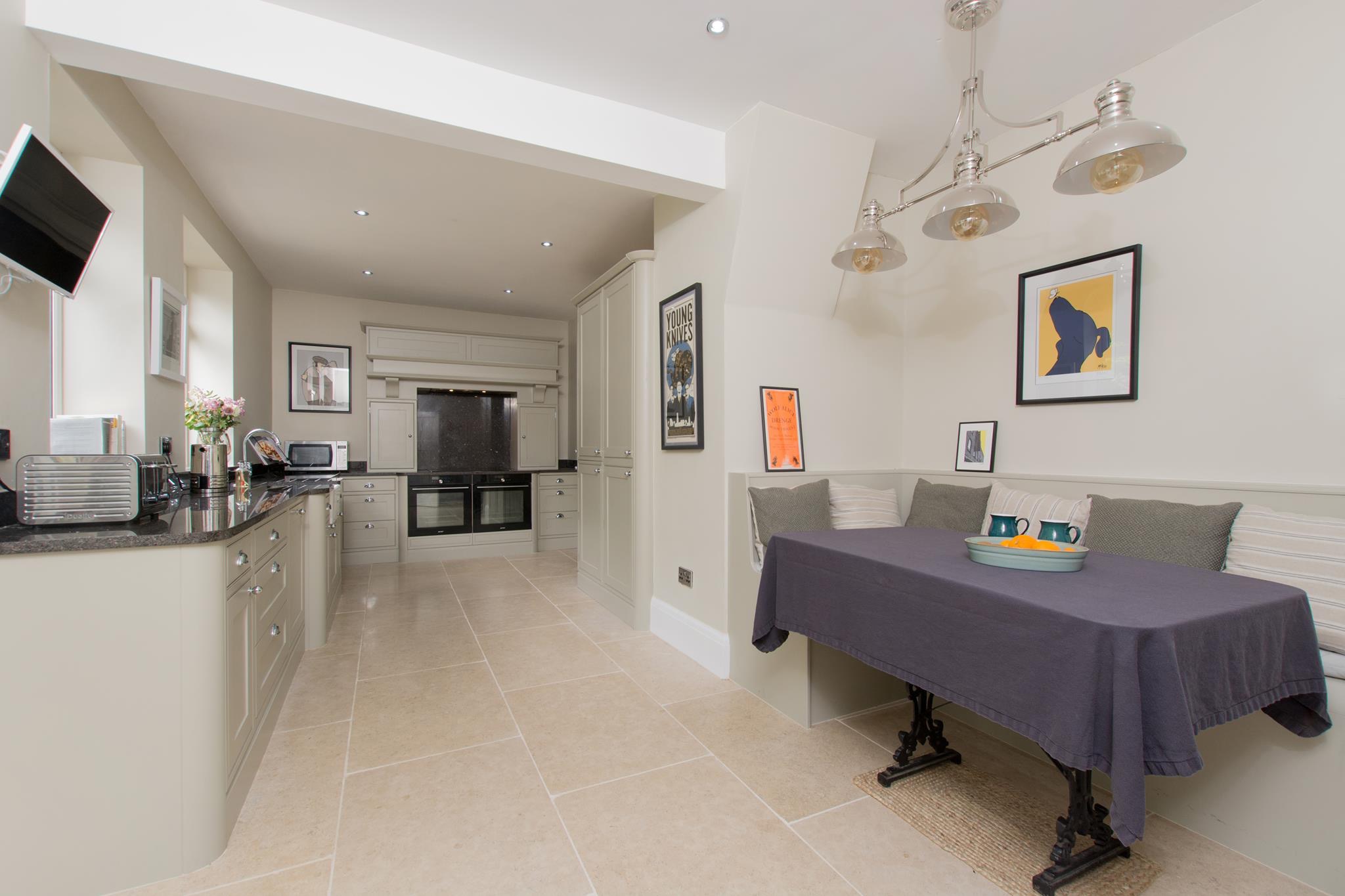

I've laid some tiles which sound like the ones you describe, It's very heavy work, and I would expect a price to be probably double what you would expect to pay for some one to fit porcelain tiles.
Here's my one, are they similar ?
