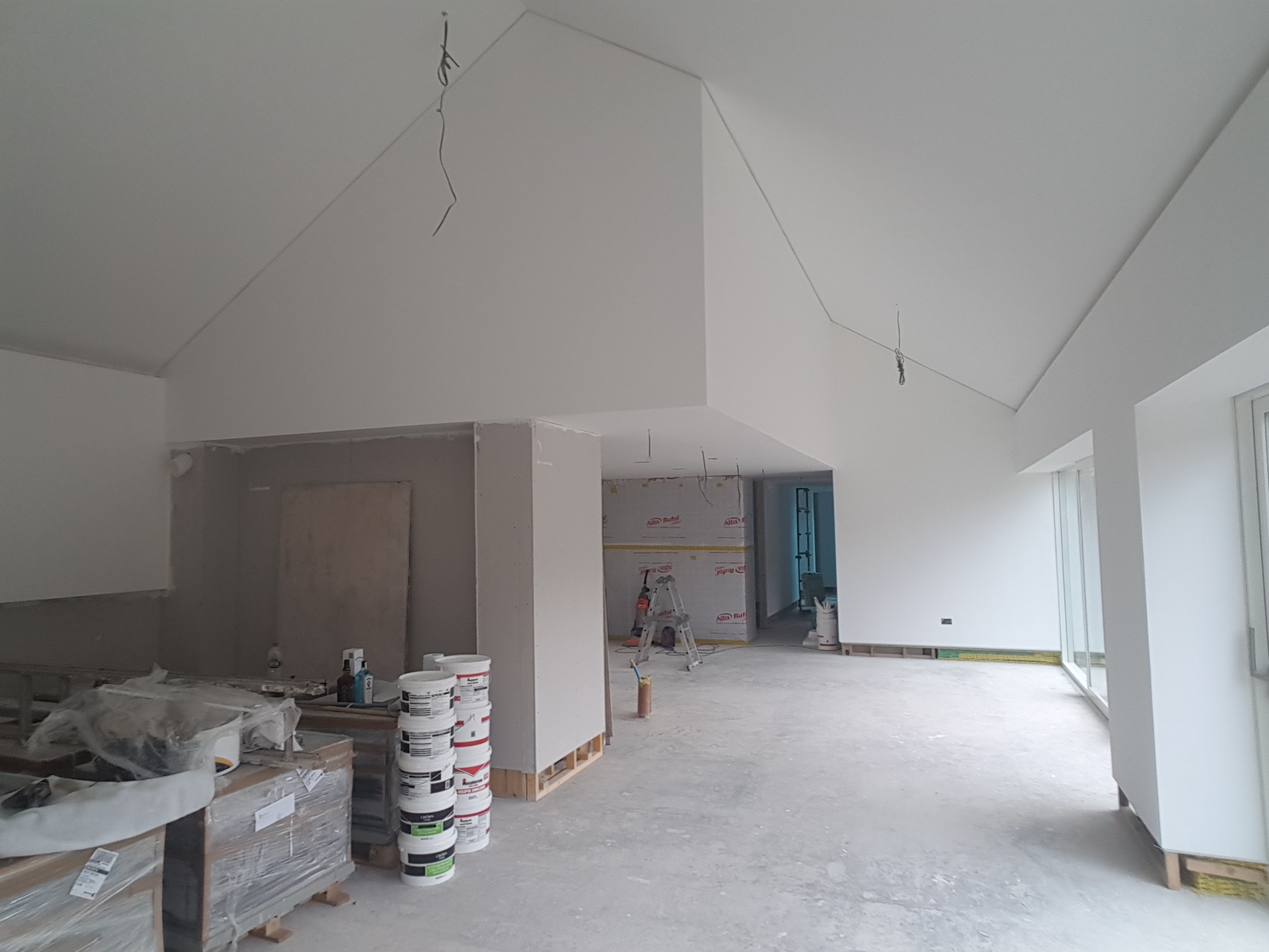

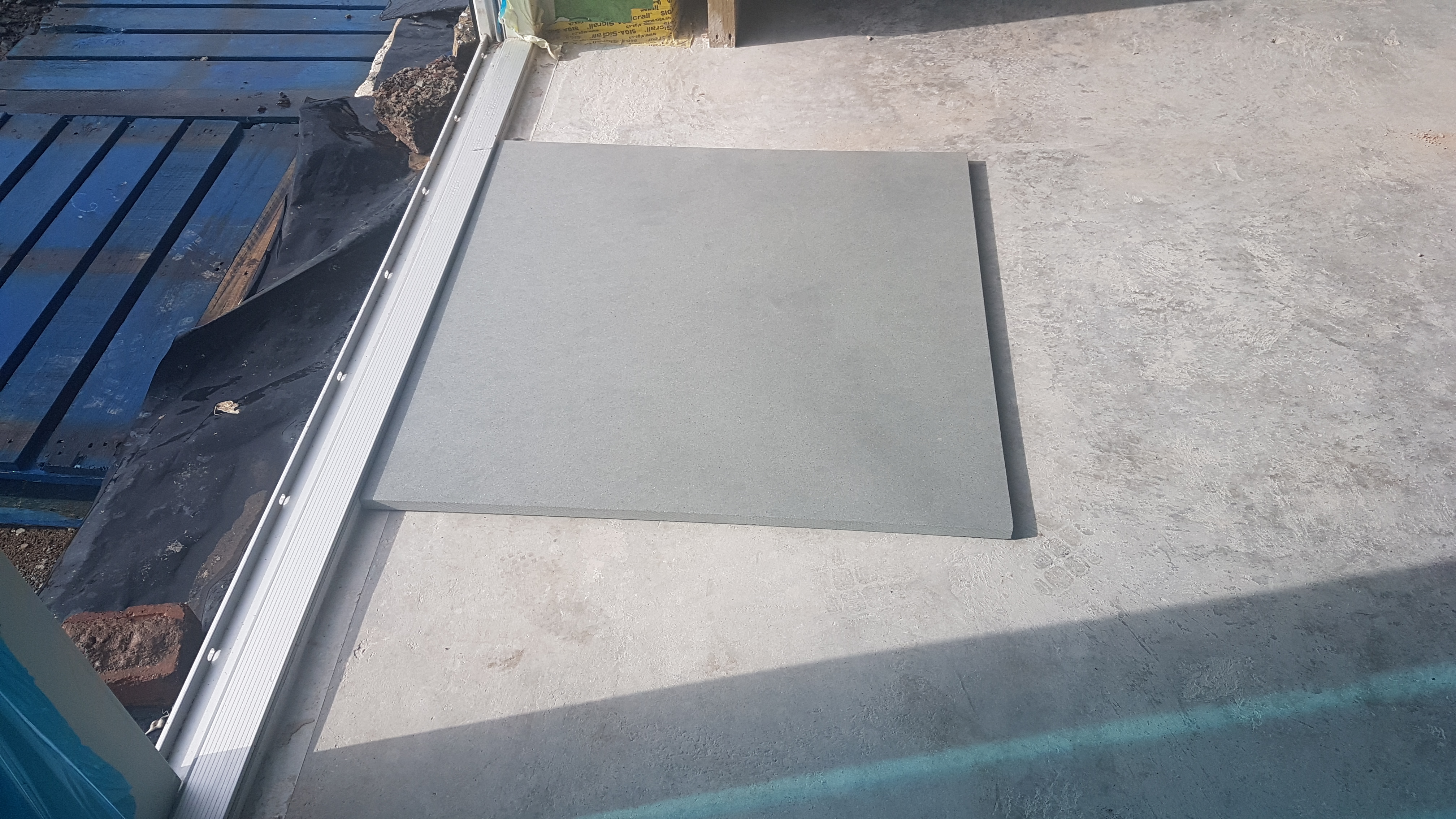

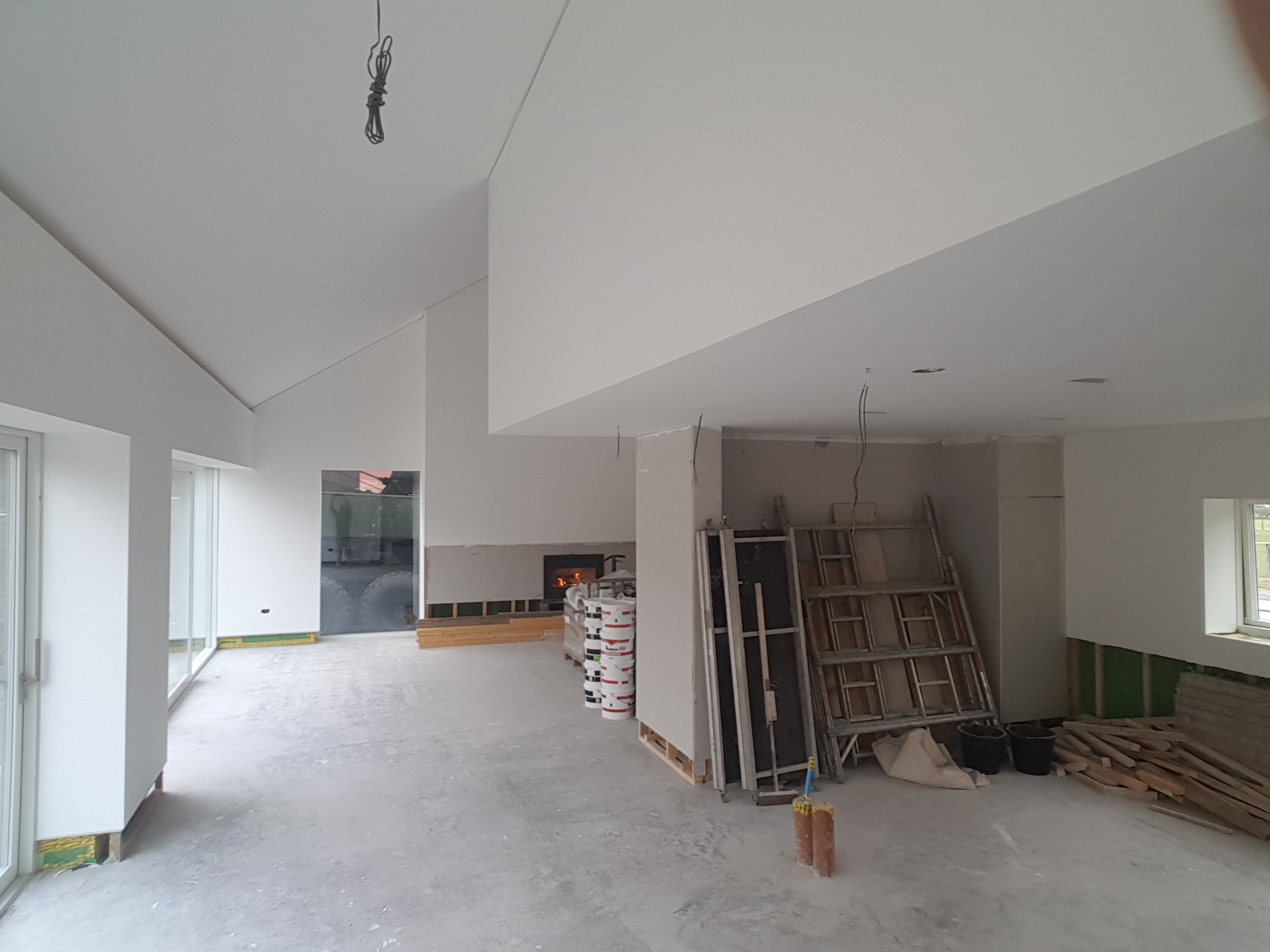

Stuart_AC
Thought a picture or two of the space might add some interest to the thread
