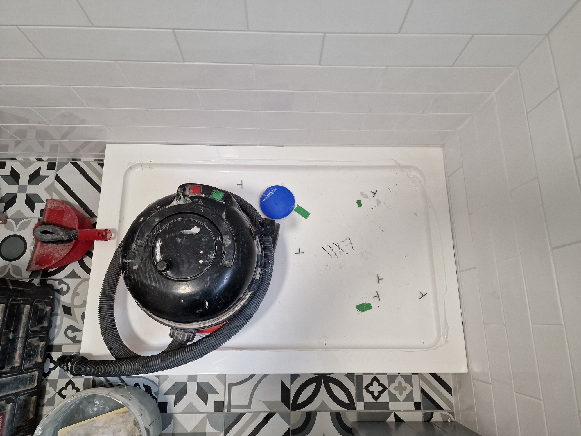

We requested the first few courses of tiles to be removed to fit the tray in place, as the tiles were already installed; this unfortunately wasn't done, and was simply butted up to the existing tiled wall, with a noticeable gap on one end as the wall isn't square (fig. 1); a liberal bead of white silicone was installed, and has remained ok since. The job was finished, and we were fairly happy with the end result, however I still had concerns regarding the potential for a leak with movement of the tray.

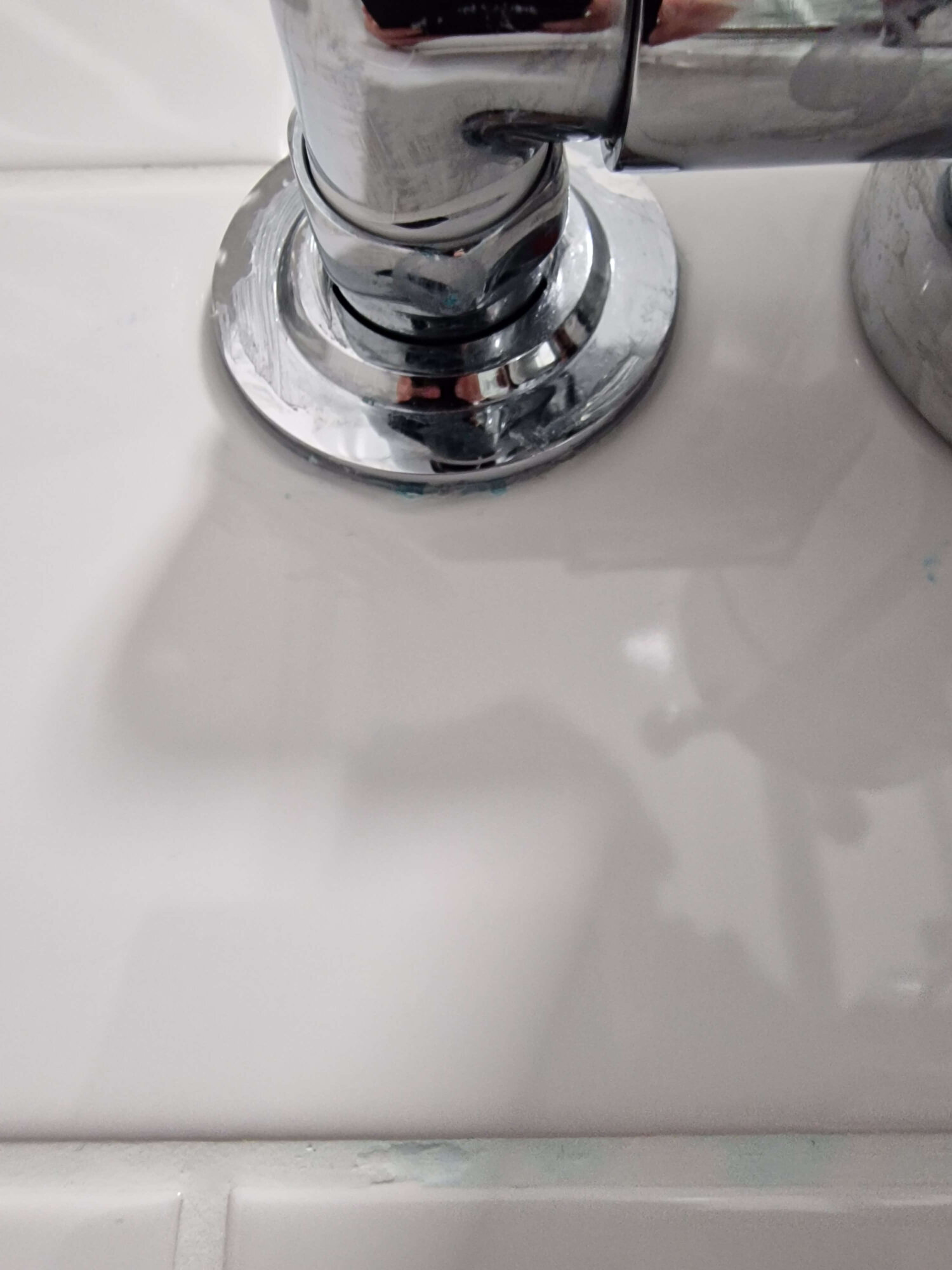

Issues started to unfold in the coming weeks, and months. Firstly, we noticed teal/green patches of discolouration on the grout, all fairly proximal to the copper pipes feeding the shower, as well as around the valve plate(fig. 2-3); this plate covering the pipe connection was initially loose, and a plumber doing a separate job, silicone sealed this. I am thinking that water penetrated here, and caused the copper pipes to become in contact with moisture, hence the discolouration.

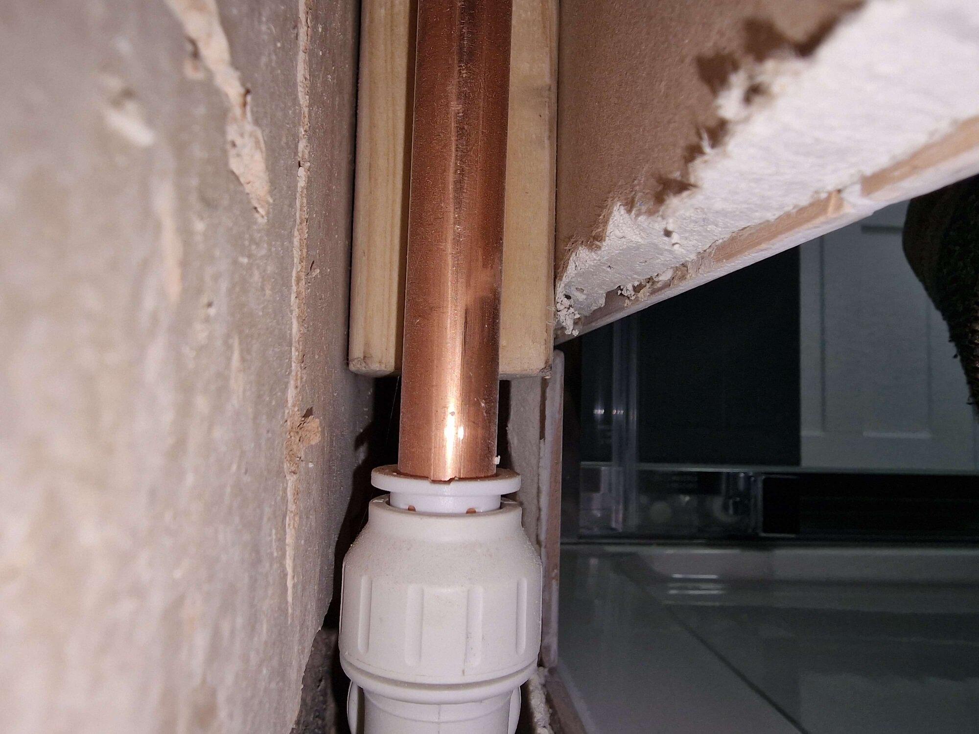

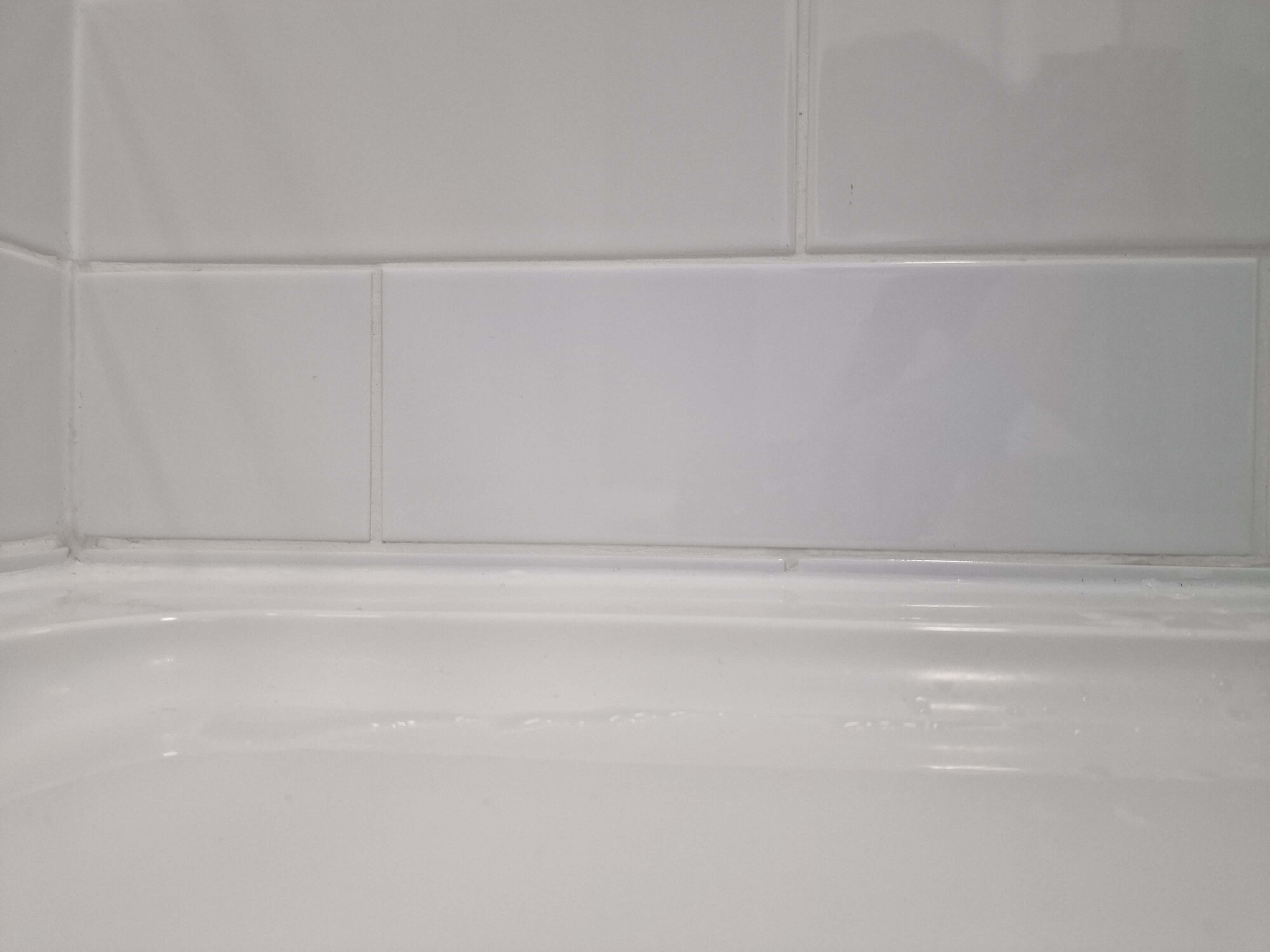

The second issue we noticed recently is that the grout has started to crumble, and come away, most noticeable in the first course closest to the tray; also, a small hairline crack on two of the tiles on the other wall. I decided to attempt to regrout this with an epoxy grout in the first instance to remedy this, and replace the cracked tiles, of which were three; this therein lies to my findings that now lead me here. As I tried to remove one of the cracked tiles, it took a whole chunk of what appeared to be gypsum plasterboard with it (fig. 5). Not really what I wanted to see, as this is obviously not waterproof, and did not seem to be tanked in any way. The plasterboards are screwed to 35 x 60mm timber studs, which are spaced with 300 centres; There seems to be an old plaster render that seems to be coming away as seen in fig 5. The hot water pipe runs against one of the studs (fig 6), no idea is this is correct?

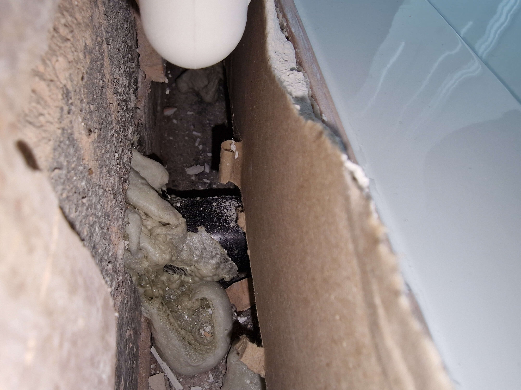

It also seems that access was made through the tiles and plaster to chase the waste pipe, therefore the plaster board only goes as far as the bottom of the tray and timber frame; we get a lot of draught from the shower waste (fig 7), not sure if this is properly insulated, doesn't look like it is!
