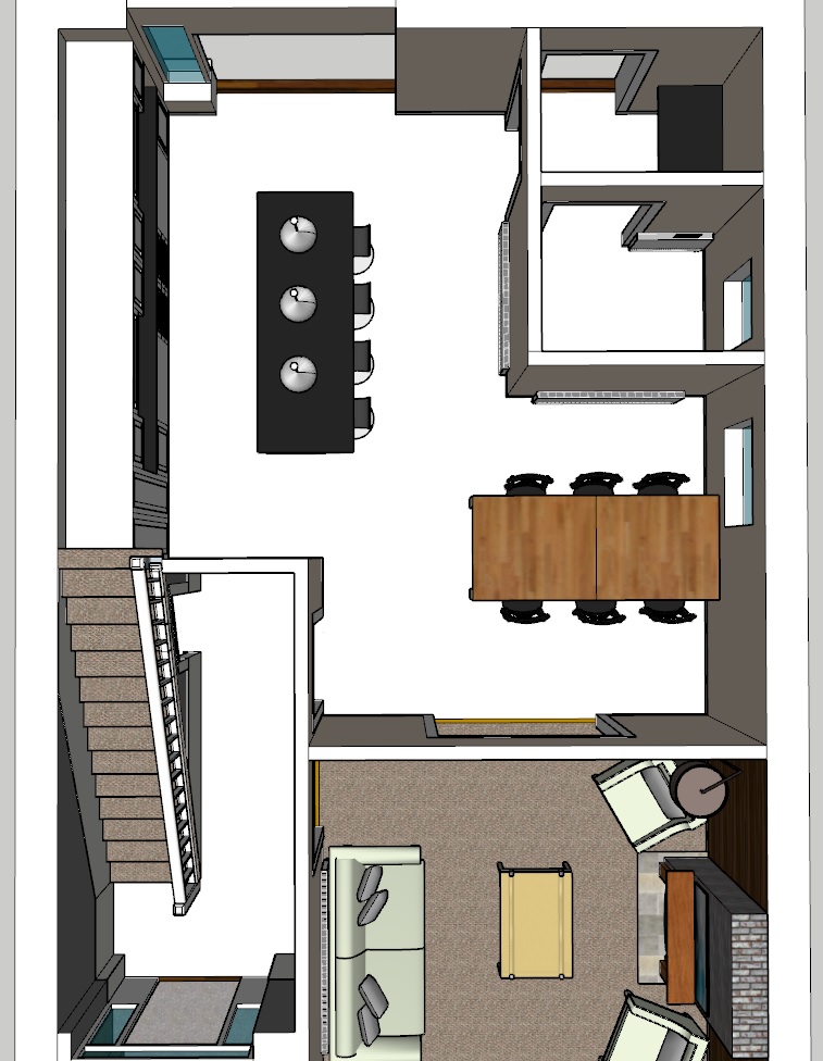

I'd want a straight line in the hall. If the kitchen isn't square to that it'll look awful when you come in the front door.
Have you got a floorplan you can post?

thank you for taking a interest in my project, please see below for a floor plan from SketchUp all the white flooring will be tile ( kitchen island will be installed after flooring)
