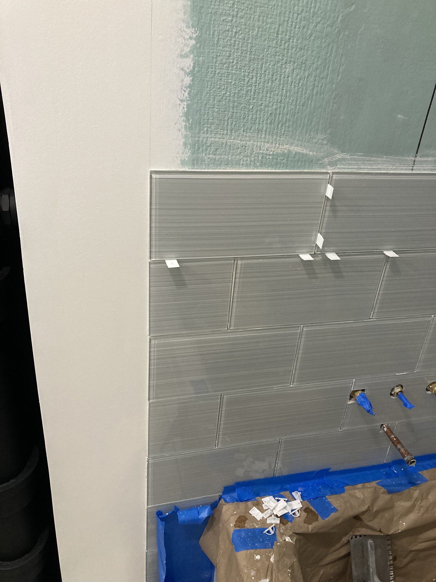

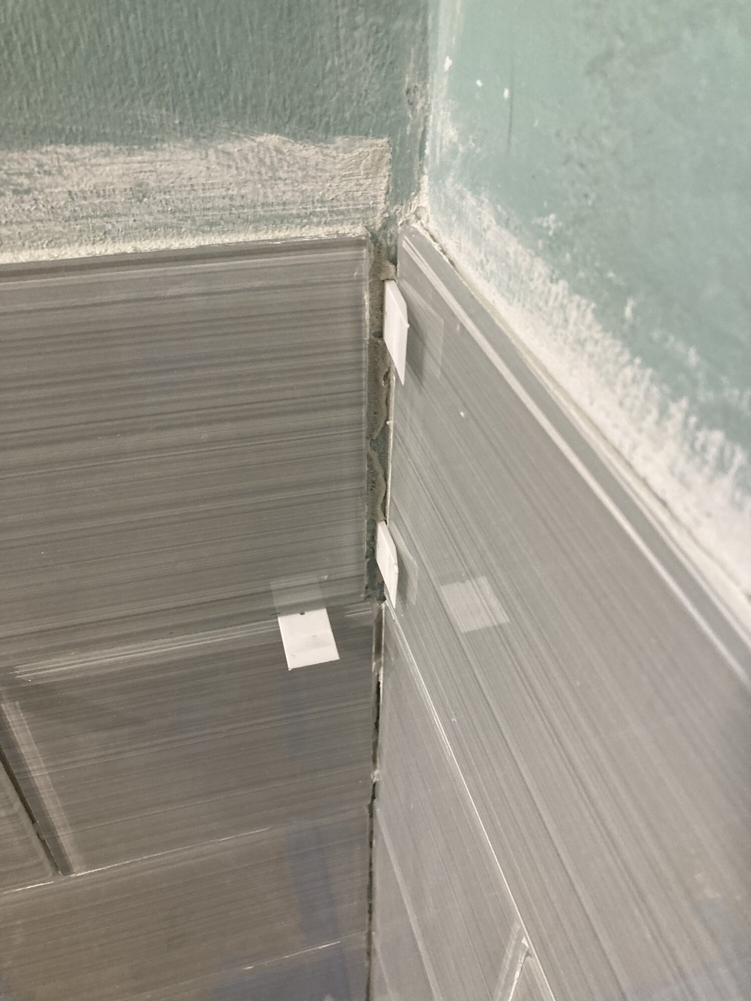

I thought I had all plum walls but missed this inside corner. Are there any suggestions on how to fix this 3/8" gap?
My ideas so far,
Option 1 to just have a 3/8" wide corner caulk line both inside corners event though issue on one corner.
Option 2 use quarter round 1/2 wide to cover gap- have some color options in route from Amazon.
Option 3 and my least favorite. Remove tiles and reset but pull apart about shower head wall 1/16" wider than the 1/8" I have going. I tried this before it was set and seemed like it was noticeable. But maybe after grout it would have blended ok. Then use thinset to level then continue tiling back to where I was & complete. This option has more labor, removing tiles and hoping I don't create a new issue with lipping where replaced tiles on back wall meet replaced tiles after I level.
