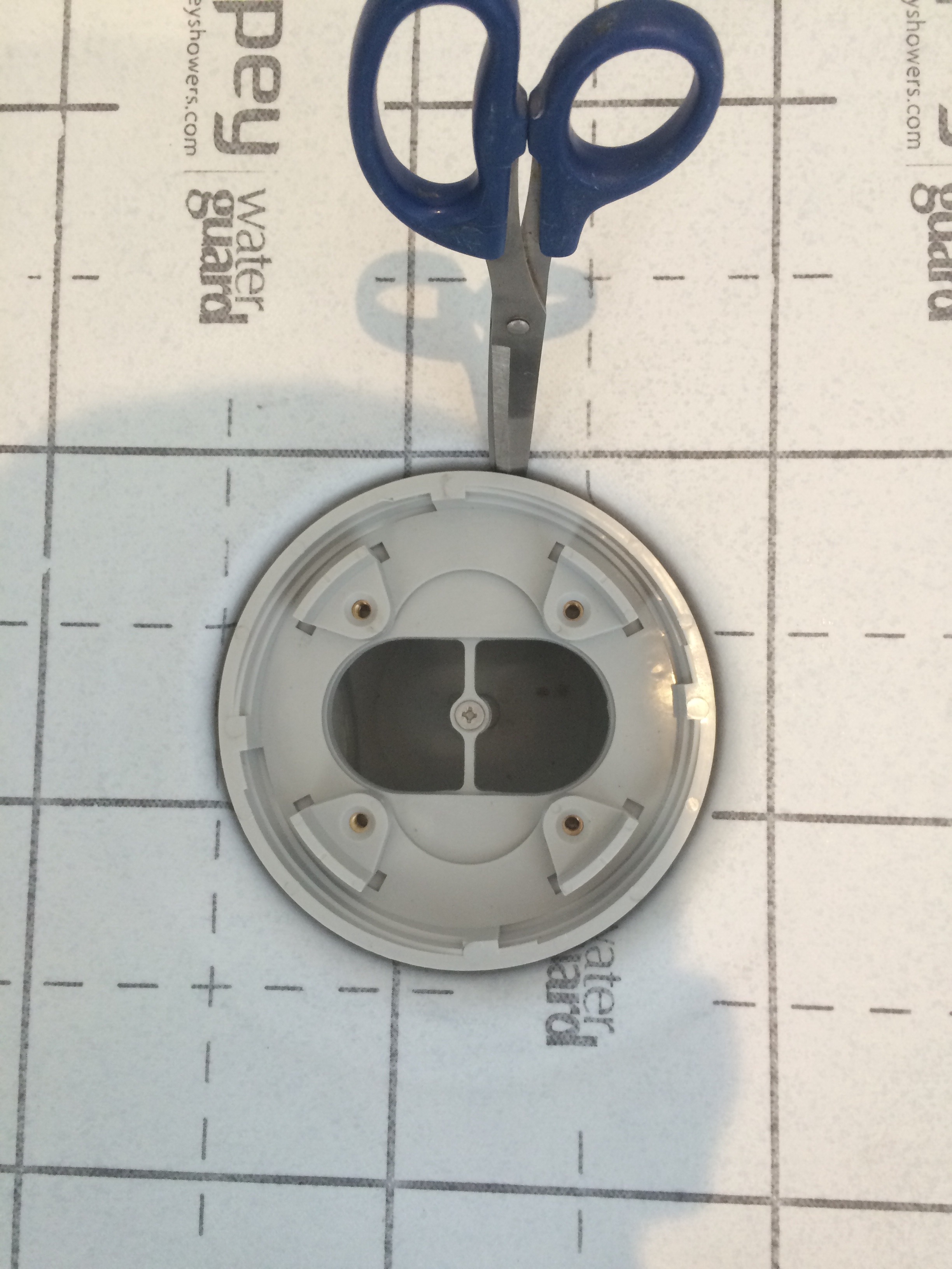

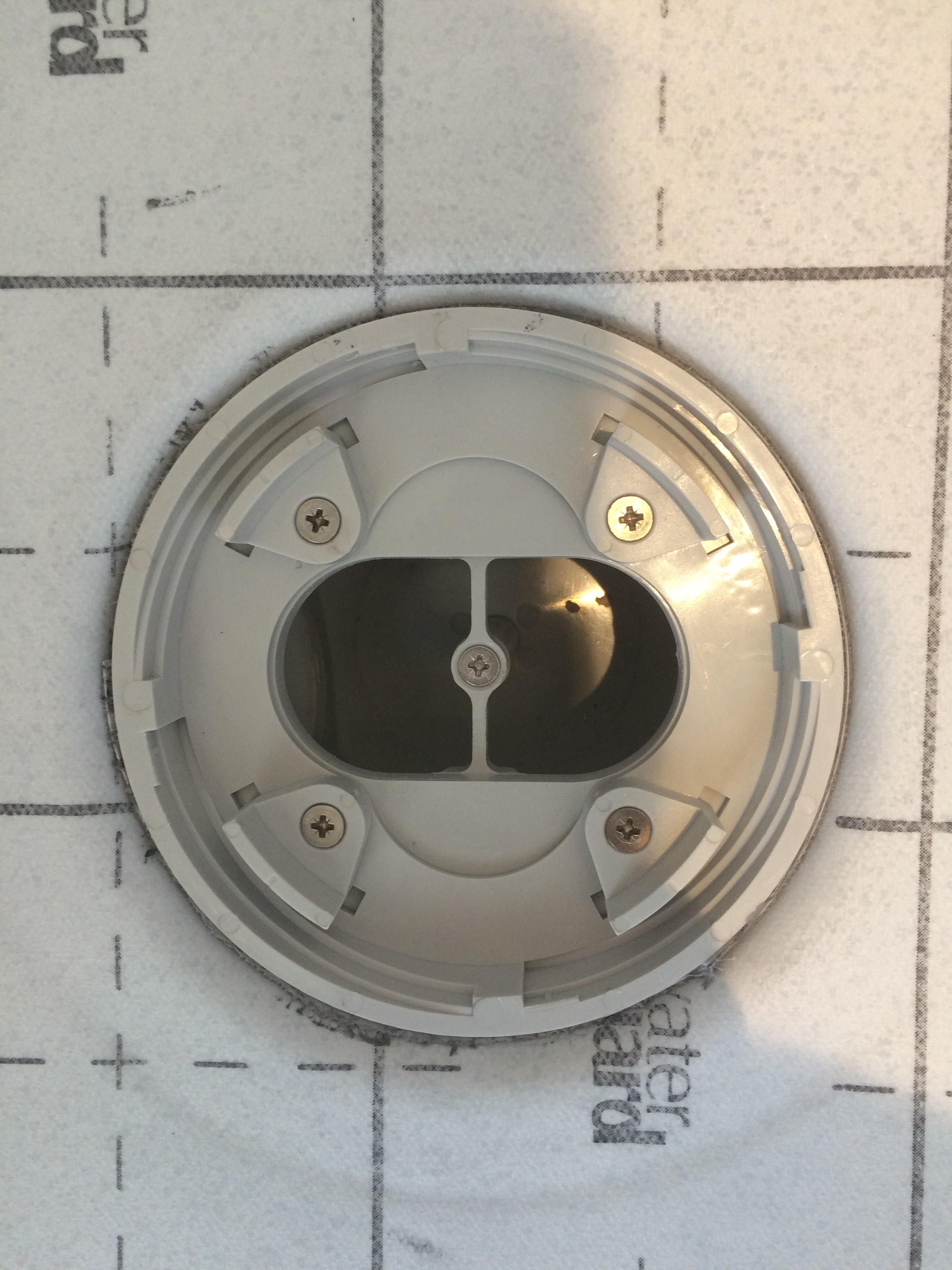

Hi,
Having consulted the technical team we advise that when putting the jointing compound on, its best to put a 2/3mm bead along the exposed edge and rub in with a gloved finger. Please see pics.
