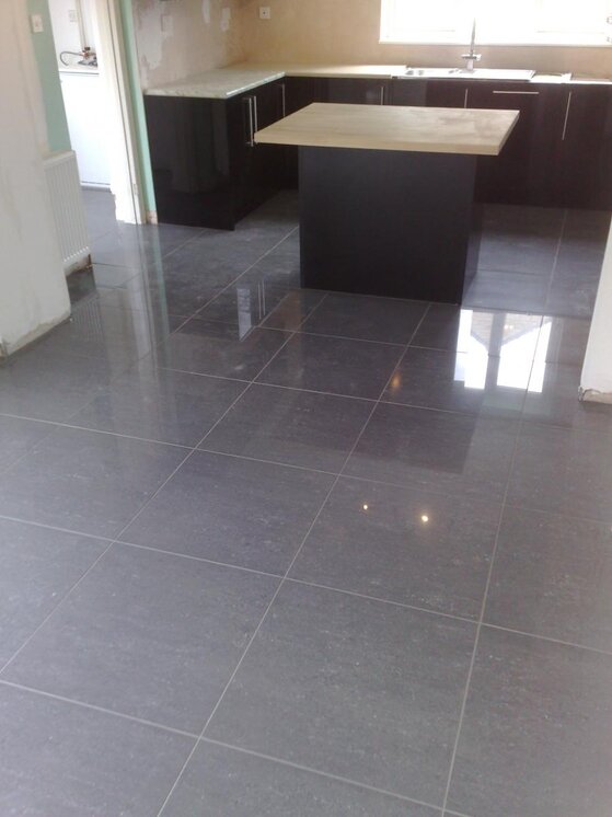

i done this a couple of weeks ago with 4mm grout lines
Make sure your substrate is super flat :thumbsup: will make laying these tiles so much easier.
Good luck & post a pic when your done
