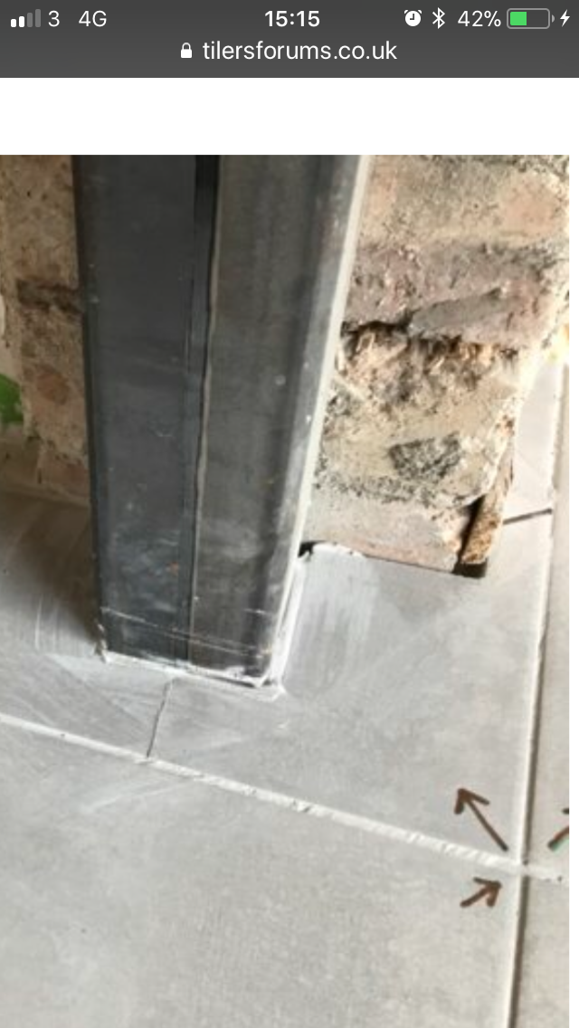

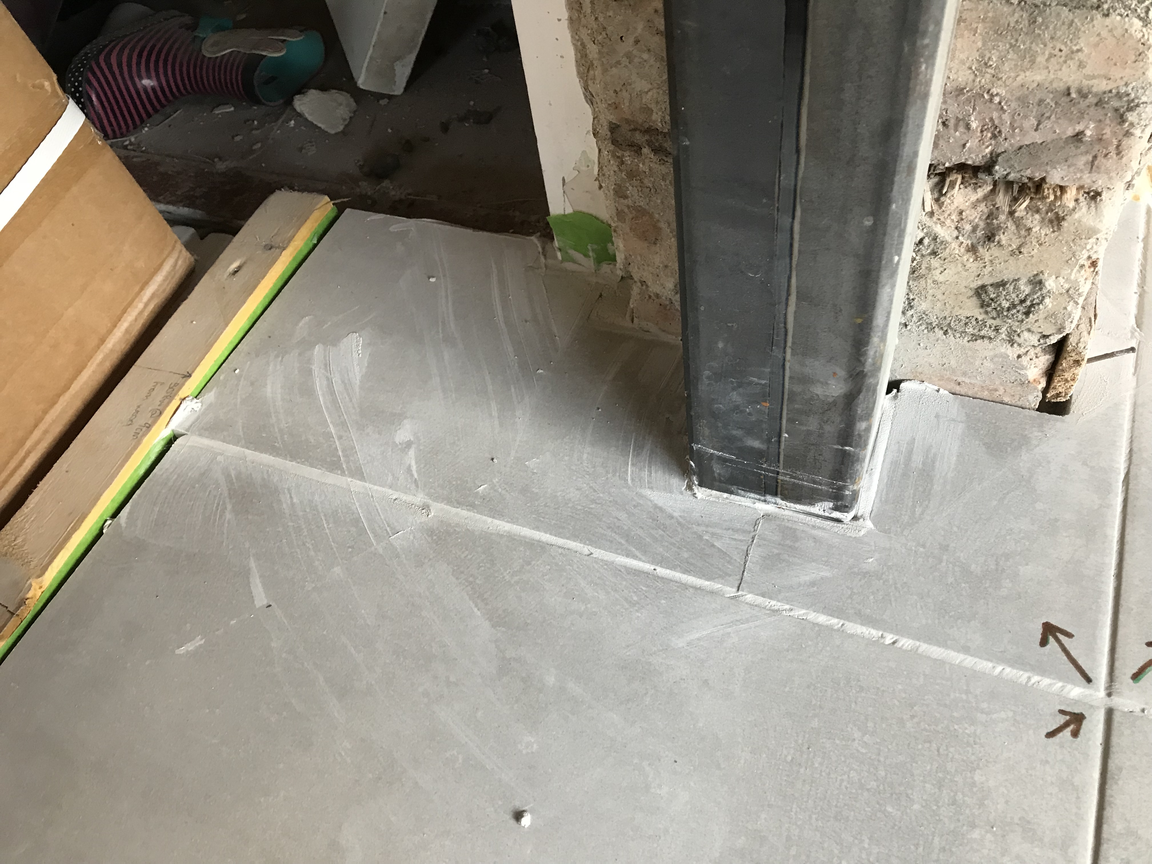

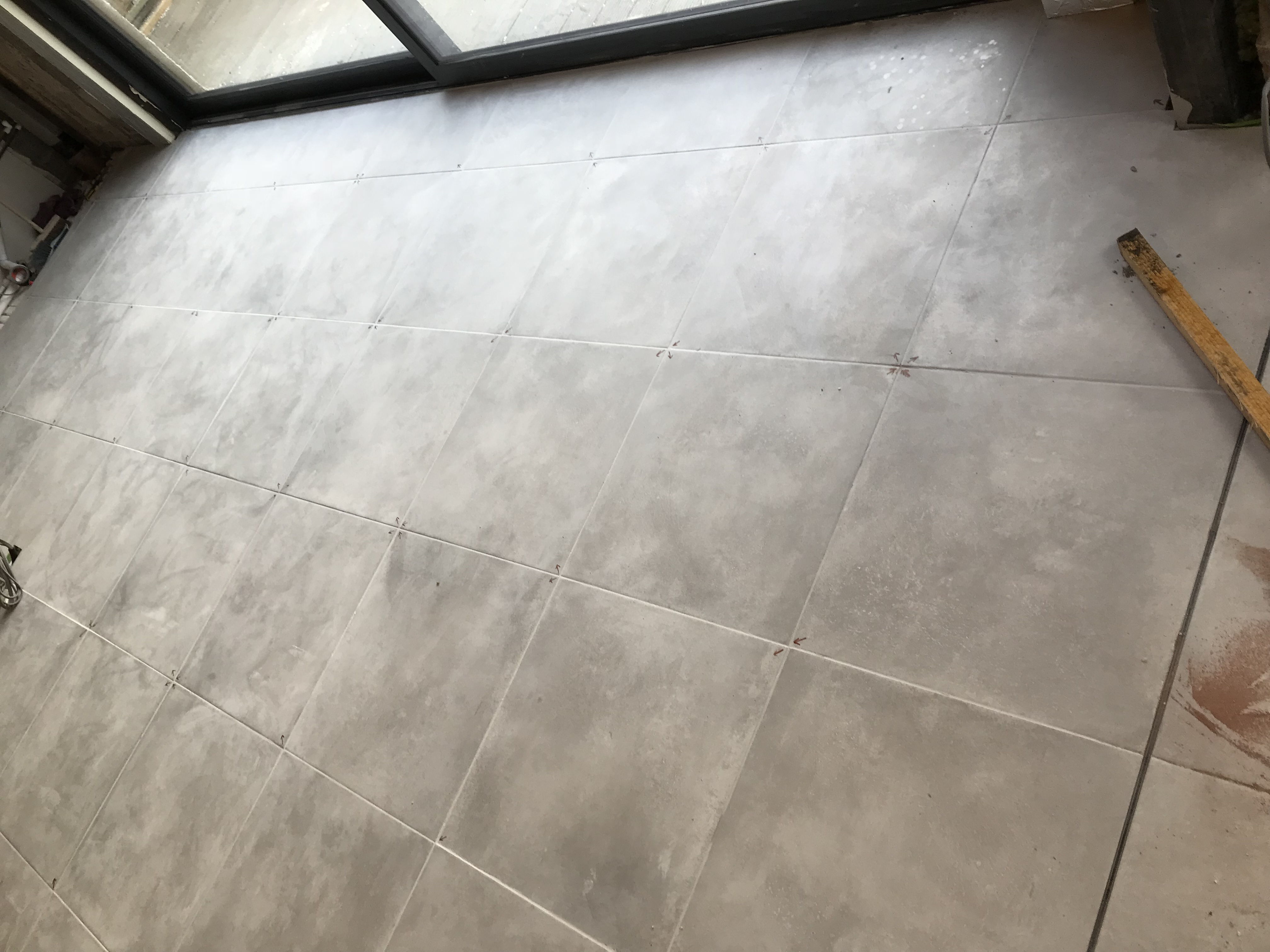

Acceptable lippage in large format floor tiles

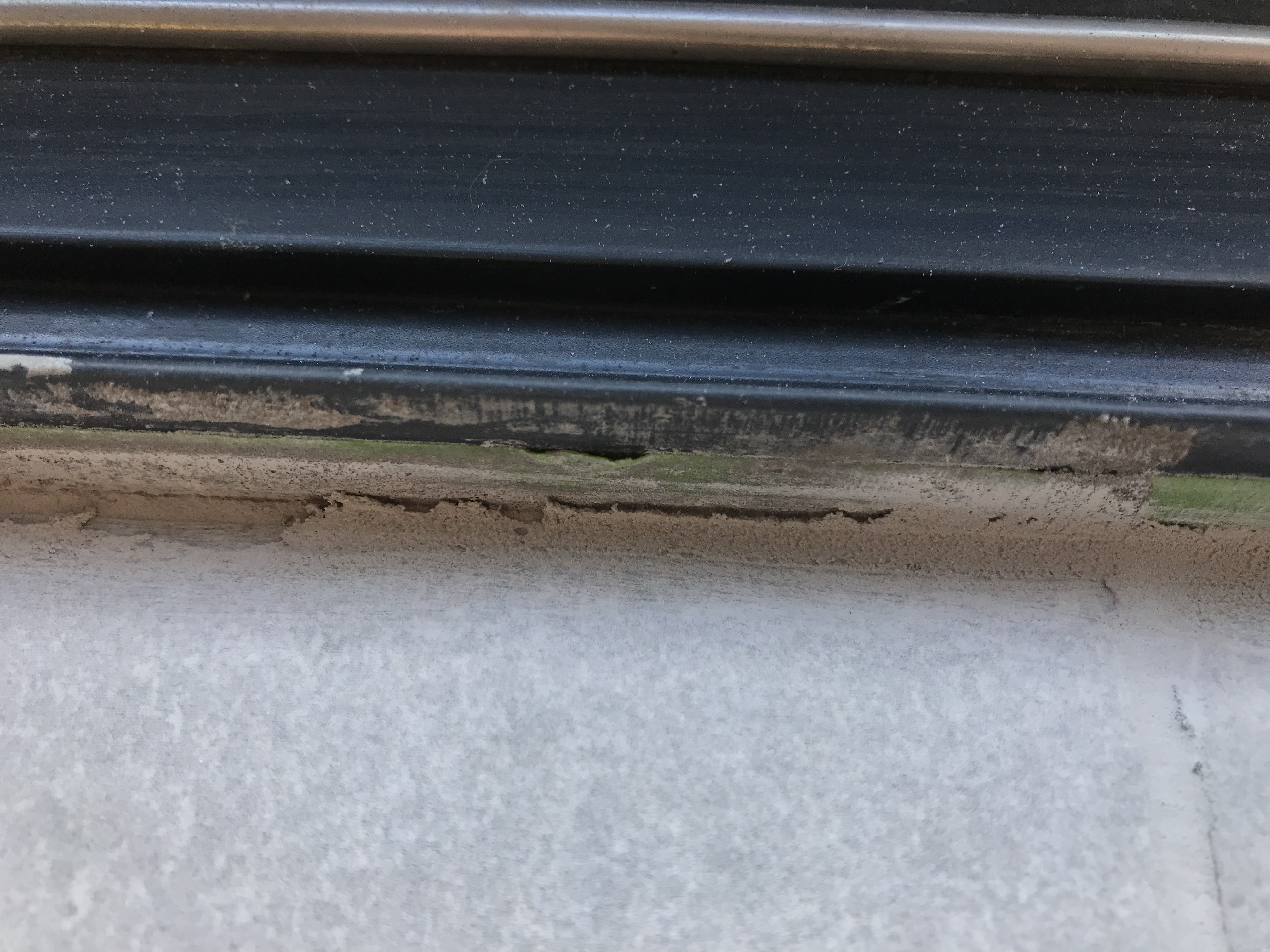

Also photos of the extent of the problem. Not a single tile level with the next
7DC5ADA7-77AD-42D1-9BD5-38A9691B9A0C.jpeg 44EF59E9-76BE-464C-8728-BD16C3817073.jpeg
If that is what your tiler calls acceptable and within his personal parameters of quality then I do not think he will attempt to resolve your issues and best outcome would be to get all monies paid to him refunded, IMO best to rip up and start again with replacement tiles, not good but will never be or look right so take the hit now and move on, feel for you.

The other tiler came out and was appalled at what he saw. He’s suggested raking out the grout and putting in a darker colour to try and hide the shadowing from the lippage. He’s also suggested smashing out some of the extremely poor tiles in the areas that will see the most traffic, since these will bother us the most, which is sensible advice. Finally he’s given advice on how to take this further in terms of a claim.

I have read through all of this and tried to make my opinion as objective as possible....YES the floor could've been tricky once he started, YES cheap tiles can bow, and the differential already mentioned would suggest this as a possibility....but the standard of the finished floor is miles away from being to an acceptable standard (this doesn't help you much at this stage I know!) and the state of the grouting is amateurish at best, and I mean at best! Throw into the mix tiles with 3 breaks in them.....there is no where to hide for our man.

Ok, from the new pictures you have posted, its quite clear that despite the tiles having a slight bow and dodgy corners, this tiling has been done to a poor standard so I guess you give him the opportunity to rip it up and re-do or give you a full refund for the works done. If you go down the small claims road, you will have to show that you gave him a chance to put it right but I have to say there is a fair chance he'd do it to the same standard again! Must of been a bit awkward calling the original tiler back after he didn't get the job because of the price? I wish you the best of luck with this, not a nice situation at all.
