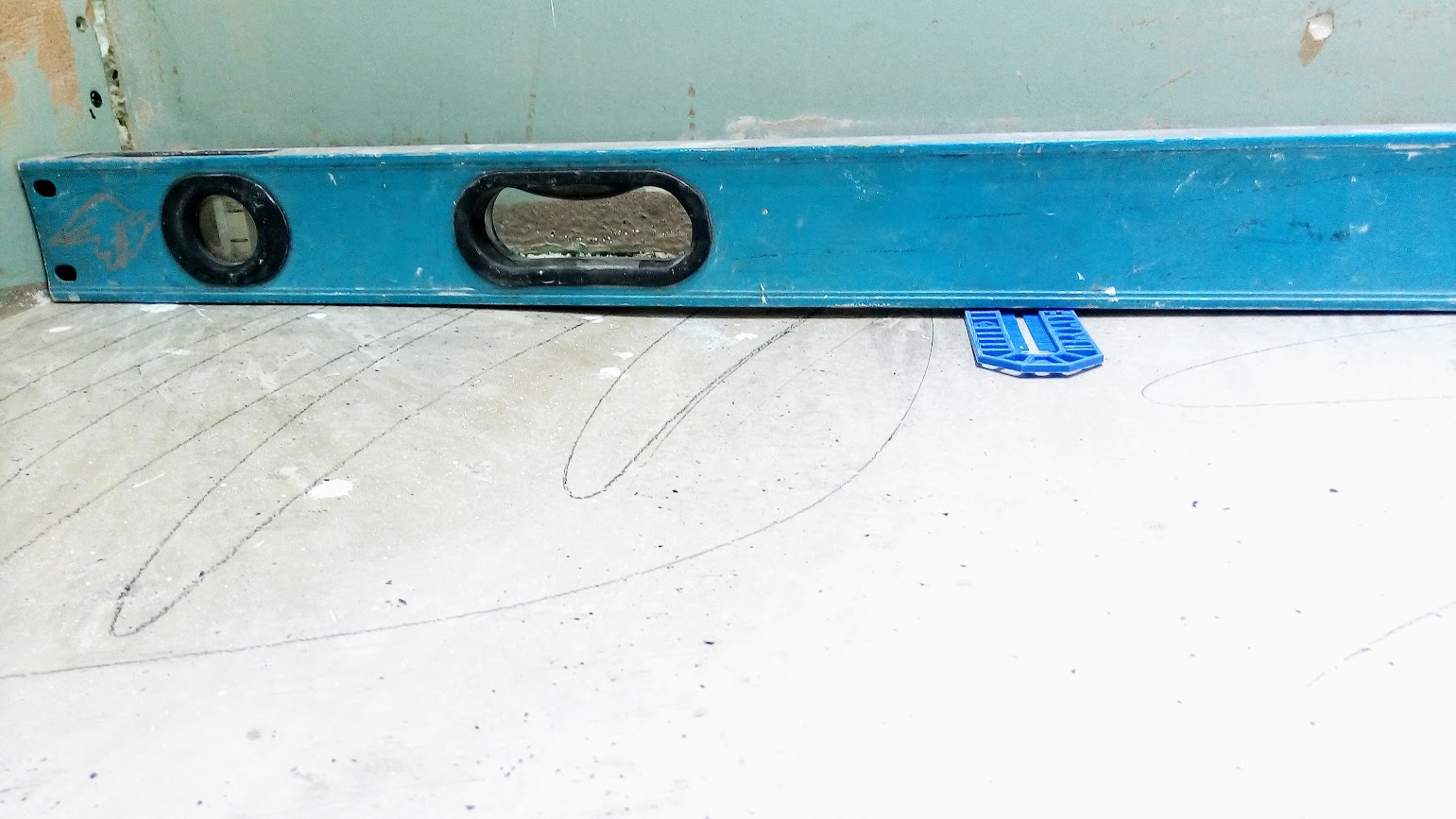

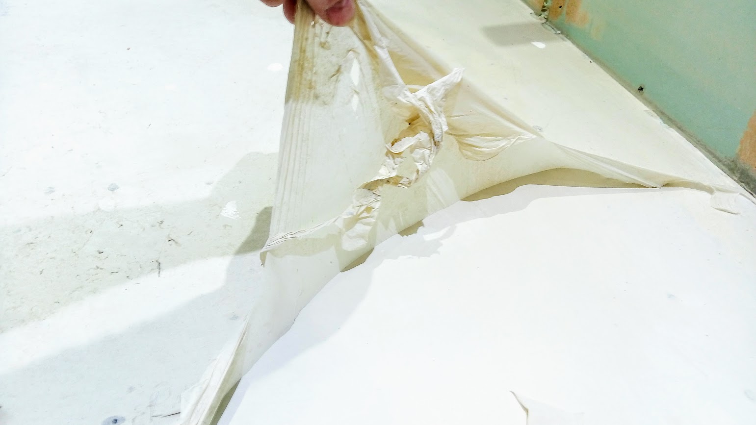

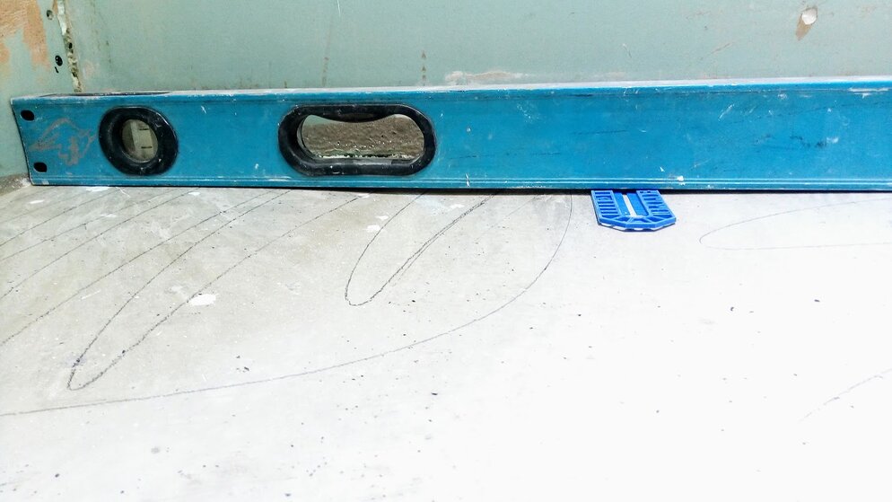

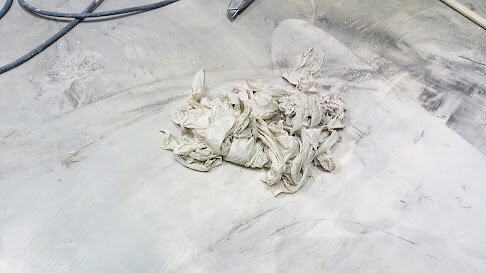

All Primer, SBR is not ok with all surfaces, for ex. some months ago I have done a job where the builders leveled up the floor with some self leveling compound. Cleaned up the surface, tried it 3 days in a row, on dry and damp surface, applied several coats of Bal primer diluted as recommended by the manufacturer, always let it cure over night, the very next day in some areas where the self leveling compound was more like gypsym dusty kind of looking, the darn primer piled off. So, I would say, never follow the manufacturer advice, do whatever you think is necessary for that particular job. I ended up recleaning the area, damp it with water, mixed the adhesive with SBR and applied the subfloor on top. Achieved a very good bonding. I do believe in the new technology, it just does not always work out as it supposed to. You always have to be a step above and use your common sense.
Some areas of the floor had to be grinded off, the primer would not pill off in those areas. See last picture where the primer penetrated the compound and would not pill off.
